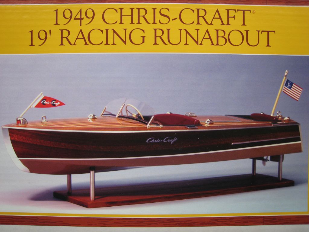

      I have read John Parker’s article on brushless motors and, as he says, it all falls apart when it comes to the actual choice of a motor!
      I would appreciate a specific recommendation for a brushless motor for the Dumas 28″ model of the Chris Craft 19″ recing runabout.
      I will be using a 7.2V NiMh battery pack and the motor is to drive a 34m twin bladed prop. If I were to go brushed, I would probably use the Graupner 600 Race 7.2V motor which I use on my Slo-mo-shun model of about the same size.
      I would like to use an in-runner motor with built in water cooling. I will use a Hobbywing Seaking ESC (I have the 60 amp version in my Bluebird) as this can be programmed for forward/reverse operation and for NiMh or Lipo cells (detailed operation instructions available on the Hobbywing web site are a definite bonus). The 35 amp version is smaller but there is plenty of room for the 60amp version if required.
      Advice as to a specific motor and source of supply would be very helpful.

                    U-tube link to the Chris Craft in action at Black Park. With its Turnigy 2000kv motor it is fast and almost silent.
