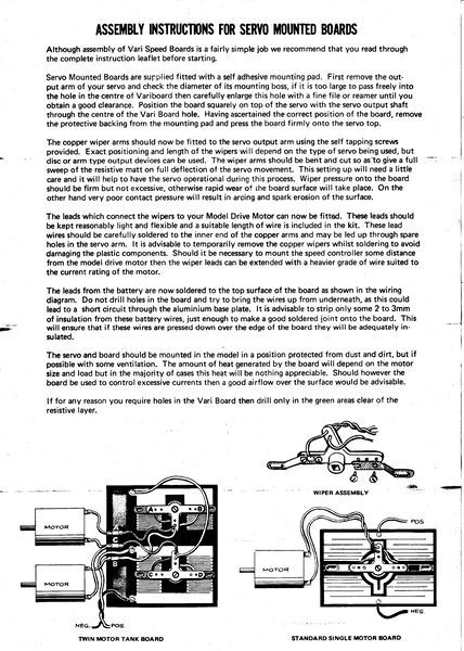

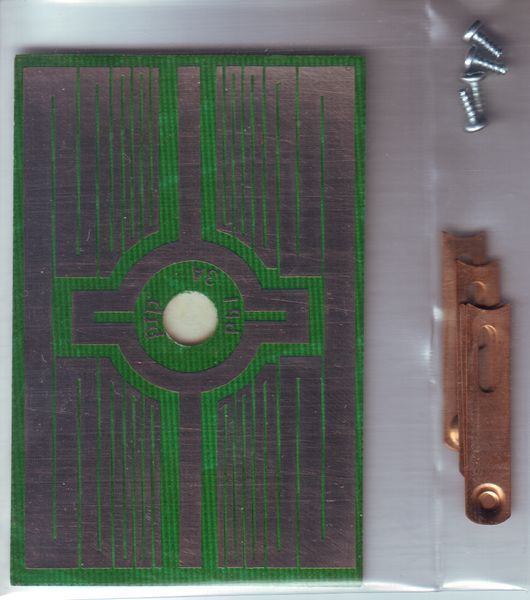

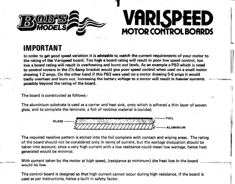

                              I hope this explains just what a Bob’s Board is Ashley.

                                Mike. Thanks fror that (and Paul) , I THOUGHT that was what they were….I am sure I have seen some with resistors in  the past,obviously not a pukka BOBs Bobs board.Ashley
