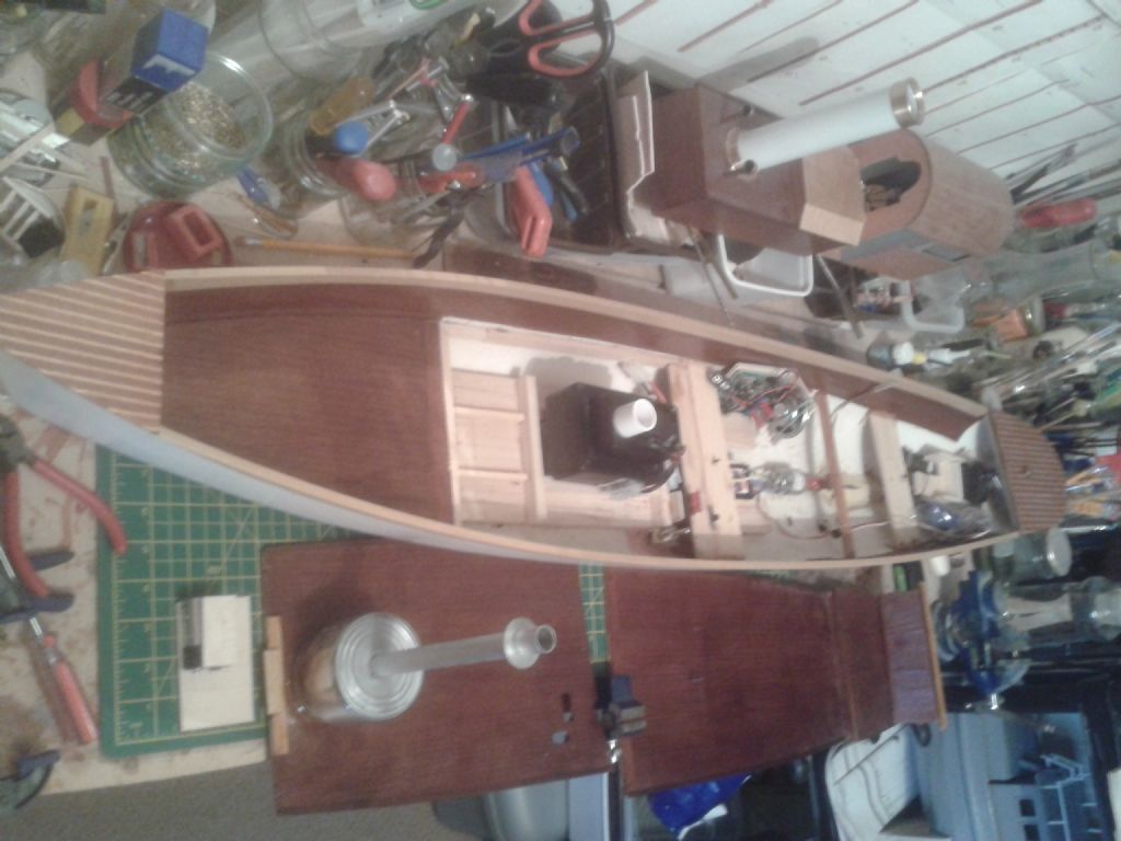

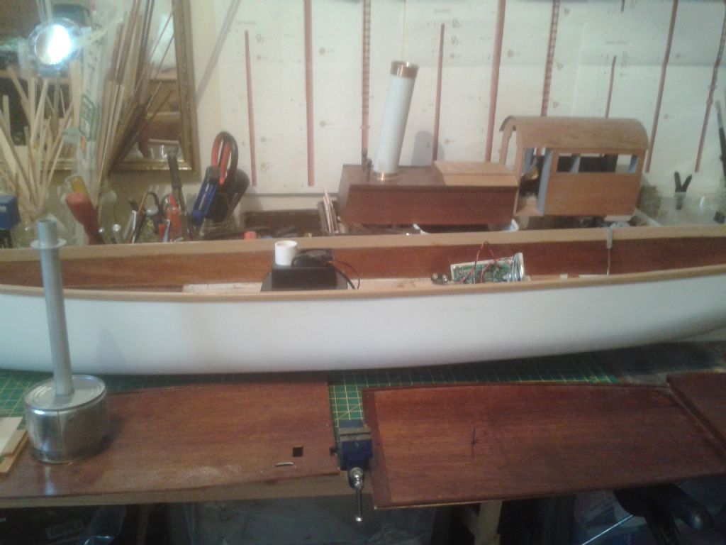

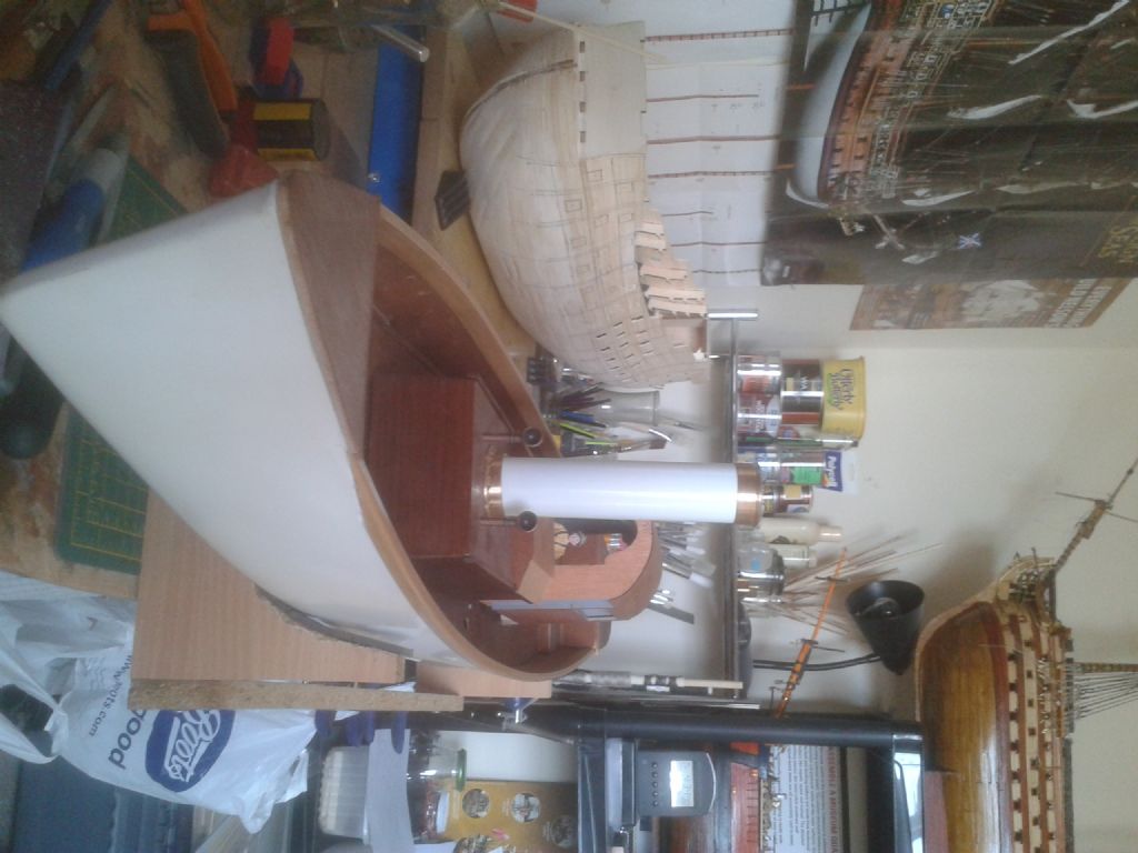

                                        I have started to strip out the Gondola to see how best to fit all the parts..
                                        #46102
                                        IAN_I
                                          @ian_i
                                          I will measure the area in the hull to see what will fit …
