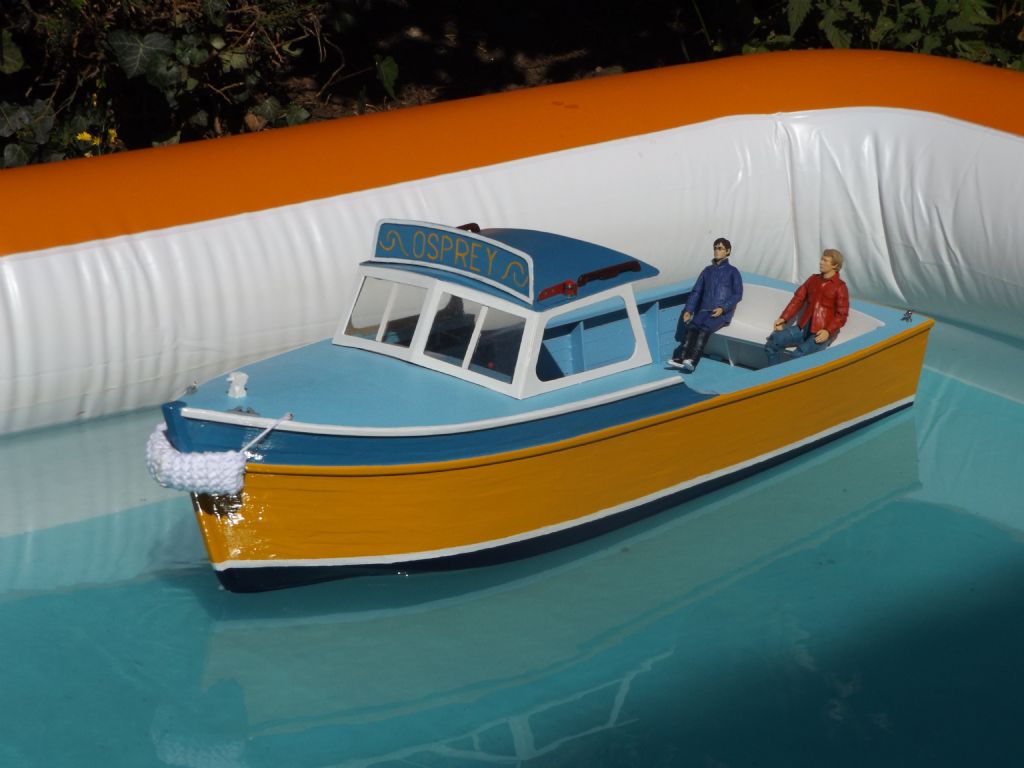

                Hi Eric,
                If you would like to message me your email address, I have the proof drawings 2 sheets as a pdf's and the article I will ping them over to you could get them printed off at a repro shop.

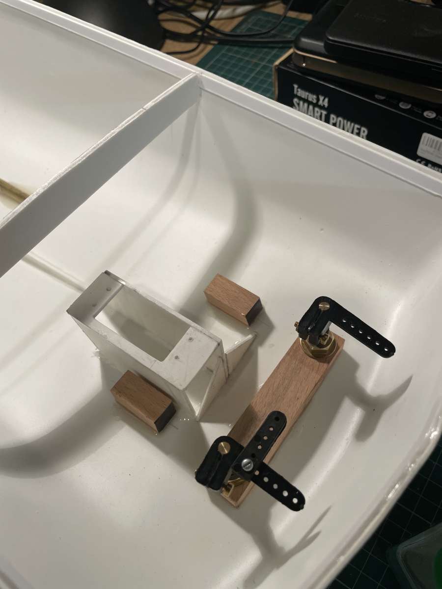

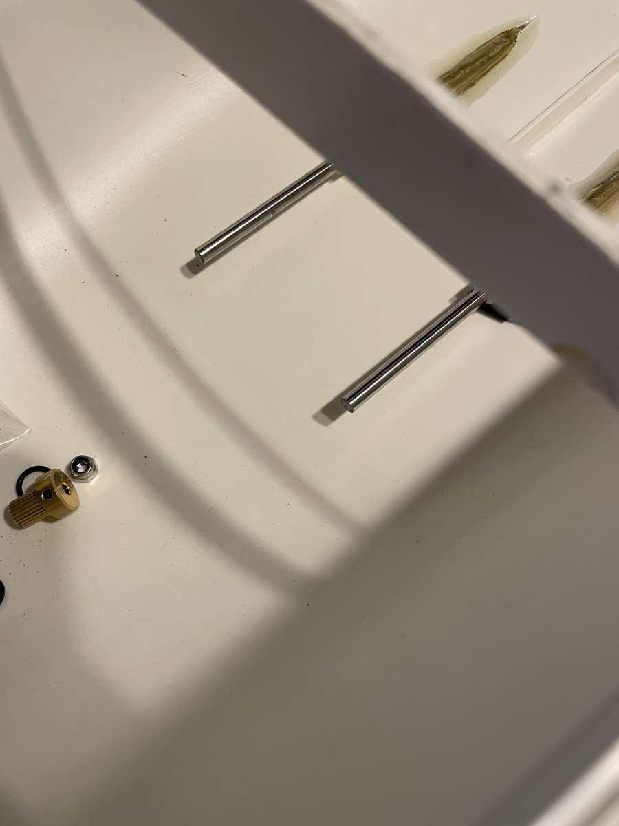

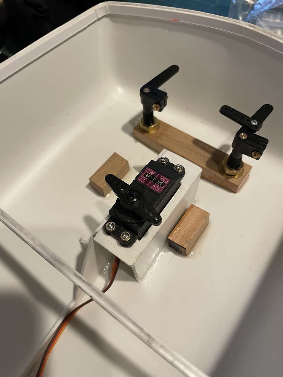

                              So progress on the pilot 40 has been slow, almost asleep! I must have been when i cut the stern tubes in. I managed to get them so shallow in the hull – with watching the outside more than the inside whilst cutting – i have not left enough room for the dives !!!!!!!!!
                              I am now going to have to put gear reduction in to get the drive to work at all.
                              So what to make? I can get a 25 tooth 0.5mod spur gear in and then run a 50 tooth into it. The motor will then get another 15 tooth to made the drive up. This will give me around 3/1 turn down (not accurate) from the 380 drive motors.
                              I think ‘Fletcher’ would have said what a Nerk?
                              On a better note i got the rudders in and the servo tray.
                              IMG_8065
                              IMG_8056
                              IMG_8067
                              #126318
                                Can you fit a sleeve and extend the shaft?  The sleeve would only need to be slightly larger than the shaft and could be glued in place for an effective joint.
                                #126319
                                  Yes, but then you would never be able to get it out again I imagine.
                                  If it is a standard shaft diameter, 2mm or 4mm, Steve at Modelboatbits would be able to make up suitable shafts.
                                  Colin.

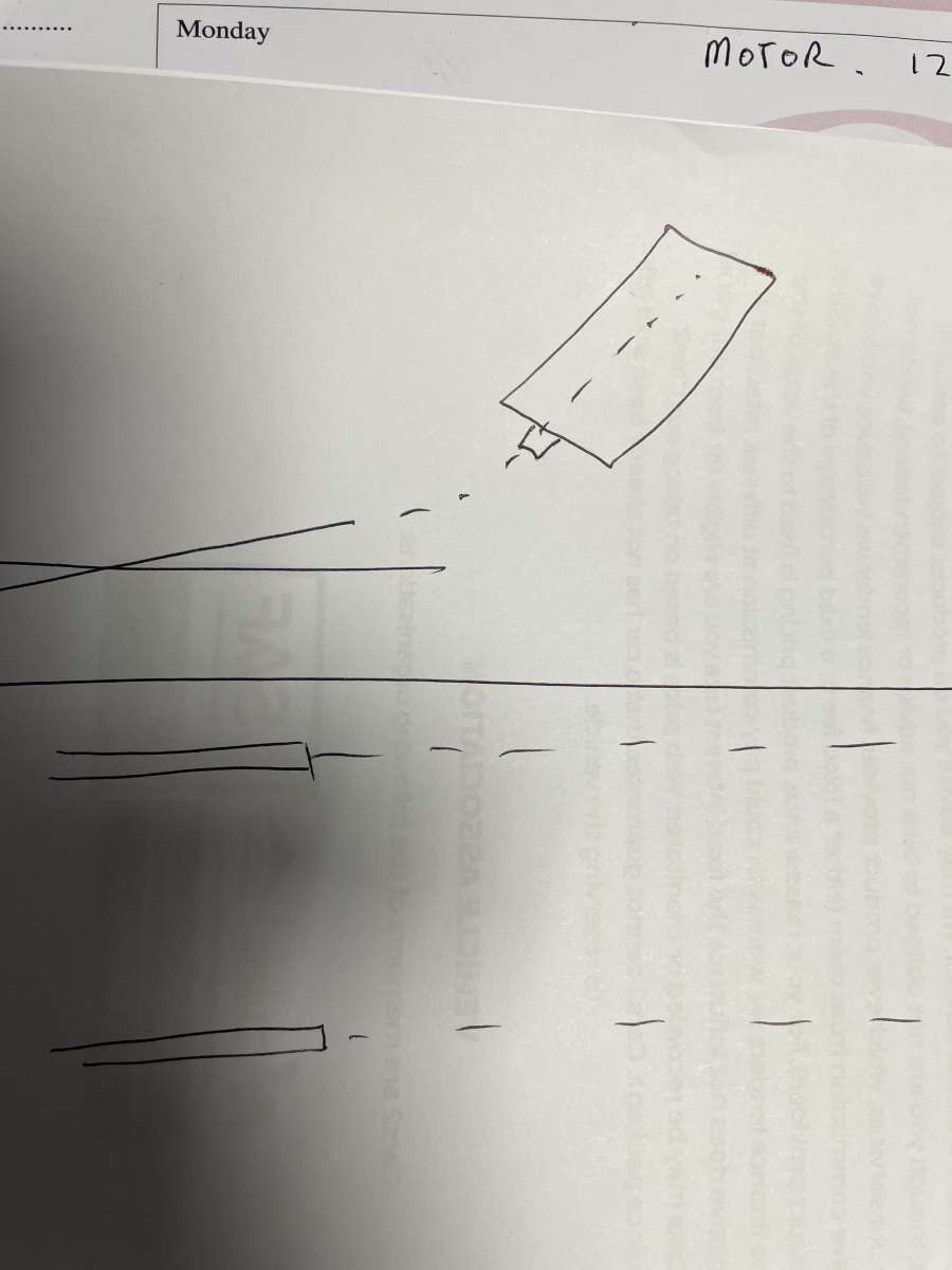

                                    I found the thread on double universal joints. It discusses options etc. what is not mentioned is how much out of line in one plane the joints can be?
                                    excuses for my poor sketch.
                                    IMG_8068
                                    #126321
                                      I have fairly recently seen a twin engine tug installation where the double UV joints were at quite extreme angles and it all worked fine.
                                      What you have to bear in mind is that the bigger the angle, the larger the losses so it becomes a case of what is acceptable as regards losses in the joint.  Also of course, the bigger the angle, the more the joint is actually working so the shorter the life of the joint.
                                      If you look underneath many of the rock crawler type of RC cars nowadays the UV joints are at quite surprisingly steep angles.  The big difference being that they are turning very slowly and are driven by hi-torque motors.  Fast motors opens up a range of different concerns.
                                      If it was me I would always aim to minimise either parallel displacement or angular displacement to give the couplings as easy a life as possible.

                                                  I agree I would be better starting again with them. It will not take me too much trouble to make a rubber uj.
                                                  I will get them made and try it before I cut them out. It’s worth a try.

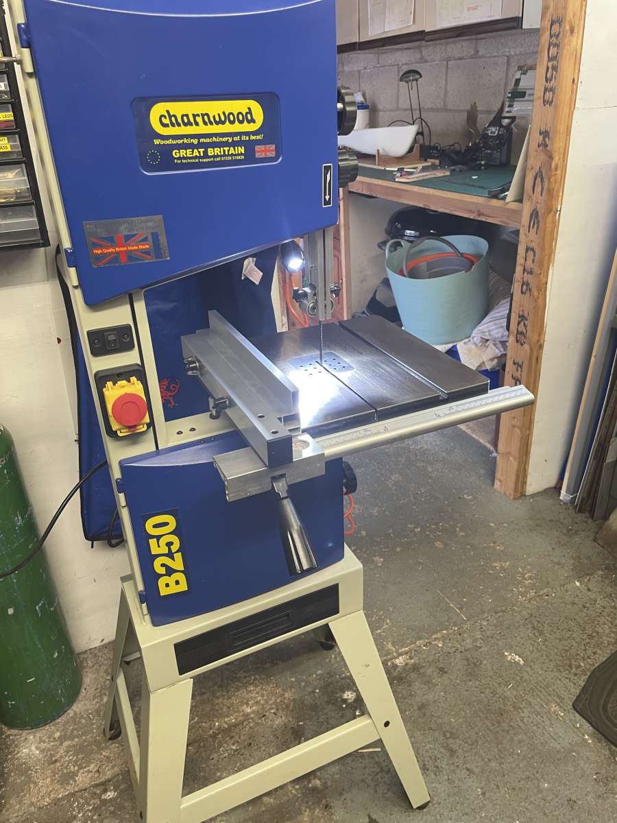

                                                  AIMG_8087IMG_8086lso got my new toy today. As it happened a work colleague was looking to move this on.
