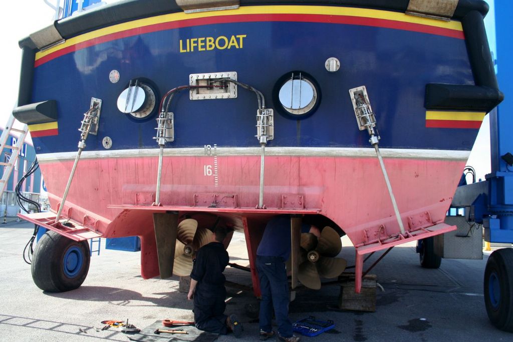

                  #26562
                    Here is a lifeboat shot showing how the trim tabs are fitted. As you can see there are three on this one!
                    #26564
                    Ian Gardner
                      @iangardner62867
                      Thanks Colin,
                      As I thought then- they certainly look purposeful. I’ll be very interested to see what effect fitting a pair will have on my boat. I have also discovered that some model power boats have r/c trim tabs. This was my first foray into  faster boats so I have a lot to learn.
                      Ian
