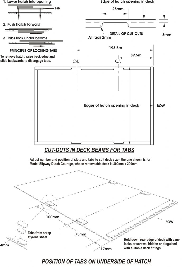

                      There are several different installation diagrams for Aziz on this website **LINK**
                      P94 can be used as twin independent ESCs for twin-stick control – so-called "Tank steering – or, with a simple change of an on-board DIL switch, either 50% or 100% motor/rudder mixing. It's not compatible with just one current Futaba set – the 6J – but works OK with all other radios we've tested it on. **LINK**
                      2G4 makes sense in just about every respect apart from submarines. My everyday sets are all Hitec.
                      Aziz has a low freeboard and openings at the side of the rear deck. This means that the large hatch MUST be held down securely to prevent ingress of water. The later model tug "Dutch Courage" has a system of tabs built into its similar design to achieve this – I'll see if I can find the drawing and post it on here so you can consider this modification to your Aziz. It's not complicated or expensive.
                      #73629
                        Here it is:

                          Sorry for the delayed reply. I have now got my Aziz kit and so far have the stand built. I am waiting on motors and mounts to arrive early next week.
                          Thank you very much for the above information, I'll certainly consider the modification, it certainly seems simple enough.
