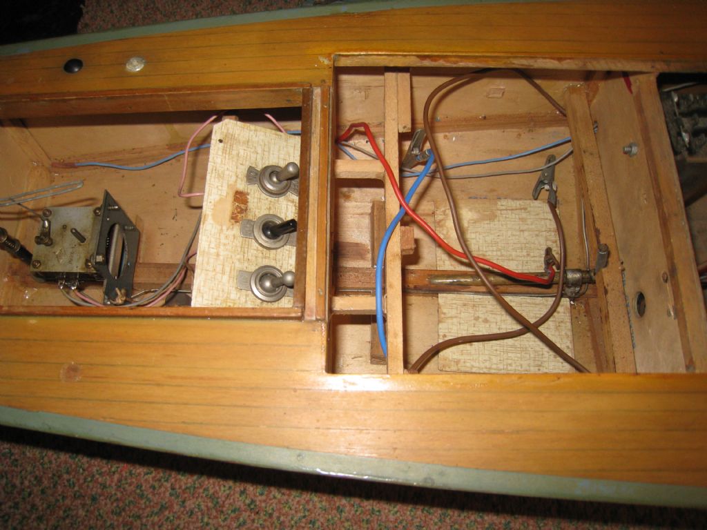

      I have a the above model boat built by my father & grandfather in about 1960 (I think). Its in very good condition considering its age but its not been in the water for over 25 years.
      I would like to restore it to full working condition with new electronics etc – the boat currently has a copper brush type motor which was fitted about 30 years ago (12V I think) & a clockwork rudder escapment. It used to have 2 x 6V lead acid batteries – the transmitter/reciever were home made & do not work.
      I would like to keep the boat all electric but this time with a sufficienlty powerful motor to make it plane.Can anyone give me any advice on what to use in the following areas:

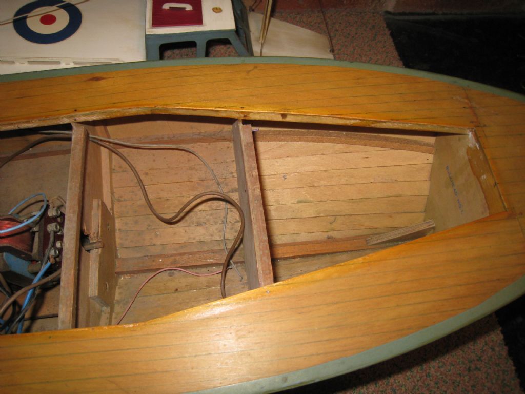

          It would help if you could post some photos of the model and any equipment that you might have.

            Just to add to Paul`s comments, we would want to know. . Do you have much internal room to fit STUFF, or is it full of wood..bracing and so on (I see it is a kit,???? but you never know)
            i ask these questions as certain Mr T a while ago did much the same thing as you are attempting with an RAF rescue launch  his father made. Considerable surgery had to be performed inside as although the boat had been fitted out for a motor and batteries and there was not a lot of room to fit alternative equipment, and even then it ended up nose heavy, although I am happy to say at the end of the day the boat worked fine and just about got on to the plane.

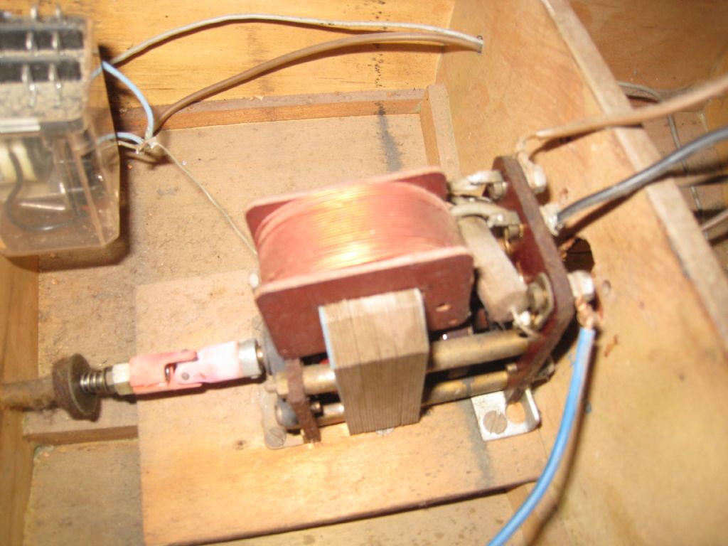

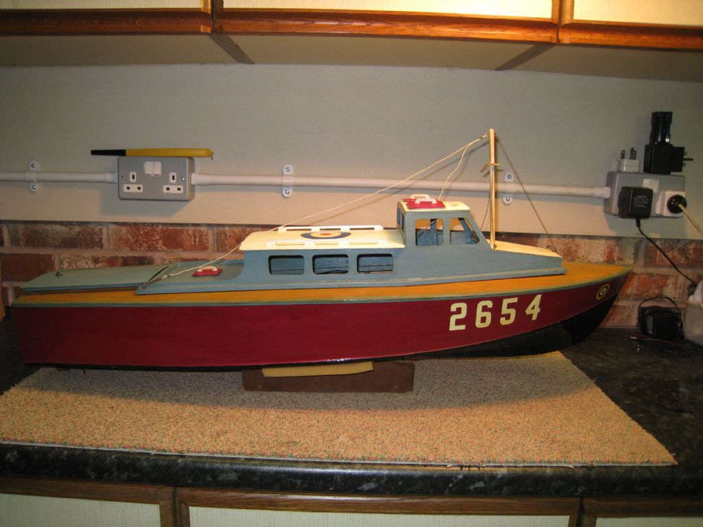

              img_0471.jpgimg_0468.jpgimg_0467.jpgMany thanks for the replies & the information within – I have created an album of photos as requested
