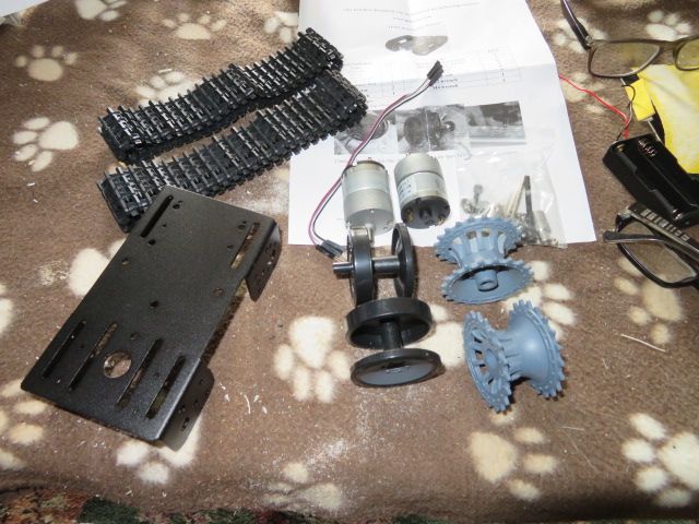

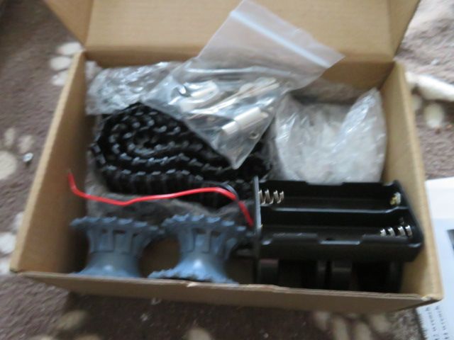

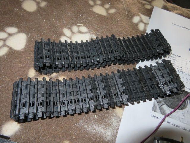

          So, what did i do………..i bought a box of nice tricks from eBay.
          The box contains something pertaining to lifeboats but something i have never ventured into before………a TANK………
          well not quite, but some caterpiller tracks, drive and trailing wheels and all other parts to make an RNLI Case L tractor to pull my Liverpool class lifeboat on a trailer.

          Absolutely perfect…….tracks and wheels perfect, right length, correct width and only two main wheels per side, with a chasis to build the main body on to………and with some offer discount, i got it for £27.20p………..a tenth of what a tracter with wrong tracks would have cost me………………..plus, i will have great pleasure in building the body and towing hooks etc to fit onto the chasis.

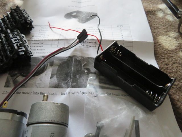

          and with the kit came the two motors to get the tracter working under r/c.
          i also bought a set of tracks with similar wheels plus two extra wheels to fit inbetween those sets of wheels for the bogies on the trailor…………they are from seperate suppliers, but all the same size diameter wise, but this "robot" took only 8 days to arrive from China………..fantastic service…………..and i am sooohh excited to start this too,The case l that was used at blackpool with the lifeboat i am going to buils was the older more exposed case……….and have one very handy to go and photograph this summer in Blackpool.

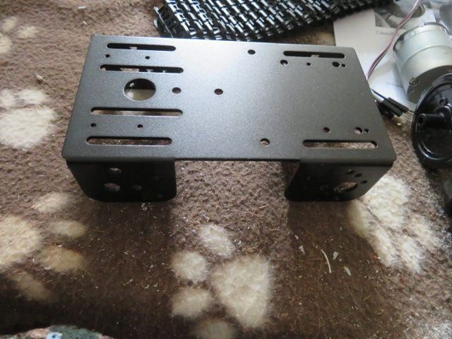

            WELL, as I hurt my back shifting a garden box containing all sorts of crap yesterday, I am taking it easy today and resting it…………but if anyone knows me…………I cant sit still without some sort of modelling to do or my hands start twitching and I end up picking my nose or ears for something to do………..and so!
            this afternoon, I couldn't leave my new little box of tricks out and start fiddling.
            I first mounted the motors onto the steel chasis, only to find that the wheels with tracks on, didn't match up centre wise with the mounting holes for the motors, and so had to make a choice………..
            Either to shorten the tracks as supplied………..and shown in the "instructions" or to lengthen the chasis.
            The instructions are in one line "have a guess" type sentences with photos so dark as to be stairing up black holes [ and I dont mean my nostrils] I decided to cut the chasis into two parts, and use the bed of the tractor, [to be made in plasticard as a new chasis top which the engine and other things can be mounted to] where I can stretch the positions of the motor centres to keep the tracks tight, by using the slots in the chasis as adjustment tracks.
            Once I had cut the steel chasis in to two parts,using a fine metal cutting blade on my band saw I made the bed from 3 parts, a piece of flat grp sheet and two pieces of 2mm plasticard.
            I then glued these sheets together using 30 minute 2 part epoxy and then used a piece of ply wood to keep it flat, by clamping the sheets to to the ply………..and there it will stay until set.
            Then it will be drilled for nuts and bolts as the fasteners and left until I figure out how to fit the guide wheels lol.

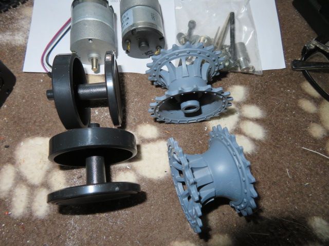

                    What an interesting thread Niel. There are actually a huge number of model tank suppliers, particularly in 1/16th scale where you can buy metal tracks and wheels and all sorts of fancy control gear but one or two items that you might find interesting are such things as metal tracks, which sag much more realistically than the plastic ones and metal sprockets and road wheels for them to run on.
                    One thing that I have noticed though is the fact that your motors appear to be connected directly to the sprockets and one is at one end of the chassis and the other is at the opposite end.
                    Just a couple of questions then, are both motors connected to the driving sprockets to ensure a positive transmission to the tracks and, all the tanks I have had, and still have, have been connected through a gearbox with quite a significant reduction in revs. Connected directly to the motor might prove extremely difficult to control in a nice slow controlled manner such as you would be looking for with a tractor.
                    I hope I haven't thrown a spanner in the works but I would hate you to put a lot of work into such a project then have to ditch a chunk of it further down the line.
                    I have just noticed from the original instructions that you got with the kit that there is a drive sprocket at opposing ends of the tracks, which is why the motors are connected at either ends of the chassis.  This might end up looking a little odd on your tractor when you end up with one driving sprocket on one side at the opposite end to the engine.
                    If you would like me to take a photo of the inside of one of my tanks so you can see the normal arrangement of motors and gearboxes let me know.

                        I found a couple of shots on Ebay, these show an arrangement where both sprockets are at the same end, where the engine is, and both going through quite a significant reduction gearbox to give realistic revs at the sprocket.

                          firstly, all of the tank tracks that i have seen are ALL the wrong "shape" at both ends and not high enough to give me the profile of the old RNLI Case, and at 1;16 scale they are too long………….the case tractor is only 12" lomg from extreme front to rear.
                          as for the motors, they actually have gear boxes attached to them and maximum rpm at 12v is 345 rpm……. i will be using 3.7v 2700ma batteries running in series [or is it parallel] giving 5400 ma of duration………so i would presume with those batteries, maximum endurance with minimal rpm……………….

                                  just when i thought that i could relax a little…………these came through this morning fom China………….the tracks and wheels for the carriage for my Liverpool class lifeboat.
