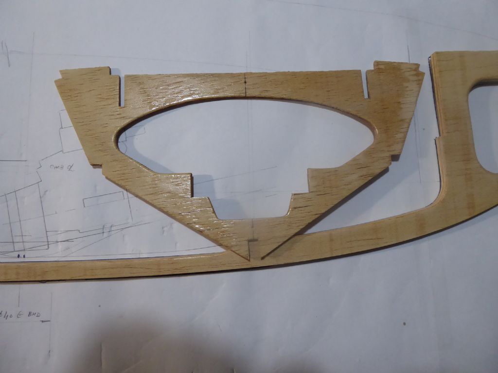

                                                      Continuing now with the bulkheads and making a lot of sawdust. On the plus side I am collecting some nice little bits of Lite ply for use elsewhere.
                                                      Here is the most forward full frame. Like all of them, it is pre-coated with epoxy to seal it.

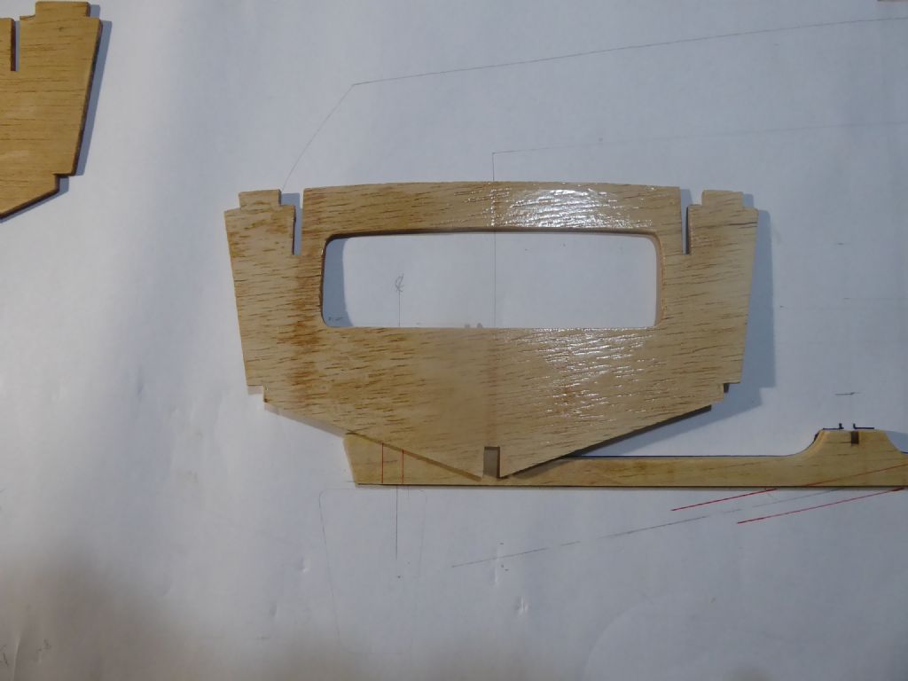

                                                      Here is the bulkhead at the fore end of the engine compartment. Because I am moving the engine aft I cannot use the engine mount supplied. The notches take the fore ends of the engine bearers.
                                                      In the background you can see the drawing where I plotted the various levels for the new alignment. Time will tell and fingers crossed.

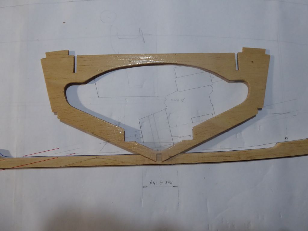

                                                      This is the engine space aft bulkhead. Here I need the clearance for the flywheel and starting cord. I am cutting things as fine as I can here. There is not much wood above the keel but it will be fine when all glued up. Just hoping not to break it by being clumsy. The notches support the aft end of the engine bearers.
                                                      This bulkhead supports the aft end of the fuel tank. When I have done a trial fit of all the equipment there will have to be a hole on the port side to take the exhaust hose.

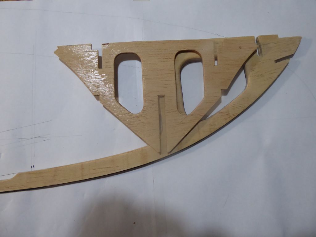

                                                      Finally the aft bulkhead. Here the lower edge of the cut-out corresponds with the height of the servo arm for the steering. It may need a hole for the exhaust but I have not decided yet.
                                                      It is a lot of fun planning where the bits will go and balancing up the weight distribution as far as possible. Easier now and I can be more predictive thanks to DM and the drawings.
