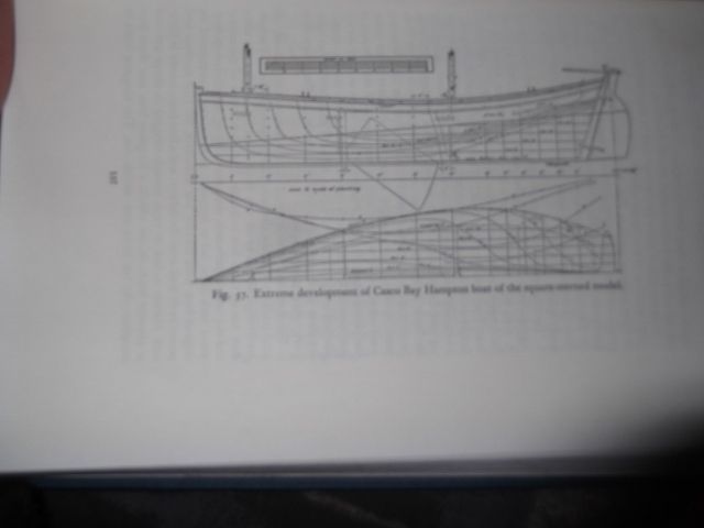

      Well my new build is under way, a 1/10 scale Matinicus Island Square Sterned Hampton Boat. This is a small, (23' open fishing boat popular in the Casco bay area of Maine USA around 1880s. My model will be of one that has been converted to a motor pleasure boat.
      The hull shape of these boats is quite remarkable for a boat of their time. They have a very long wall sided bow, with the maximun beam well aft, and a very flat run and hard turn to the bilge. The transom has a strong tumble home, which is carried well forward.
      The lines plans below was taken from a boat built at Orrs Island Maine, around 1900, and is a more extreme model of the type. She was strip planked, which is about the only way to single skin plank a boat of this shape.
      These hulls were popular in the early days of power, as they drove very easily.
      The model will be 29" long by about 7" beam and displace 6 or 7 pounds. Power will be a brushed motor, with a reduction drive and a large flat pitched prop, I want good static thrust, rather than speed. My plan is to simulate what such a boat would be like on the open North Atlantic. The Estuary where I do my boating can get quite rough, and it is my intention to get this little boat out in it! To this end I have deepened the hull slightly and set the prop well in board, for to keep it in solid water.
      Construction will be polystyrene (I have an awful lot of it) with a plastic skin.
