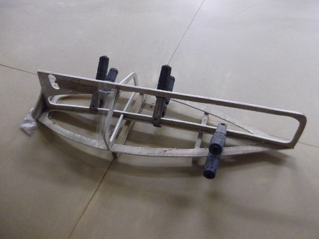

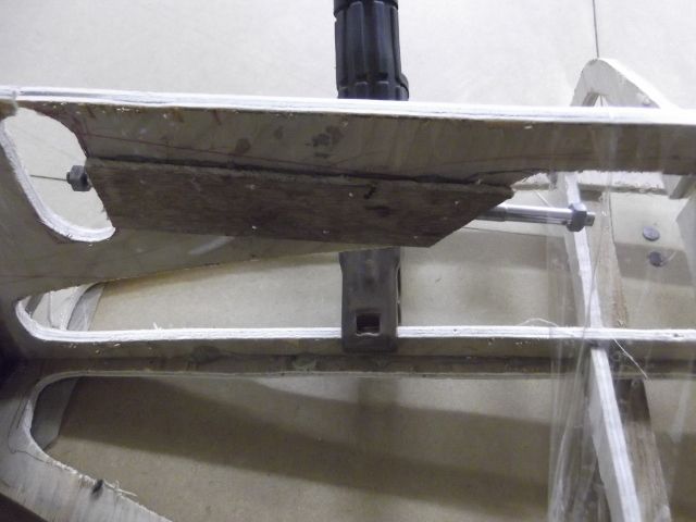

          Frame work, 1/4" plydscf5918 (640x480).jpg
          Prop tube and shaft is two bits of antenna tube with headless bolts epoxied in each end

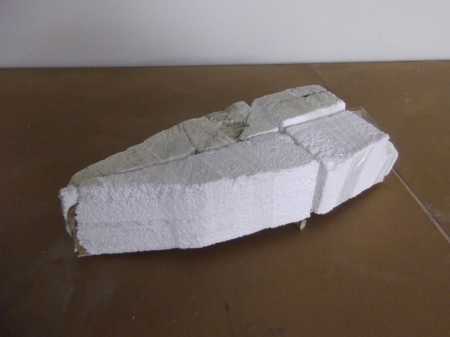

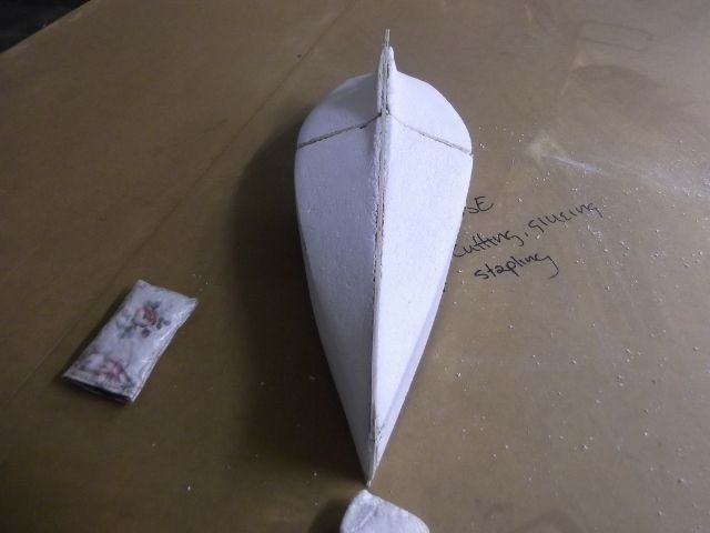

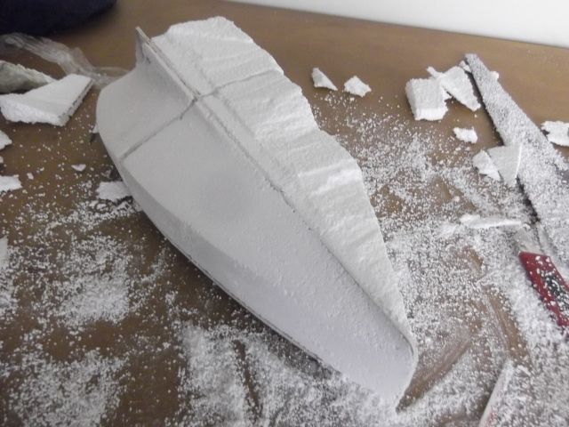

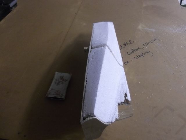

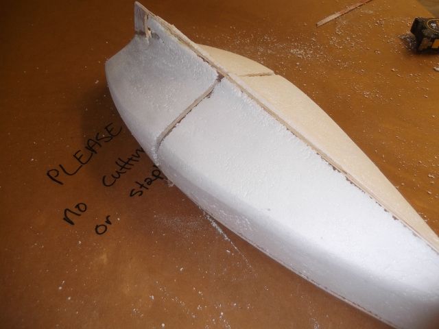

                Well, a bit more progress.
                The frame has been filled in with blocks of polystyrene…
                rumour has it there's a boat in there!

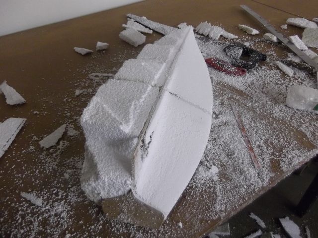

                one side carved to a single chine hull form.
                both sides done, showing the very long bow section.
                sanded to a double chine hull. I use the chines to determine the remainder of the hull shape. The one section and the transom are my only reference points, and all shaping is done by eye. Next step is to round the chines off. This model would translate very well to a single chine ply hull, and if I was to do her in wood, that's the way I'd go

                  AmyJ. Nice shape that, and by eye. Thats how to do it. Remind me again of how you are going to fill the gaps and what covering you intend to use.
                  Are you using the patent AmyJ glue still?
                  #52439
                  Amy jane September
                    @amyjaneseptember49770
                    Hello Ashley
                    Thanks, I'm finding this quite an intriguing shape to carve out, shall be interesting to see how she goes!
                    The gaps will be filled with slivers of polystyrene, and the whole thing draped with an old bed sheet, slathered with spoilt milk, acrylic paint, patent AmyJ glue and icing sugar.

                      Amy jane September
                        The icing sugar is in the Ajoop, as a brush on filler. (I'd run out of talcum powder, and the icing sugar was the only powder I had that was fine enough at the time, seems to work ok though, in fact the finish is quite sweet.)
                        The long bow, and fairly deep fore foot, on the Matinicus boat was done to help stop them tramping (lifting the bow out and pounding down) to prevent her from throwing freezing North Atlantic spray around, so a similar concept to your frigate.
                        Aj

                          One serious comment, though, AmyJ……….Beware the dust particles when sanding the poly foam!

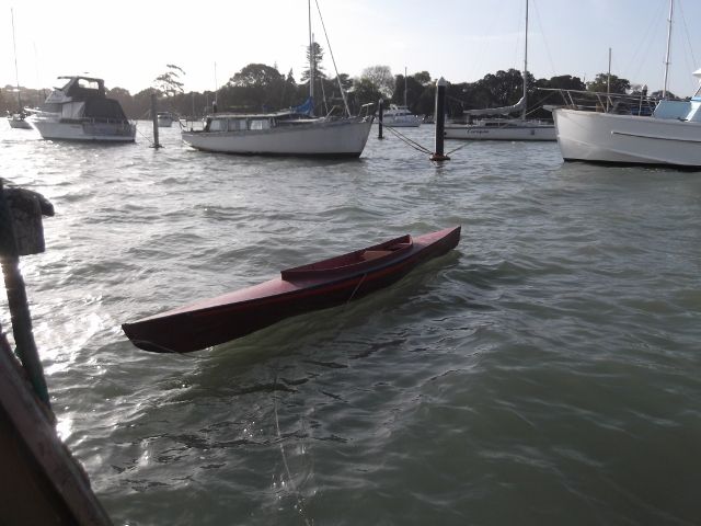

                                Ashley. I am an old hand with hardboard. The 14' canoe that I've being paddling around for the last few years is built from…….hardboard!
                                laugh

                                    I shall post a pic for you next week. She lives on the end of the marina jetty, outside in all weather, and is still perfectly sound. (No, she's not fibre glassed and only painted with acrylic house paint)
                                    #52591
                                    Amy jane September
                                      Here you go Ashley
                                      the hardboard canoe

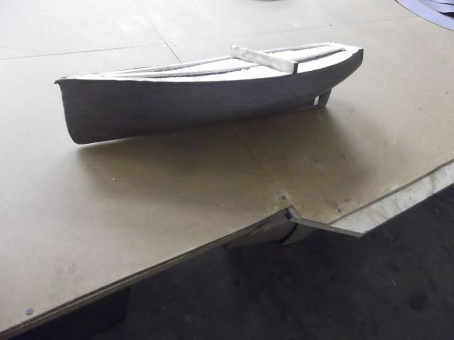

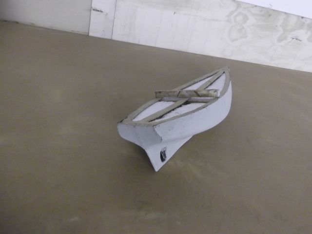

                                      The hull has been sanded to the final shape and the first skin added.
                                      The skin is a bit of old bed sheet, cut on the bias, so that it drapes well around the compound curves. It is glued on with home made casein glue, ( heat some skim milk with vinegar to curdle it. Collect the curds and put the in the blender with a pinch of baking soda and water and blend, adding enough water to make a PVA like glue), This dries to a hard plastic skin, but is not water proof. Once dry, it is sanded and a second layer added. Whilst the casein is not even a little bit water proof, it is petrol proof. The "liquid plastic" I use is nothing more than all my polystyrene waste dissolved in petrol. When this dries a hard and completely waterproof skin is formed. The next step is to put another layer of cloth on, but this time with the liquid plastic, to form the final waterproof skin.
                                      Ok, so I hear you ask, Why don't she just use epoxy and be done with? The cheapest epoxy I can get is $100 a gallon, and I might just want to build a REALLY BIG model by this method, due the fact I have a REALLY BIG block of polystyrene!
                                      Some more piccies

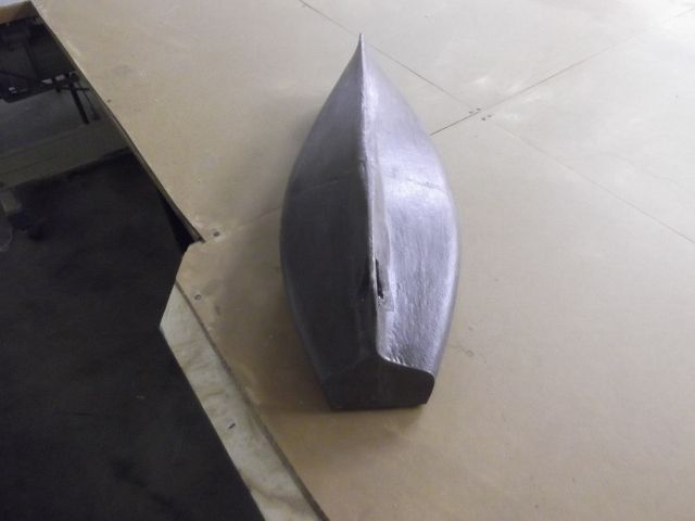

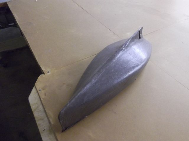

                                                Busy at work again, so progress has been a little slow. The hull has been filled and sanded and the last layer of cloth is on. This layer needs to be put on with my liquid plastic, to make everything waterproof. The problem is that the liquid plastic don't wet out very well, and it is hard to get a good smooth bond. To over come this, I glued the cloth on with interior acrylic paint. The difference between interior and exterior paint is, that while both are water proof, the interior is permeable, and the exterior isn't. So once the paint is dry a coat of thin liquid plastic is brushed on, and it will soak right through the cloth, and bond it to the layer below.
                                                Ready to be sanded and the liquid plastic applied.
                                                …till next week….
