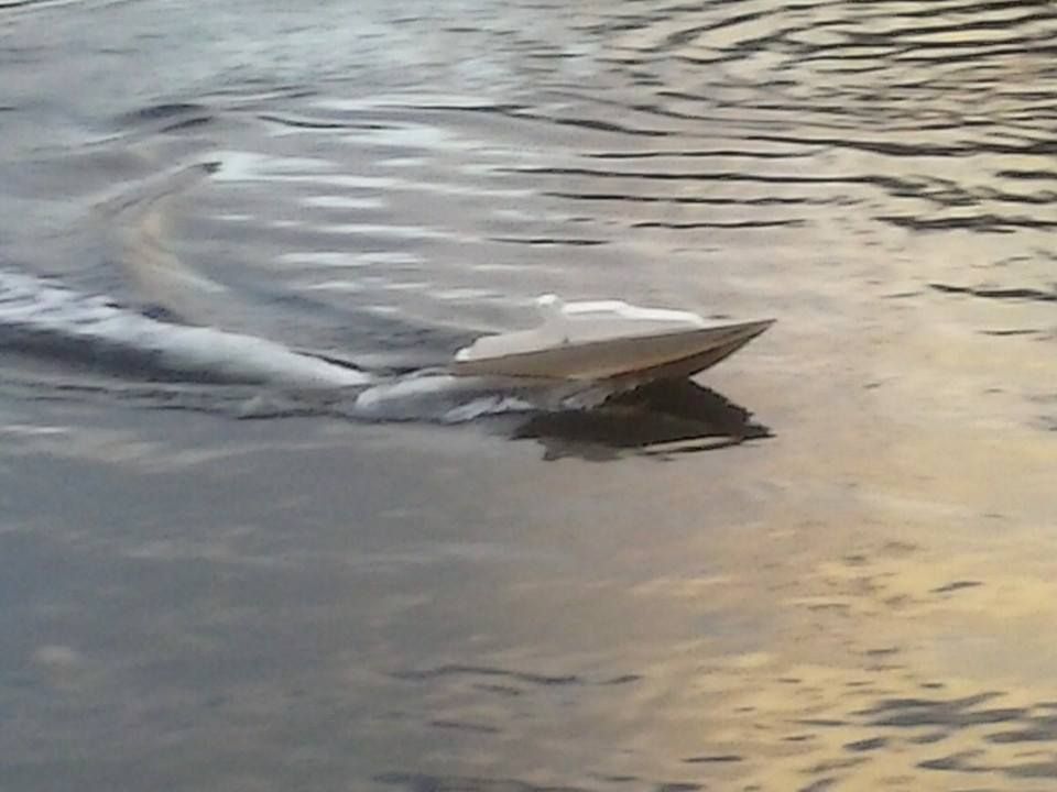

                                                Tested it today before painting it just to check I'm happy with it…But I'm not
                                                Its amazing in a straight line, but when I want to do any sort of tight turn to try get it banking, it comes off the plane and drops to a dead slow and motor starts sounding like it labouring.
                                                I'm thinking the design of the rudder is starving the prop or putting pressure on the prop to make the motor to work harder….Going to test it with a different pitch prop tomorrow.
                                                Picture is of just coming out of a turn at full power…Can see how it wants to pick up again and take off,lol
                                                #44320
                                                Joseph Booker
                                                  @josephbooker97221
                                                  I'm thinking if a different prop doesnt help it then maybe I'll scrap the rudder thats in the plans and have a more conventional rudder….Maybe 1 either side away from the prop
                                                  #44321
                                                  John W E
                                                    @johnwe
                                                    hi ya there
                                                    What motor did you end up using in your model? Was it the aeroplane motor and if so? how does it run hot or cold???
                                                    Also, I think its the actual shape of the rudder which is causing the problem.
                                                    If you made the 'U' shaped rudder, that is on the plan. As you say, it could be starving the flow of water to the propeller?
                                                    Aye, John
                                                    #44322
                                                    Joseph Booker
                                                      @josephbooker97221
                                                      I went with the JP pro 600 yeah….I only ran it for a minute or 2 so cant tell if it had any heat issues…Was warm to the touch but not much hotter than room temp….But I got water cooling ready for putting in it…Dont think it will be a problem with that installed if it was going to be an issue.
                                                      Will let you know if a change of prop helps it with the turning issue…Running a x-type prop at the moment, will switch to an s-type and see if it helps it….But I more than likely eventually will go for a different design in rudder
