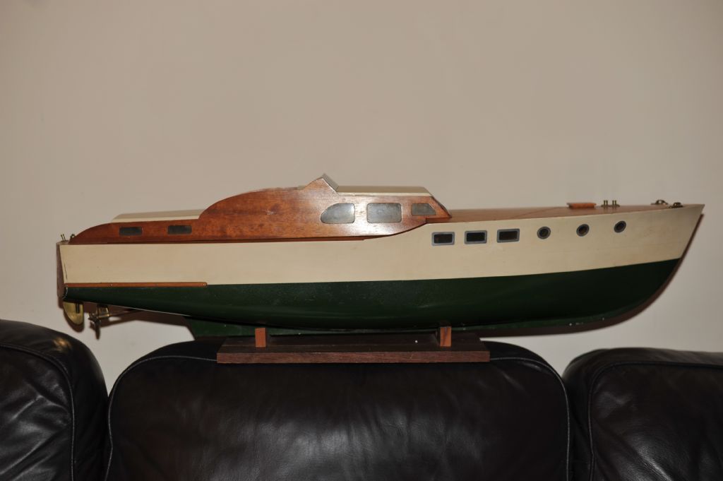

      Hello everyone, I am a newbe to model boats so am in need of pleanty of help!
      I recently bought a model of what I would describe as a 1950s style Italian Launch. She is 34" long 8" wide and approx 7" tall weighing just over 3KG. She is fitted with an old motor and prop with the propeller measuring 40mm in diameter. I want to fit it out with full RC controls but am stuck (confused) on what power motor/battery to choose. I want it to have a decent amount of speed and will also be replacing the propellor for a new 45mm 3 blade version I have seen. My main problem is what KV Motor to choose for this size of boat with only a single 45mm propellor. Is getting any decent speed even possible with this or would it need twin props?

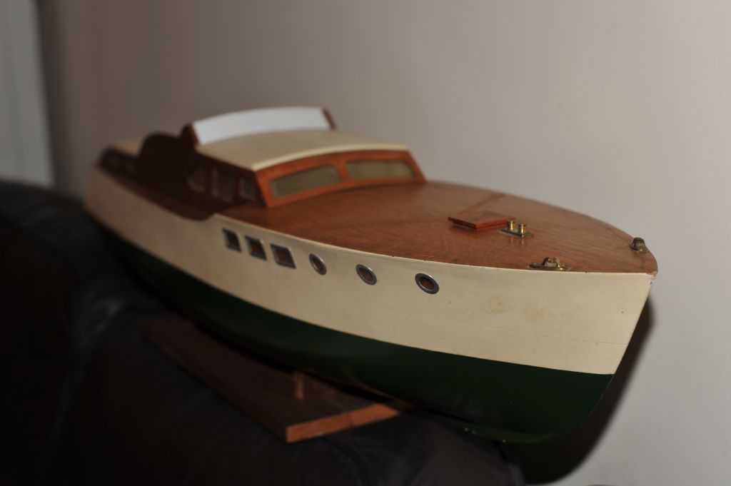

              Looking at the design of the boat and its hull shape it doesn't strike me as a high speed craft in the Fairey Huntsman mould. It looks more of a brisk cabin cruiser type so for realism it needs to be reasonably quick but not necessarily to plane.
              #55705
                You're dead right. That's a semi-displacement hull, in that it will tend to ride a little higher with speed – but there's no "plane" for it get up on.

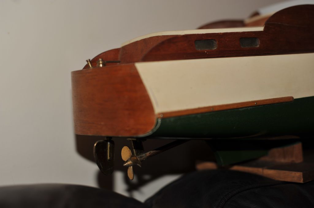

                            Matthew. More to the point would be ..in what condition is your propshaft?? does it have bearings either end or is it a plain tube??
                            You really need to think about replacing the propshaft to cope with all this power, a 4mm diameter shaft will be ok. Personally i would go for one with nylon bearings as they are waTER LUBRICAted…

                                The props ok but it is just a plain tube so I want to replace it for one with bearings, because of the layout of the boat it will need to be 13" long and I havnt been able to find one that length yet? So if someone knows where to get one please could you let me know where? Also If you have look at the picture of the prop on my boat it has a support underneath, I would like to maintain this or get a new one to fit the new shaft, so again where from please?!

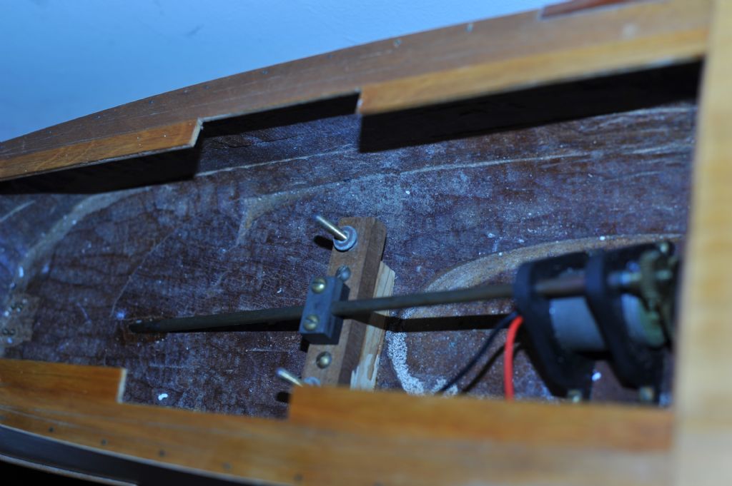

                                        matt. The shaft length you need is the distance from the prop to the end of the coupling on your motor.
                                        As illustrated, your boat has a geared unit with motor underhung. If you are going to use a new motor and coupling you will need to reduce the new prop tube length.
                                        You could also usefully reduce the angle of the propshaft keeping the motor low and the shaft more shallow,
                                        I would suggest buying a bunch of two blade plastic props 35mm-50mm diameter in S and X pitch . These plastic props are very cheap, and you will have a yardstick to judge performance by when you spend 20 times more on a snazzy brass one that does not perform as well……..S and X..   x pitch much courser.
                                        The props hand is such that the motor tightens up on the thread into the prop when driving. i think different manufacturers describe left and right hand pitches differently… the way round a plastic p[rop goes is the correct way.

                                            Thanks Ashley, the current shaft is 16″ so I measured back from the propeller to where the new motor would have to sit to clear boats top cover when fitted as the centre wheel house area dips right down into the hull so it would need to be 13″ long.
                                            Cheers
