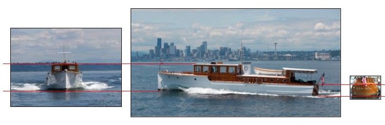

                                              Starting the design.
                                              I am often asked how do I start a design.
                                              In this case it is fairly simple as I take some photos of the subject (as square on as possible) and using an aspect ratio button on the CAD adjust the size of the images until the subject in each image is roughly the same size.
                                              Then using the freehand facility on the CAD I trace them!
                                              Its very unscientific but it does give me the rough sizes and shapes necessary to begin the drawings.

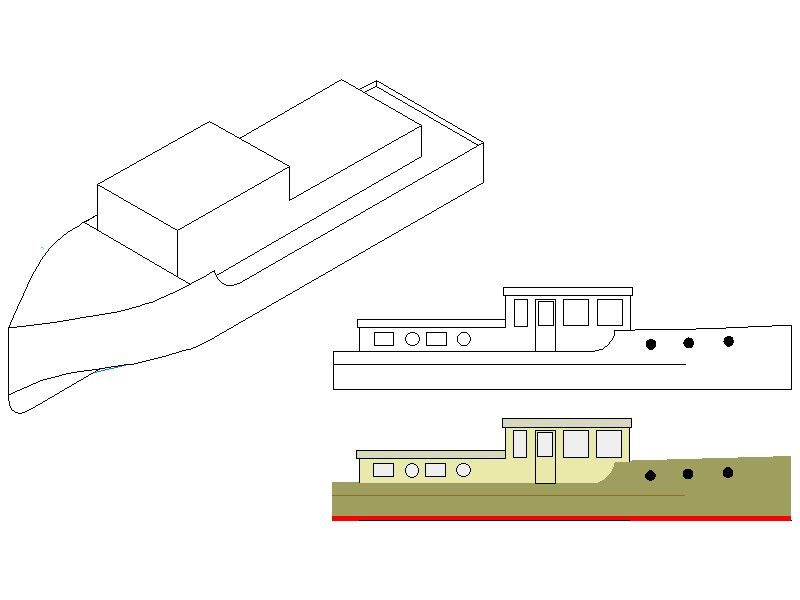

                                                  Another design trick that I will be using on this project is not to make an exact scale copy of the Sea Dog as this will just bog me down in getting critical details correct. I will be making a generic style of the type that will look similar in many ways but will allow me to 'fudge' some of the more difficult details and make the model easier to build.
                                                  The generic design will roughly follow these concept drawings, as you can see there is a strong similarity to the Sea Dog but this design being squarer, boxier and lacking some of the longer curves will be far easier to build.
