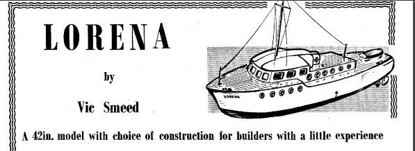

          One model under construction another undergoing major upgrade. I'm building a half sized 21" balsa version of Vic's design 'Lorena' after receiving a set of the plans from Dave Milbourn. Also undertaking a major upgrade to a Dark Class FPB, new brushless installation (information on motors again from DM), new superstructure (after a shed break-in) and rectifying a prop shaft error. The prop shafts are exposed type which I had fitted the thrust washer against the 'A' frame, after reading Glynn Guests item in a Model Boats special, should have fitted collars where the shafts exit the hull – all good fun.
          Just worry about the state of the water to sail them in nowadays, I can't always get there when the club are on-site so I have to make sure I sail down-wind in event of any mishaps. The filth and rubbish also get blown/washed in this direction and after the last outing when I got the model home, copious amounts of household cleaner and the hose pipe were required to clean the model. When the club are there they sail at the top end and have a rescue boat. Nowadays the lake is shared with fishermen and numerous residents who feed the wild life.

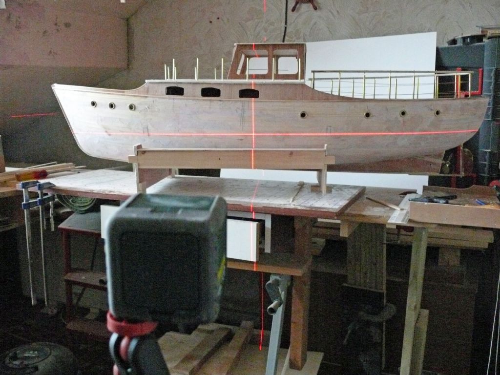

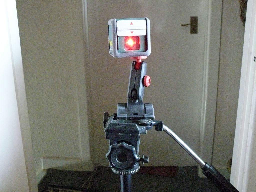

              What about this for a super waterline gadget, you chaps?……..A Christmas pressy from my pal, Ducky
              I`ve re-established the waterline, using the cabin roof as being a level section……..And it looks ok to me
              This Laser gadget is great fun to play with, it appears to be a light source hanging freely on a cord, inside the casing
              That`s why the light is perfectly level and only illuminates when it is level
              I`m using the Laser to make a pencil line in order to nail a sort of rubbing strip on the hull side……..For ease of painting later
              It will also project a true vertical line for handy reference, later

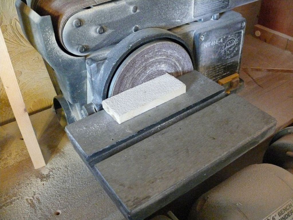

                                            Here`s a little handy tip
                                            Revitalise those Sanding Block edges
                                            Get them on the Linisher!………..Not got one?………Have a word with Santa!
                                            Sharp crisp edges are a treat to work with

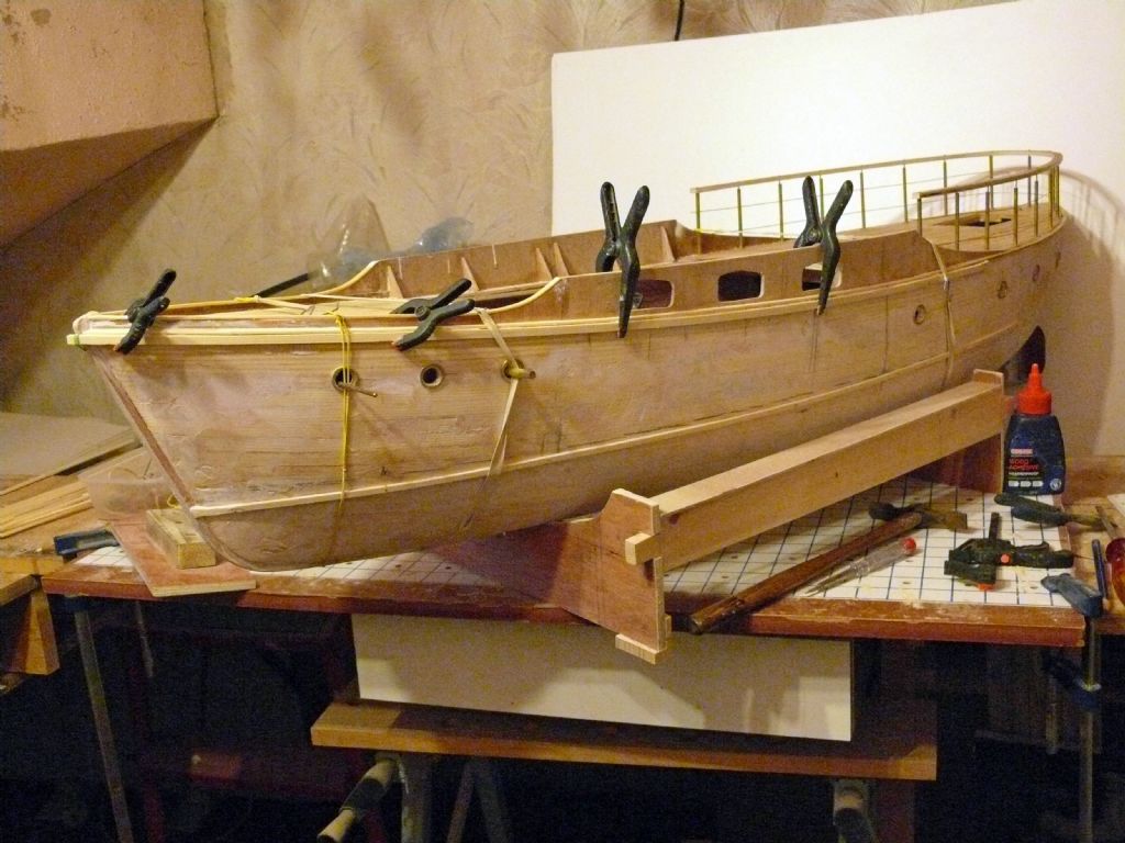

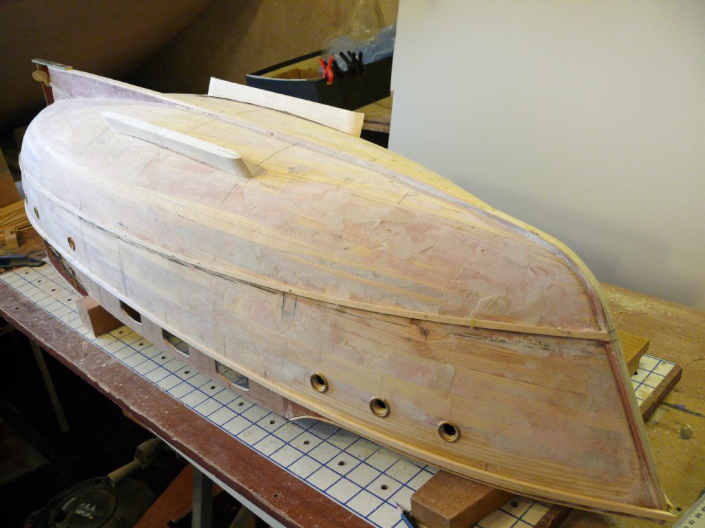

                                              Made a start on fitting the Bilge Keels
                                              And just high enough to act as a temporary stand
                                              #67332
                                                Bob. Obviously the bilge keels are set according to the plan wot you are (loosely) following but they do look to be very close together? I suppose strictly speaking it does not matter where they are, but
                                                ​I think it is a good idea to have the keels so that the boat is its own stand, makes sense to me, also helps when at the pondside to have it free standing.
                                                I have seen models of large tankers/container ships, and the bilge keel snakes down the side, presumably following the wave pattern of the water once the boat is at its designed cruising speed. Very clever.
                                                #67334
                                                  Thank you, Ashley
                                                  For starters……The drawings don't show bilge keels……..You can't get much looser than that!
                                                  If the keels were wider apart, the keels wold need to be deeper, to double up as a stand in order to clear the central keel
                                                  Wide bilge keels are normally quite shallow on this type of boat
                                                  Your comments are always welcome
                                                  #67335

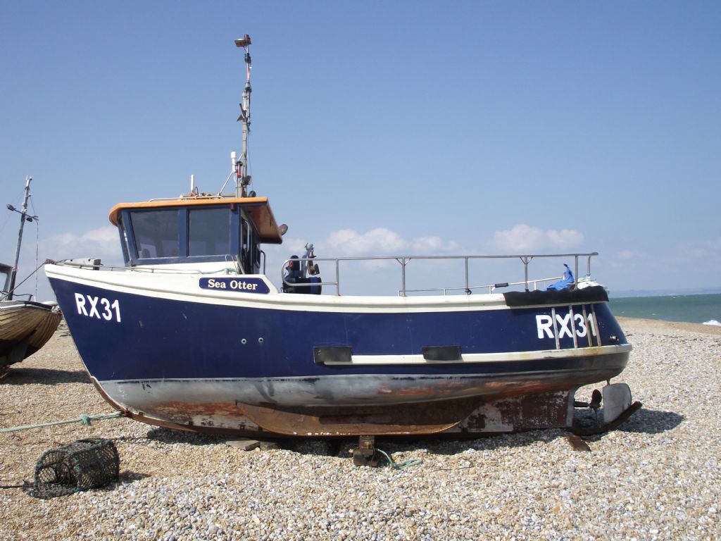

                                                    Generally, I believe that if bilge keels are fitted then they are on the turn of the bilge so that the don't stick out either below or to the side of the hull. Makes things easier when going alongside or dry docking.
                                                    #67336

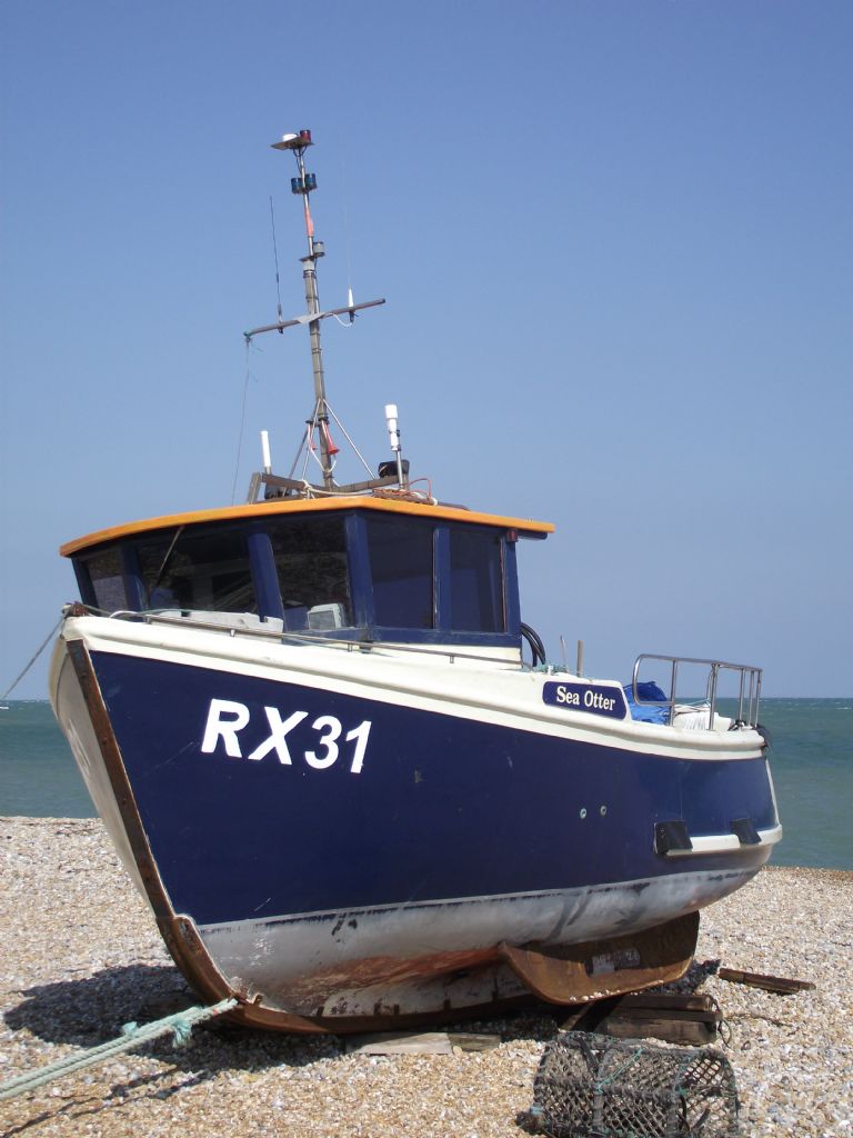

                                                      097.jpgHi All
                                                      I think its horses for courses with bilge keels, this GRP fishing boat at Dungeness has had steel keels retro fitted and a steel keel band to allow her to work off the beach, so being fairly close together keeps her relatively level.
