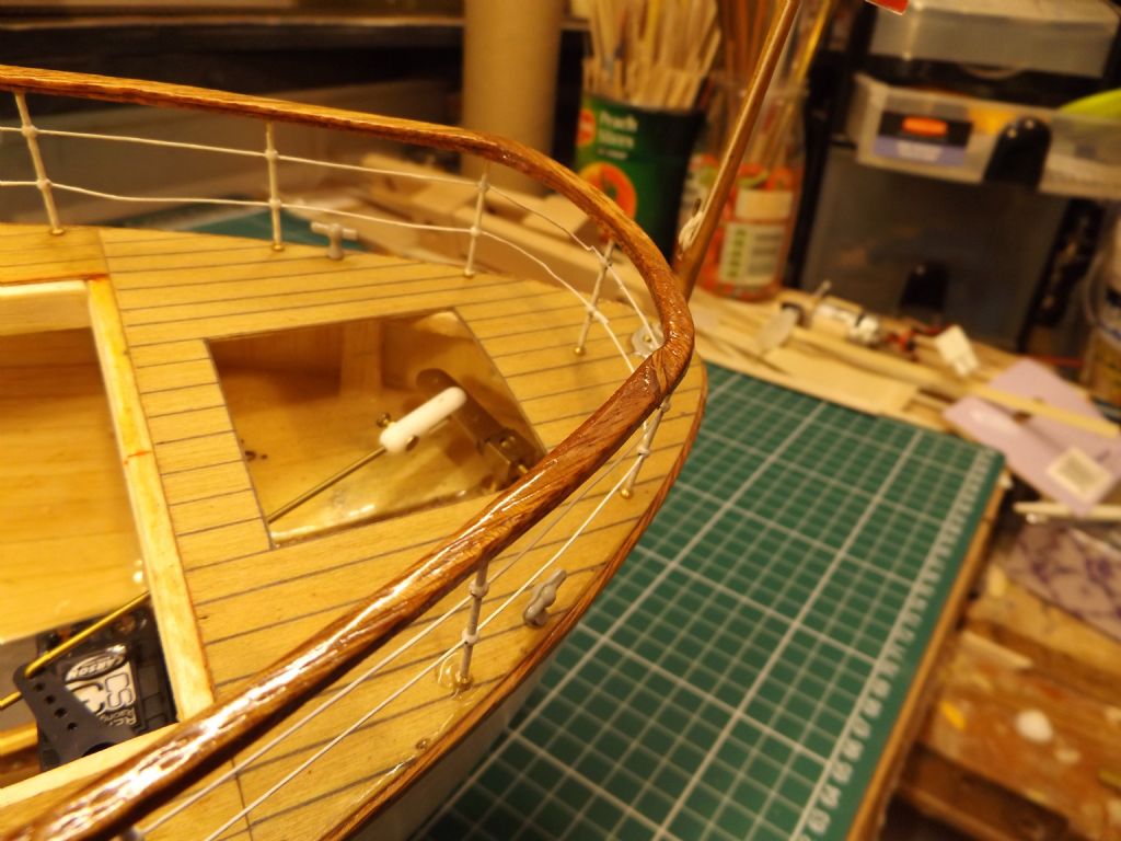

                  Hi All
                  Late to the great stanchion debate, mine are as the original drawing and the picture of the Silver Vanity on the cover of Model Maker mag. My stancions are the Caldercraft 35mm which are very nice, the capping rail on the top is 2 laminations of 1mm mahogany with holes drilled in the lower lamination. my problem was threading the copper wire through the holes and end up looking decent.

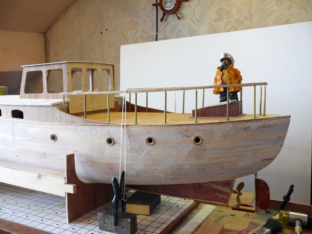

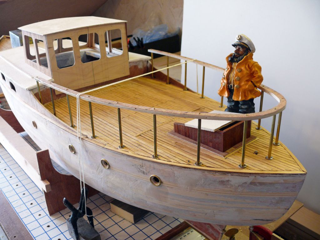

                        A little trial run showing the hand rail assembly……
                        3" long x 4mm dia brass tubes, pushed into the decking and secured at the hand rail with tight fitting brass panel pins
                        Seems ok to me…….So let`s get crackin`!
                        #67184

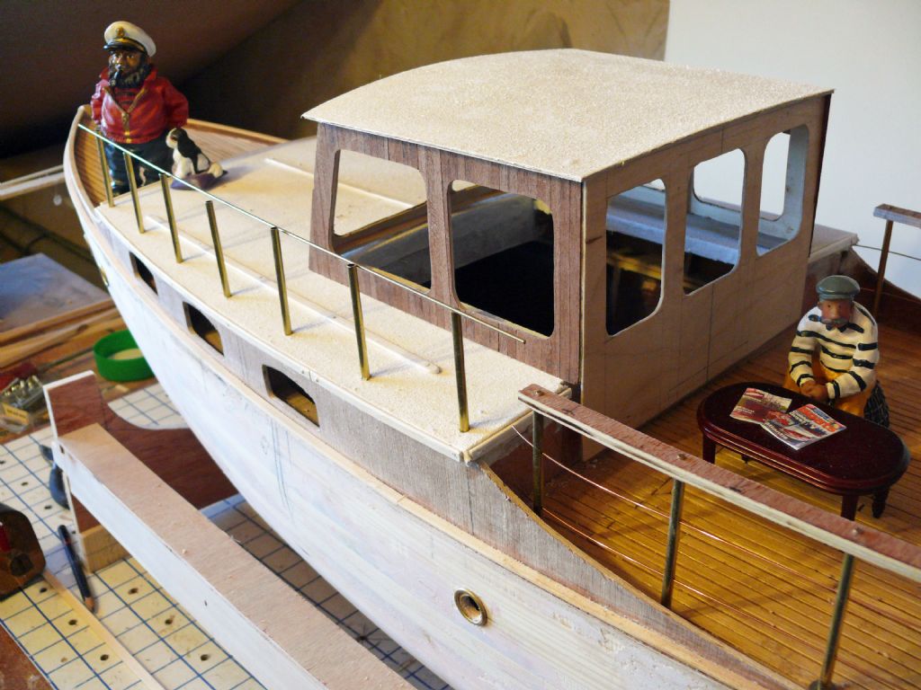

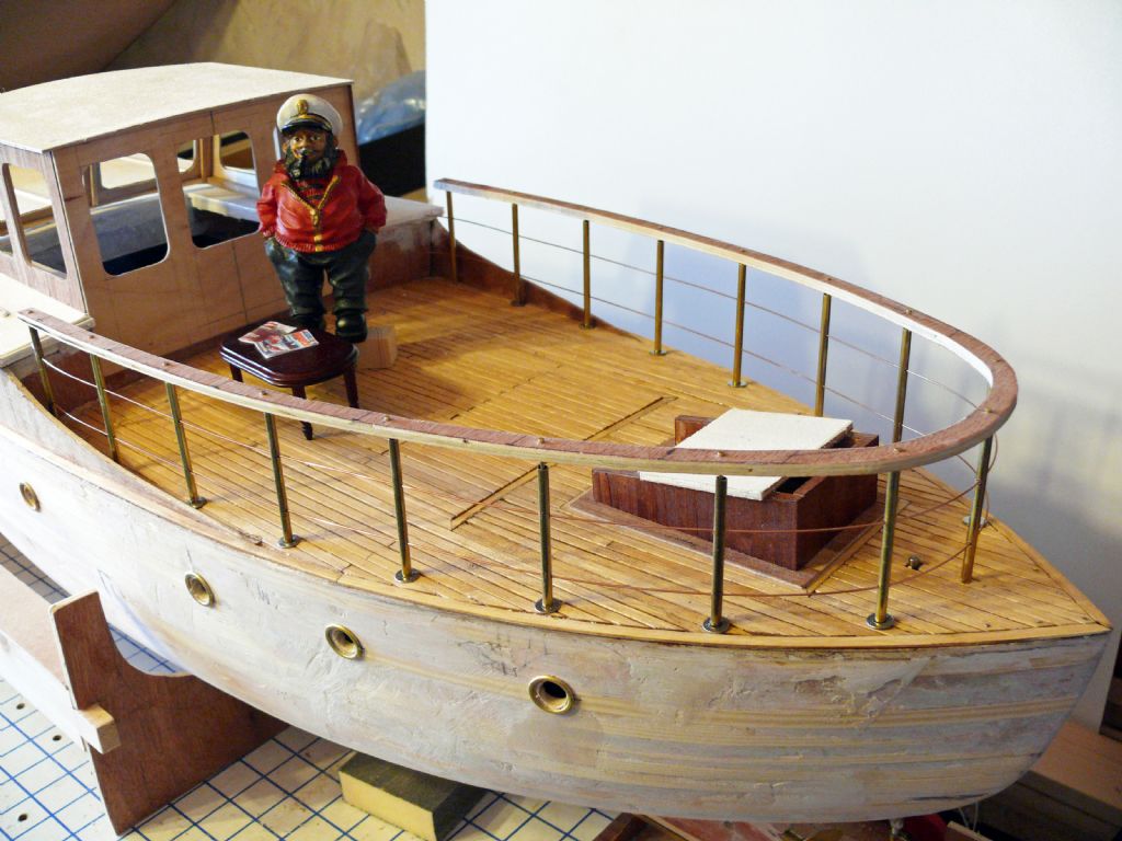

                          Well, that didn`t take long!……….I enjoyed knocking the panel pins in!
                          The swarthy sailor is 5`-10" tall standing on a box
                          The handrails are 33" to the top of the wooden rail
                          They look a bit strange at the moment, because the horizontal rails are not fitted
                          I will have to make a jig to drill the stanchions and then it will look nice………Hopefully

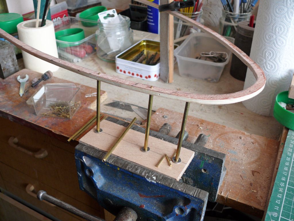

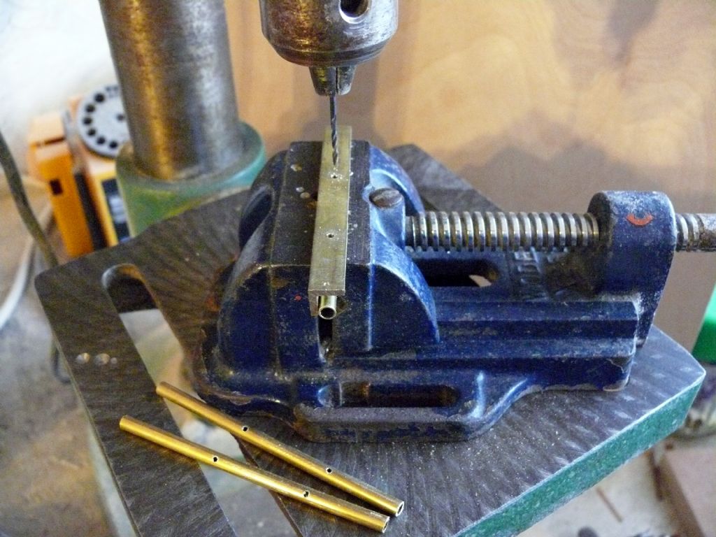

                          #67194
                            This must be the Eureka Moment of the Century, chaps!
                            Apologies for being boastful, but this fixture is full of pleasing engineering features!
                            I needed a fixture to accurately drill about 50 stanchions for the horizontal rails
                            I first gripped a stanchion blank in the drill vice, as a starting point
                            Then an idea twigged…….An angled plate, that can be clamped over the tube, with pilot holes
                            Then wondered how do I get the lateral hole centres…..Dead on?………Mmmmm?
                            The tubes are 4mm dia……..The holes need to be 2mm away from the clamp datum face…….Yep!
                            How do I mark the hole centres……Dead on?……..Mmmmmmm?
                            Eureka!………Use a piece of 4mm hard stainless steel sharpened to a point……As the centre punch!
                            So there we have it……….And it works well too
                            In the photo, the tube end would be level with the fixture end
                            The drill vice has a vee notch on the clamp section
                            Like it?
                            #67197
                              Very ingenious and effective method for larger scales Bob. The pillar drill is pretty essential though as the holes must be at exact right angles to the length of the stanchion.
                              #67198
                                Thank you, Colin
                                I'm pleased you have understood the accuracy of the set up
                                The clever part of the fixture is the method of clamping the tube to the daum side face via the vee block and the accurate method of achieving the pilot holes, using the 4mm dia centre punch!
                                Very satisfying project

                                  Have fitted the minor rails now, just for effect, but the wire is difficult to see at the moment
                                  At least, the holes line up

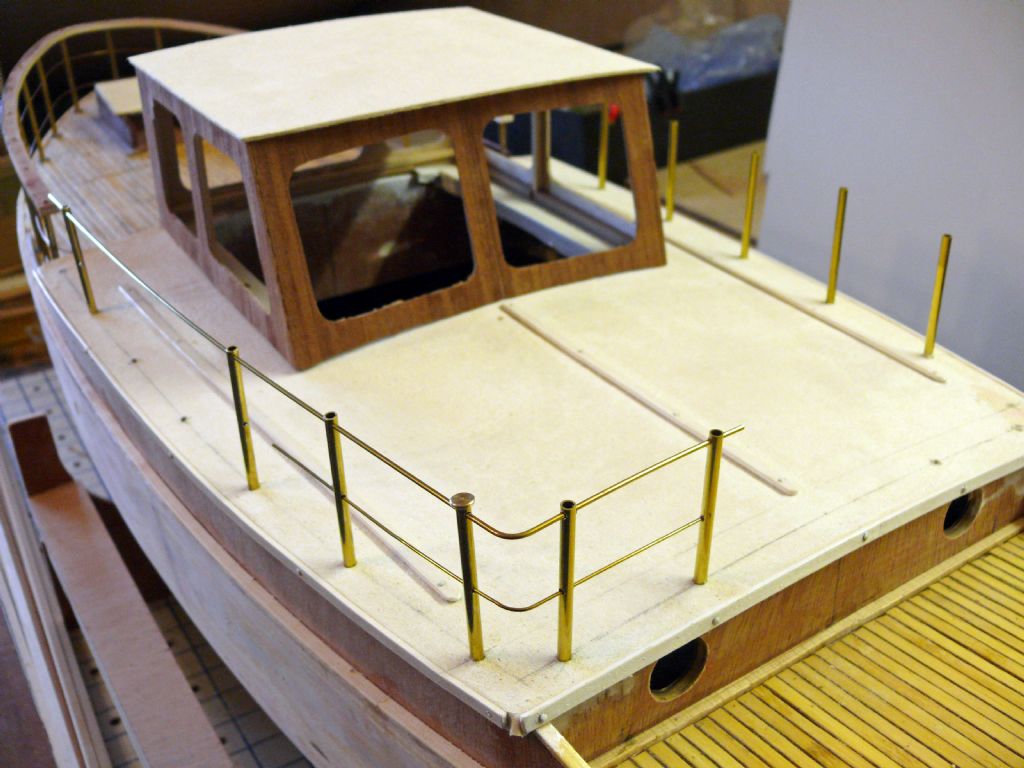

                                    Another quik fix to see how the cabin rails will look at 2" high
                                    Hopefully, I can use the same drilling fixture?
                                    Making my shopping list out now for the Haydock Show
                                    Now that the local model shops are disappearing fast…….The Annual Shows are a real life saver
                                    I know we`ve now got the net to supply the modelling stuff, but 5m of 1/16" is a bit optimistic

                                          Cabin rails under construction……..(Got no brass wire till the Haydock Show)
                                          Ray and Ian will notice that the hand rails are slightly different than the drawing shows
                                          Have taken the rails round the corner for extra support……Nice eh?
