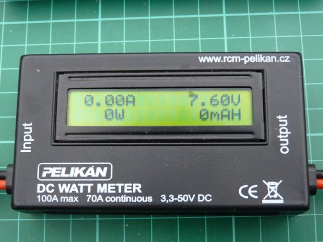

                                        Just for completeness though, while I use a digital multimeter for troubleshooting, I always use a wattmeter to measure motor performance as it will measure much higher currents and displays volts, amps, watts and milliamp hours all at the same time. The one I use is shown here but many others are now available, some much more cheaply than the one I bought about 8 years ago.
