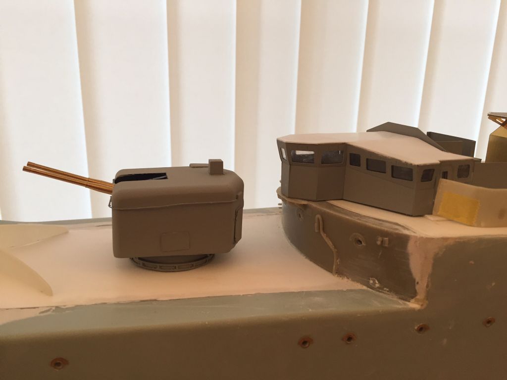

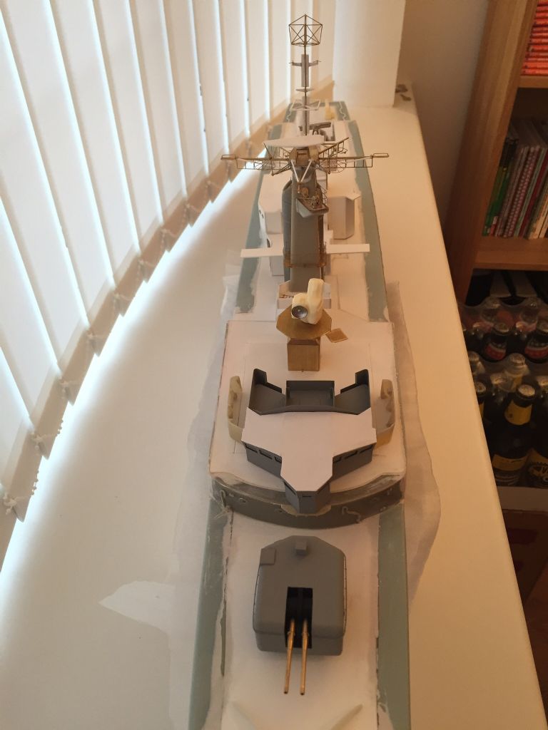

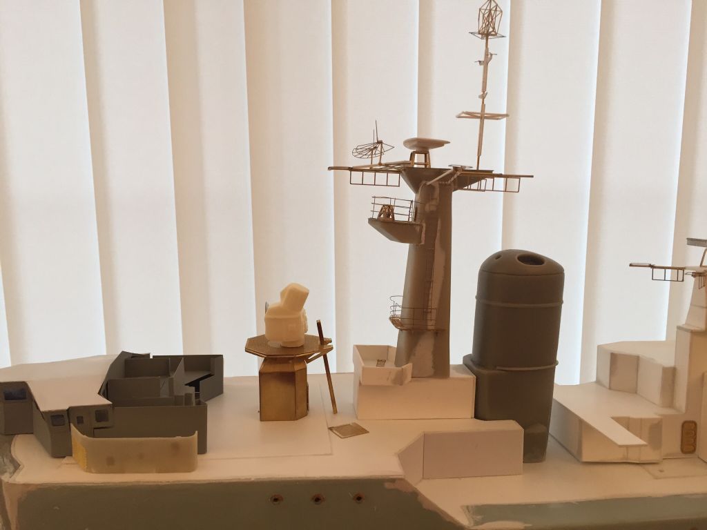

                                Progress is sadly slow on my type 12 (m) but for my first ever build I'm reasonably happy with how it's going. I'm now looking at deck colours, specifically for type 12's around the time of the Falklands. Research tends to point towards "holly bush green" , BS 4800/5252. Could anyone possibly confirm if this is correct?
                                Many thanks
                                Robbie
                                #61776
                                Andy Stoneman
                                  @andystoneman15177
                                  Hi James, I think your right about the deck colour, but from my recollection Holly bush green does come to mind from my time served onboard, ours was non slip so very good during roughers. Good luck with the build. Any Piccys available.
                                  Andy
                                  #61787
                                  James Tait
                                    @jamestait58403
                                    Thanks Andy, now to find a spray can that matches that! Couple of pictures, not great but show where I'm at! Mast work is not entirely accurate but I'm happy with it!

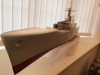

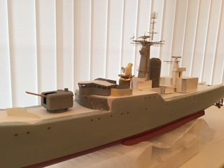

                                        Try again!
                                        #61794
                                        James Tait
                                          @jamestait58403
                                          Few more.
