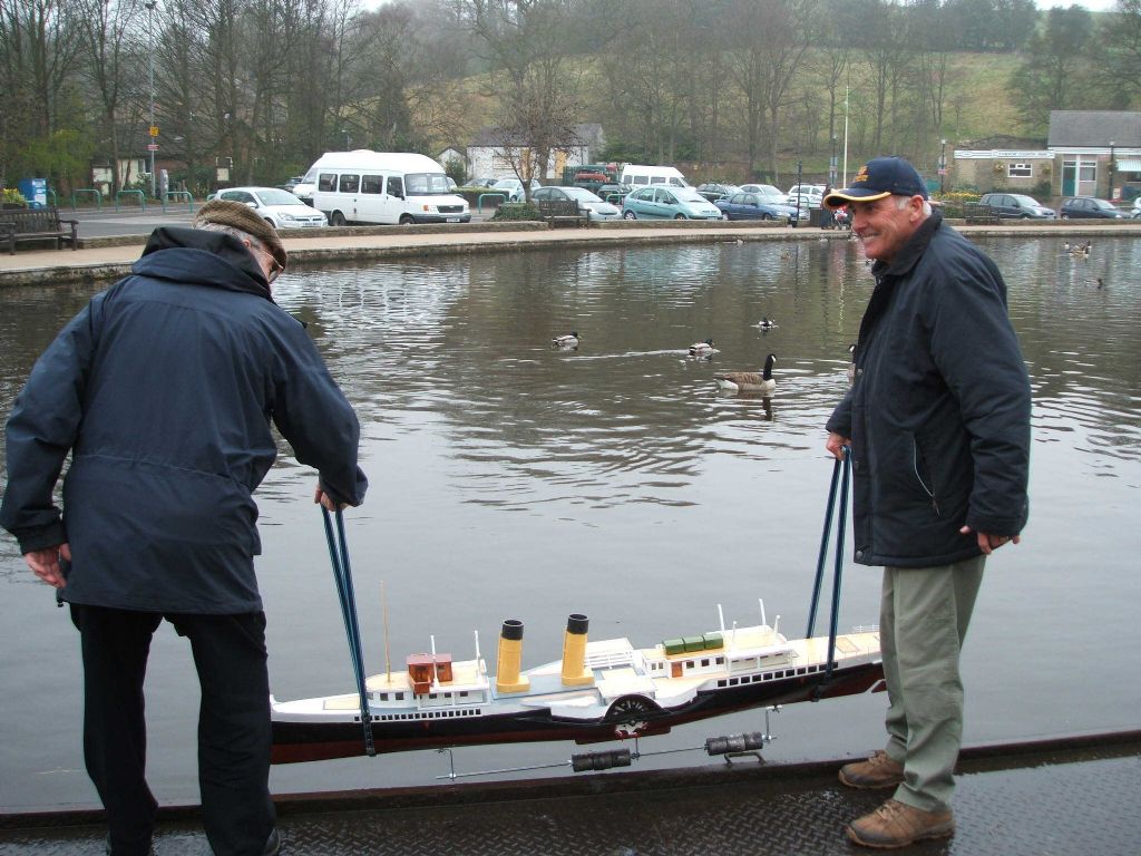

              launching Jeanie Deans
              There you go John, Bob the builder and Duckie launching his Jeanie Deans on a cold winters morning with straps I made from nylon luggage straps, need a bit of lead on the bottom so the straps sink below the boat.
              Cant get a bigger test than that can you!, with all that lead on "Abell keel weight" idea on the bottom of the boat, cant see you launching that any other way.
              Duckie
