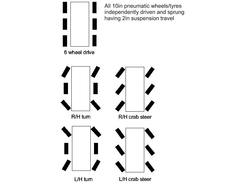

      After a few years of deteriorating ability I am no longer able to carry my large models from car to lakeside and I also struggle to launch and recover them without a slipway.
      So it is finally time to design and build a transport and launching trolley.
      I have had some technical discussions with our forums electronics expert about steering options as I had intended crab steering capabilities.
      As shown below.
      The 10in wheels are usually found on sack trucks
      Another option is to adopt a tank steering system which will be easier on the components but have less finesse when manoeuvring.
      Wheels, angled drives and pillow bearings have been ordered.
      Comments are invited

          Sounds feasible. Maybe even RC using several servos to turn the axles. Left and Right crab steer could come in on extended throw of the Transmitter steering stick or some such. Tank steering would be easier to RC I guess over multiple wheel steering.

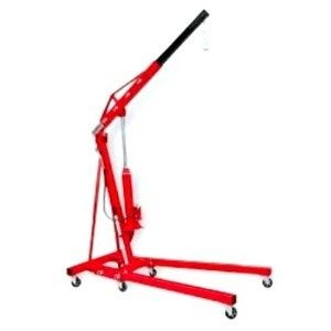

            A small manual Cherry Picker would be ideal?

              Thanks for the youtube clip and the steering ideas, you are right that tank steering would be easier and I would have the option of fitting tracks over the tyres for really tough conditions.

              A small Cherry Picker is not so far from what I have in mind.

                        A Cherry Picker isn't far from what I have in mind in as much as it involves mechanical handling and lifting but the machine wont resemble a Cherry Picker it will actually look more like what we in the building game call a 'flying carpet'.

                                    Cherry picker!! what about the small engine cranes light weight, on wheels, hydraulic, (no power needs), break down into smaller pieces, couple of bolts and it will lift almost any size of model.

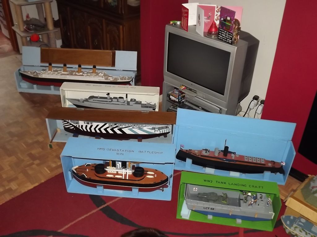

                                        Colin. excellent idea. I would advocate as a first step that the model be housed in a box, with foam style supports instead of solid wood (albeit felt lined).
                                        This enables the model to be easily handled onto a trolley or other wheeled device, and the foam further protects the model from damage by providing cushioning "suspension". It would then enable the box to be securely secured to the trolley whilst in transit from car to pond (not very far at Bushy, and over flat smooth ground)
                                        Straps can be pre-positioned within the box for lifting the boat out, and/or using them in the launching system.
                                        Boxes are such a good idea as they allow, if nothing else, stacking on the floor at home besides providing the best possible transport protection.
                                        Ashley snaps, open sided boxes in this pic since mostly converted to full sided ones

                                          Ashley……Your models look very pretty in their little boxes…….Hardboard construction, I presume?
                                          #58590
                                            I think the green one is, the rest are 5mm mdf, no need to use much else. 4mm ply would be nice I suppose but that much more expensive.
                                            The Hovervan, and projects No1 and 2 have exceptionally large boxes and are 4mm ply (hardboard tops) as the additional strength is required for this much unsupported flatness..
                                            I splash them with coloured emulsion to make them look gorgeous and cover up the shoddy workmanship. They are just boxes, after all. i made that bunch for the film they wre in (for transport) and then a load of boxes for the boats appearing at the MEX show. I didnt want to spend forever making boxes that were works of art.

                                              The garage crane is a nice idea but I fear that it will be to heavy, even if built smaller it still would be quite weighty and then there is the problem of hydraulic operating system.(Its over complicated)

                                              Keeping models in transport boxes is a good point but this machine also has to launch / recover and be a mobile workshop so the model will have to be out of its box.
