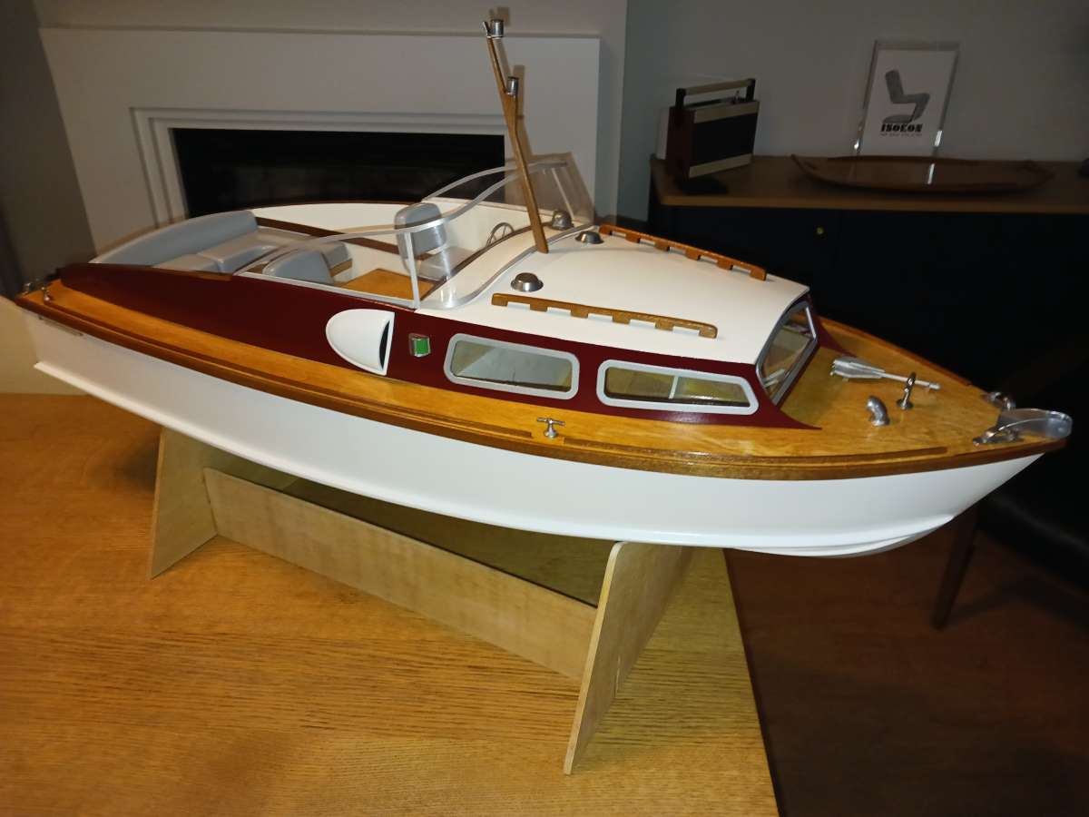

                                        Please Ashley don’t mention that Fairey pulpit rail…been driving me mad trying to get it right! Might have to leave it until I’m in the right frame of mind. Rest of the kit is going well…although the colour scheme is not really traditional. Also it does end up being quite heavy and that’s without the motor and battery yet.
                                        20240116_193459

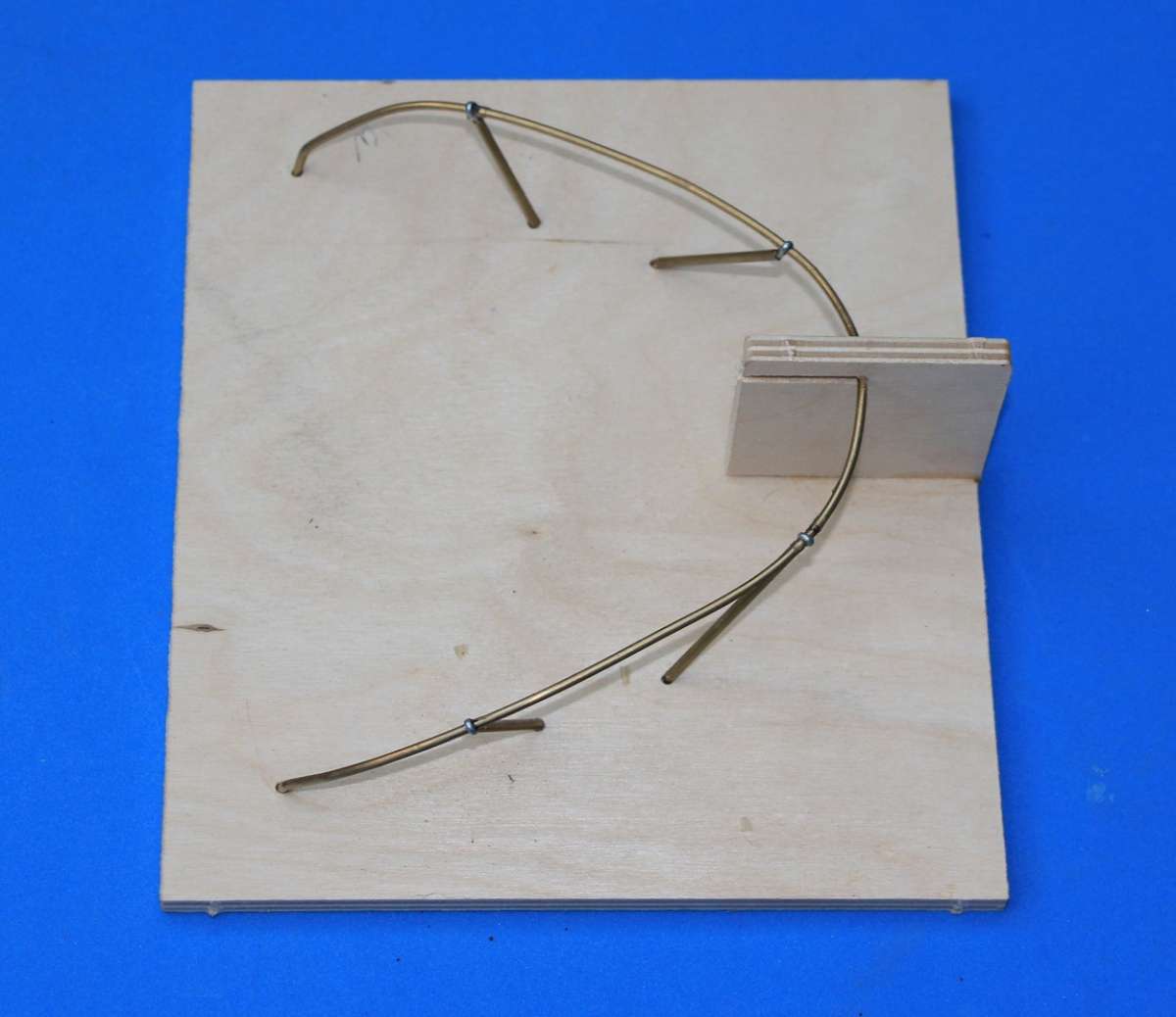

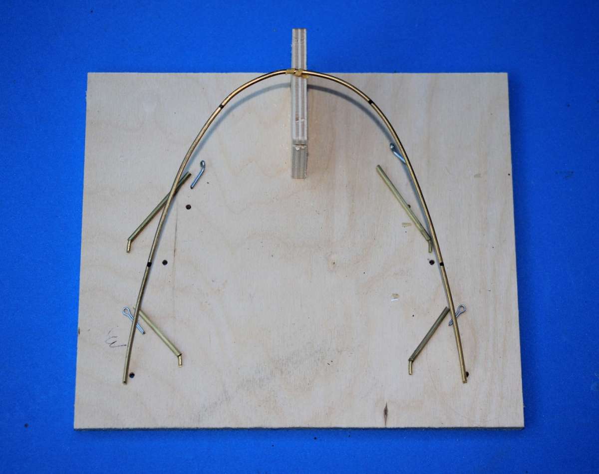

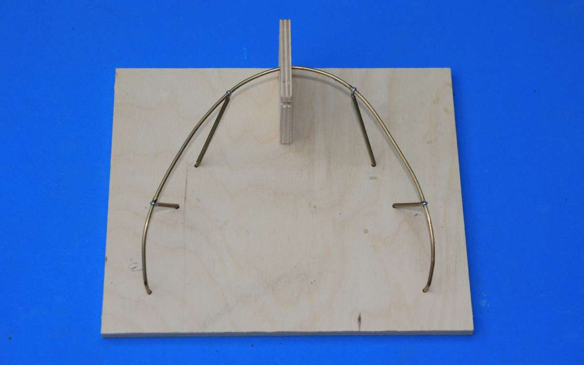

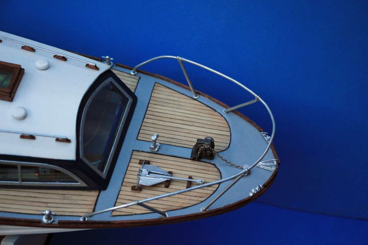

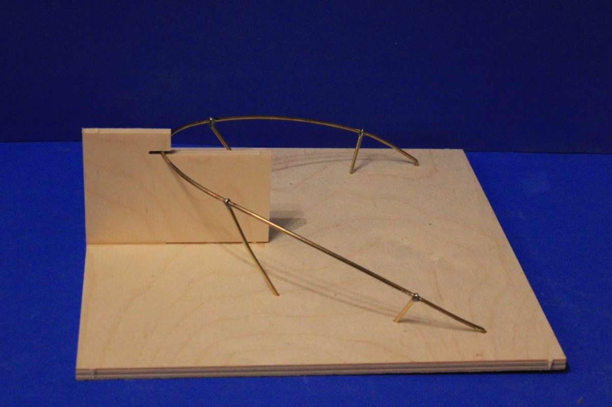

                                          When building my Fairey SLEC kits I cheated with the Pulpit rails as follows:
                                          The only remaining tricky item is the distinctive pulpit rail assembly. An accurate jig and drawing is provided for this but full size practice is to butt weld the supports to the handrail. Ideally this requires silver soldering or brazing on a model as soft soldering is unlikely to be sufficiently robust. As with my Huntsman kit I ‘cheated’ and used thin brass tube with split pins at one end and inserted pins at the other to make the supports as shown in the photo The result is very strong and still looks pretty neat.
                                          (DTR)IMG_2129Pulpit DTR (0)Pulpit DTR (1)Pulpit DTR (2)Pulpit DTR (3)
