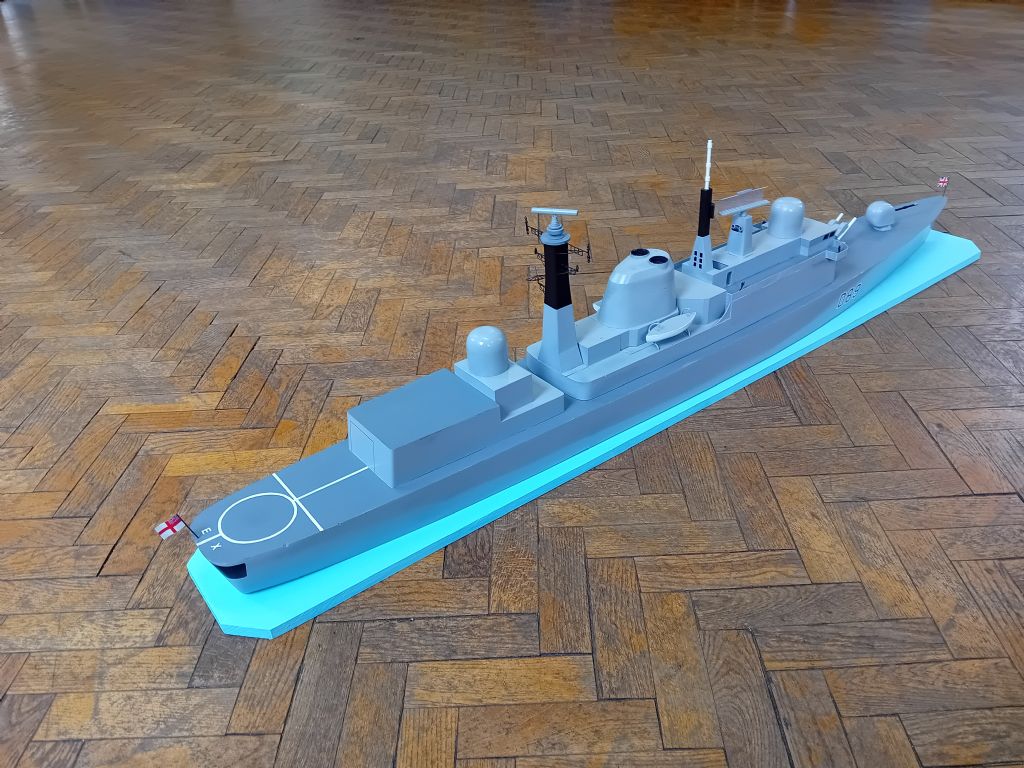

                  The big T42 is almost done. I stuck windows on the bridge bit and drew the quarterdeck cutouts on and painted them black. They are probably a bit small, but they are only for effect.
                  Most pleasingly I managed to paint on quite an acceptable circle on the flight deck, using a compass to draw a concentric circle and then filling in with white paint. After a few adjustments and re-touching with deck grey, it looks ok. The straight lines were easily done with masking tape and went on ok, no retouching required. My spare letters furnished E X for the flight deck marking (for Exeter).
                  Just waiting on RN lettering for the hull pennant numbers.
                  I painted a couple of railway figures as crew, just one on the bridge wing either side. They sort of look a bit small overall, but fit well as regards the solid sides around the bridge walkway. I’ll say it again, figures like this bring a boat to life…even just the two figures are instantly noticeable as soon as you clap eyes on it.
                  It’s a ‘thing’ of mine…figures, and open topped things without a driver/crew..???

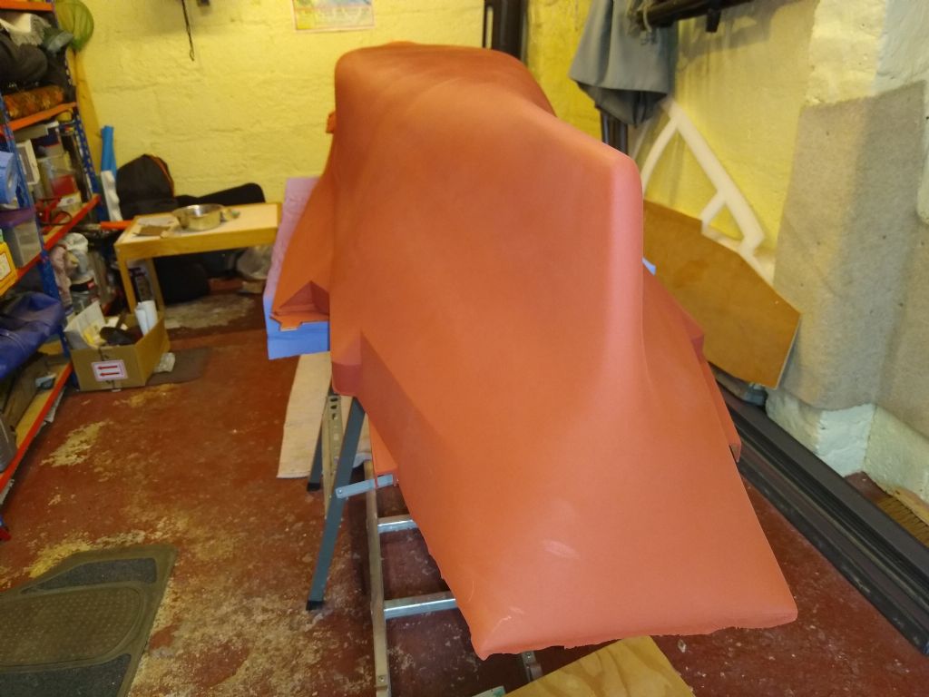

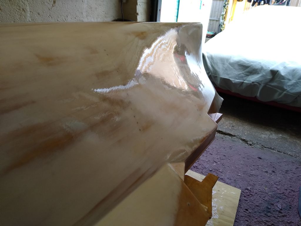

                        I realise I have not made a posting on here in nearly 2 years and whilst I have been to Bushy park only a few times this year, I have tried to get on with some boat building.
                        I realise it was July two years ago when I last posted about the big Ark Royal model I had been working on.
                        After doing some organisation at home to make space to work on it (ie building a car port in early 2022 so I could make garage space), I have got on with filling and shaping the hull, then glass clothed and epoxy-ed it.
                        The hull then looked like this a couple of weeks ago after much sanding an resin coats:

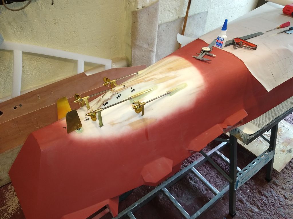

                        Then I primered it up, which covered a lot of the imperfections
                        Now this week I have the prop shafts all fitted, and the A-frames too. What a massive faff they were to line up! Motors in next then it will be ready for a launch and trial run to sort out the ballast and waterline. I want to do that before I get on with any more painting and deck installation – in case anything has to be changed.
                        Its very close to being on the water, I'm not going to think about a date but it will be soon.

                            Delivered the big T42 to the sea cadets and there was no bugger there barring the gangway staff as they were all at a sail handling comp in London!!
                            Took photos on the floor and it looks very nice (no room in my house to get a picture with loads of toot in the background)

                                  Destroyer. Looks very nice and clean and I am glad I didn’t try and add any extras to it. The pictures do not do the size of it justice bearing in mind the “sea” plank is almost 7 feet long!
