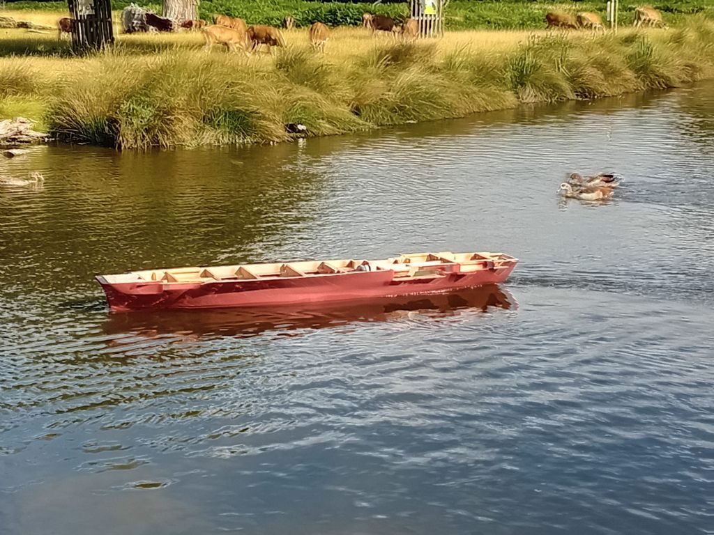

                  Noel is going to make a great job of the carrier, it will look wonderful filled with Phantoms and Buccaneers and a destroyer escort.
                  Despite the length is was remarkably manouveable, not that I had any doubts, as the Diamond also turns very well despite the length.
