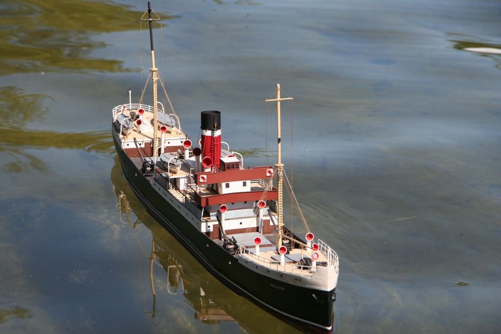

                      There isn't actually much of a gap Bob, see below. Although not intended to be a specific vessel I did base it on some material I found at the time (mid 1970s) and can't recall what it was. As you can see, I opted for cranes as a change from derricks as I discovered that some ships of the period carried them.

                        Having no centre was also becoming more popular in later years, so I would say that from viewing the photograph above, it is quite correct. Also, I see that you have a rounded stern on it, thus moving the ship to a slightly later era when the 'midship hatch was less common I really think that originally, they had the 'midship hatch to separate the engineers from the deck officers, but by the time I went to sea in 1961, we were mostly in the same accommodation block, with everyone getting on well together. I did sail on four ships with the gap, separating engine-room staff from deck staff. I quite liked the centre hatch, not because of the separation, but because it was a pleasant place to be outside in the tropics – a canvas-covered hatch, sheltered from the wind at each end. This is the oldest one I was in with the centre hatch – Richmond Castle, 1944. (Second one up on the right hand side). The one above it, my first ship Rhodesia Star, did not have a gap at all!

                          Bob,
                          There is a reason for the rounded stern!
                          You won't have seen my article in the current issue. I have sent you a copy by email. Let me know if not received.
                          I thought it was an ingenious conversion. Looks like it came out OK from your comments.

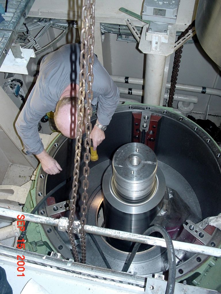

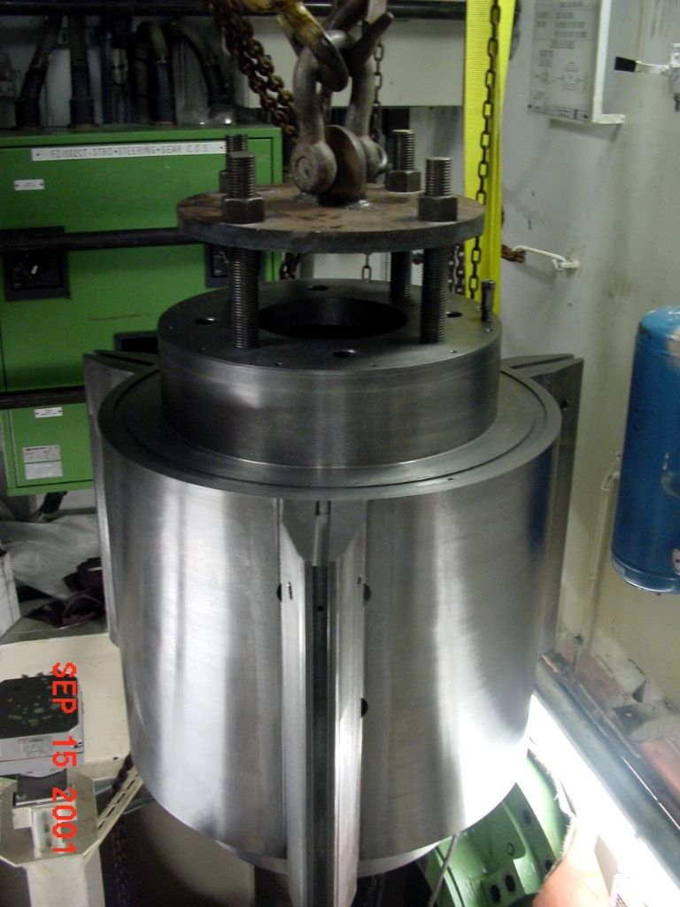

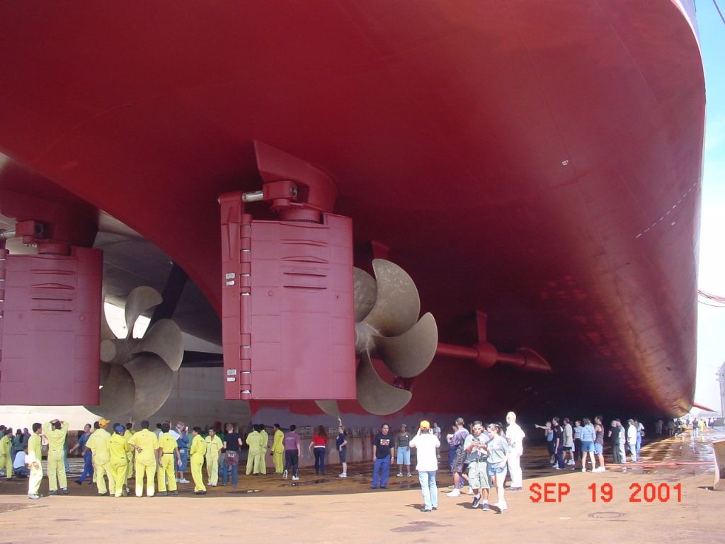

                                      Thanks Bob. If that was along the sides I have always referred to it as "Tumble Home" so would the same term apply around the stern?
                                      Interesting thoughts on steering gear. When I first went to sea most steering gears were of a four ram Hastie type, which was usually quite a substantial piece of kit and took up the whole beam of the ship. For probably about the last 30 years though I have always sailed with rotary vane steering gears, which are infinitely more compact for the same torque so required much smaller steering gear compartments.
                                      As an example the rudders shown here in the first picture were each operated by the rotary vane steering gear in the second and third pictures.  That's actually the top of the rudder stock in the second picture.
