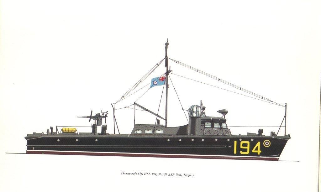

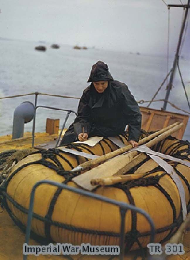

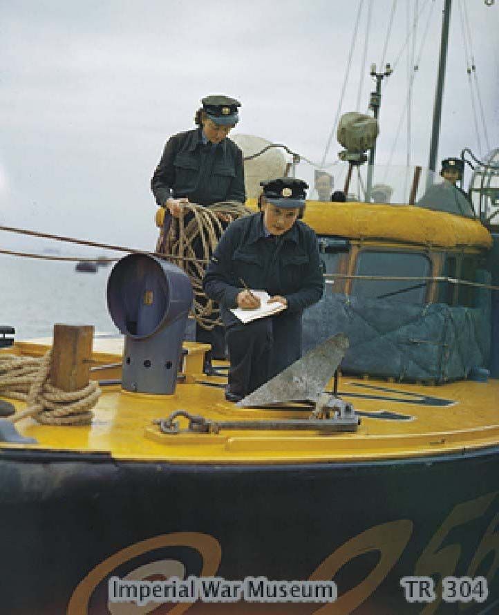

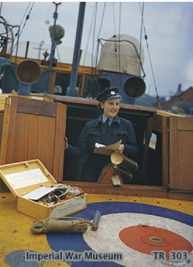

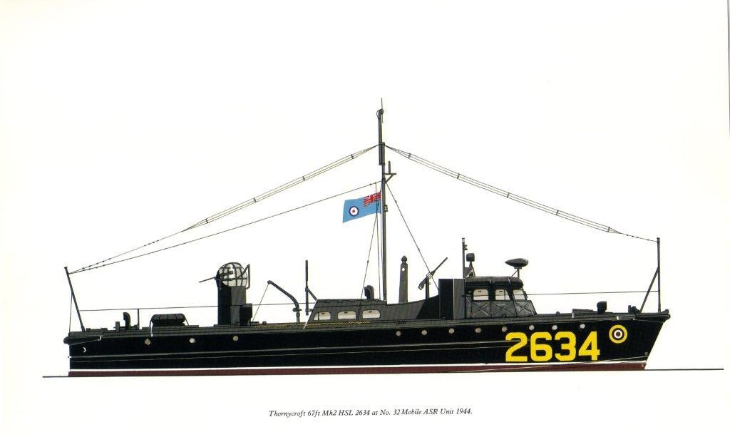

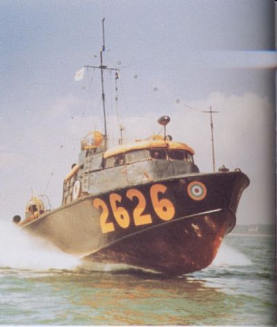

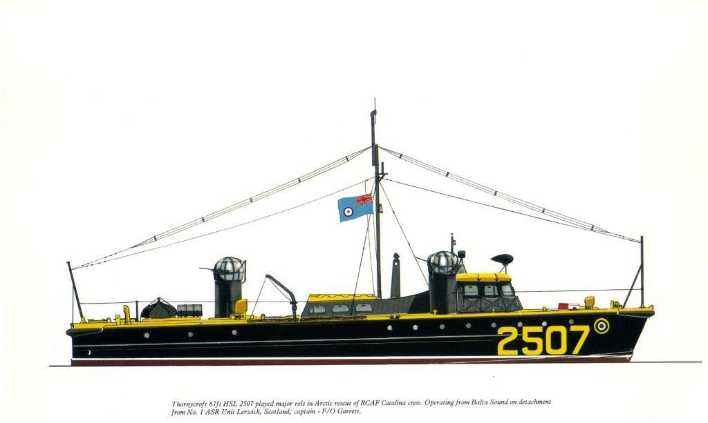

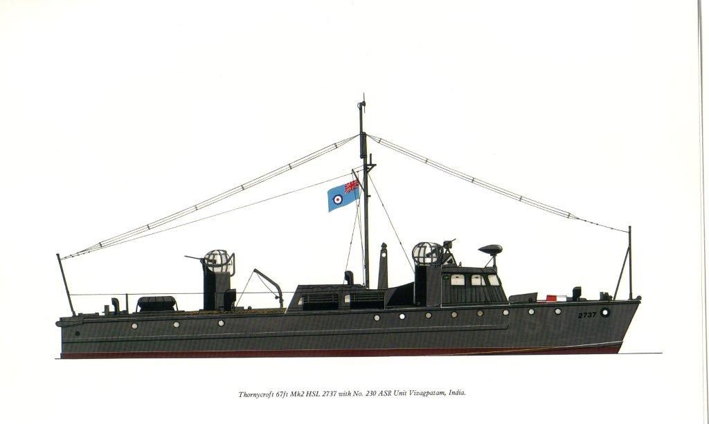

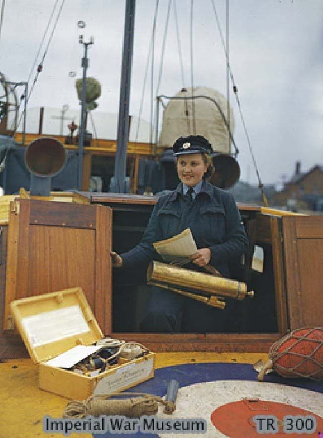

                  John has asked me to help here, in truth he is at least as knowledgeable about this subject as I am but I hope this helps. Firstly visit this page and download Mudway's pdfs and diagrams (register/log in first);
                  This is my model, scratchbuilt at 1/24th;
                  http://www.flickr.com/photos/25721684@N00/8281519230/in/set-72157632269542118/lightbox/
                  Some colour plates from John Pritchard and some snaps from the IWM (note varnished cabin sides);
                  Edited By CDSC123 on 21/10/2013 22:29:25

                    Many, many, thanks, John and CDSC123, for your help and the terrific pictures. And you have given me a path which I can now follow myself. John, I think the plan I am using is the 1982 one, but without the building notes etc. and it came from a Luton Club member who answered my search for a compact version of an RAF asr boat -any type, any builder – so if I can get hold of a copy of the Model Boats issue, it would be useful.. However, I cannot claim I will build mine to the Exhibition standard of your boat, or those many boats sent on CDSC123's links – fantastic!, but I just want something which looks and goes right on our pond, and obviously colour is important. I can see that I will reluctantly have to paint my carefully planked and caulked balsa deck – but perhaps not yellow! Whose idea was that, in Wartime?!
