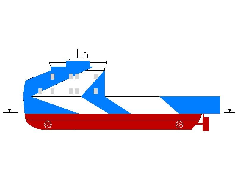

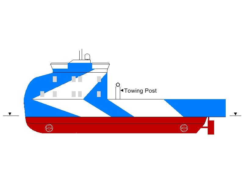

              Here is a picky
              I was coerced into designing a vessel for towing and steering events and after a little research I have worked up a basic design.
              It will have two 'big' 12v motors pushing 60mm 5 blade propellers, kortz nozzles will provide the steering and to aid manoeuvrability it will have thrusters front and rear.
              As a towing tug it need plenty of mass so it will be heavy and sit low in the water.
              The tow hitch will be just rear of the superstructure and its supporting structure will be cast into the keel and frames so that when it pull the load will be spread throughout the entire hull.
              As the design develops I will update you with modifications and progress reports.

                Paul. This is one of those funny parrot nosed fronts , isnt it? Love the shape and colour scheme!
                The thrusters need to be stonking items. Stock or inventive home design? Those pumps that DM found as suggestions for the bait boat would be nifty items to have. Need two probly as non-reversing. Two of Bobs snazzy articulated rudders might obviate the need for a thruster at the rear end??
                Thinking about it, a nozzle such as found on the front of an API88 Hovercraft would be sexy to have at the front using a DM pump  . wow. Exciting!

                  Hi Ashley
                  It is a variant of the parrot nosed rig supply vessels but the bow has been altered to an icebreaker profile and the hull has been lengthened and widened to increase displacement.
                  As I want the model to crab steer it will need the four thrusters for which I am looking at using the pumps that DM suggested.

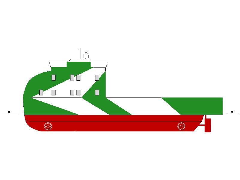

                        Or it could be blue
                        ps Gareth if it is glue then it must be 40% proof

                                It's still blue. Is it pining for the fjords? I think I prefer the Mk1 conk for looks.
                                #47273
                                  Yes, with DM there, the Mk1 conk is nicer (in my opinion)

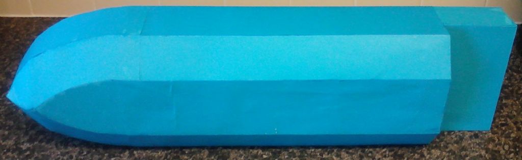

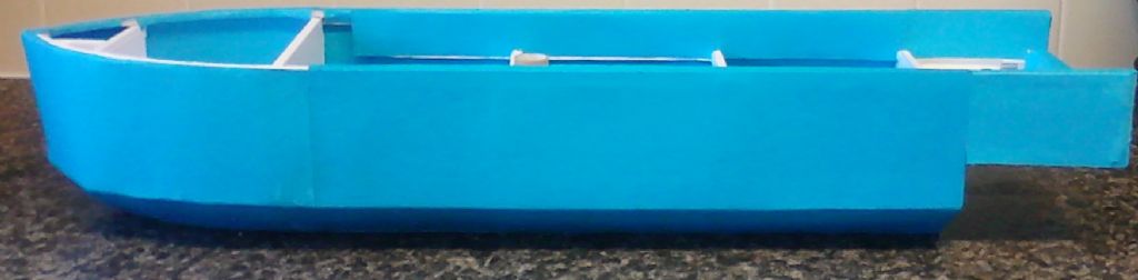

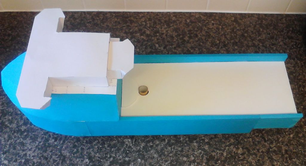

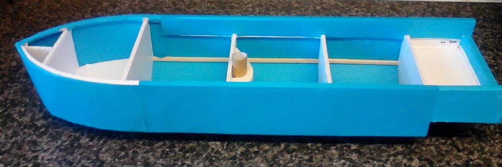

                                    I am still playing around with the design and progress is fairly basic but the evolving card model gives you a good idea.
                                    This general view shows the layout of the frames and the reinforced tow connection.
                                    This side view shows the blunt bow and overall shape of the hull.
                                    The view from underneath shows the flat bottom and hull shape.

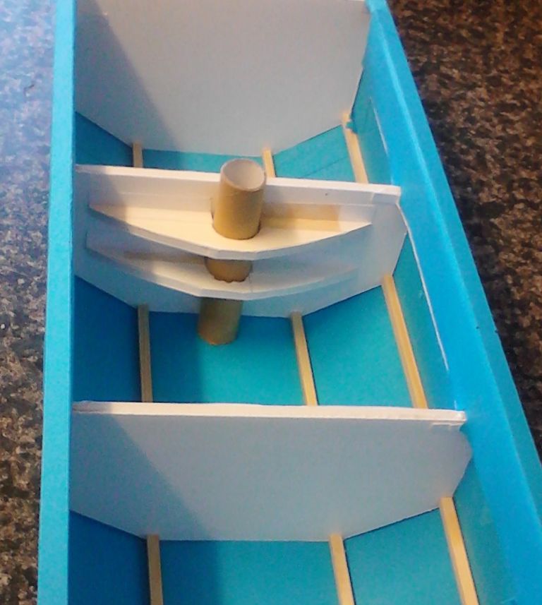

                                    A close up view of the tow support which is basically an 18mm the supports of which spread across the entire frame. For towing an 18mm dia post is placed into the tube and the towing line fixed to the top of the post, with this system the point load weight of the tow is spread across the entire width of the hull.

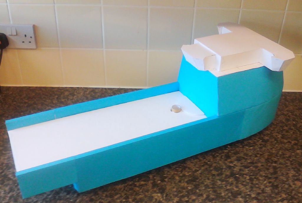

                                    #47302
                                      A few more progress photos showing the superstructure and basic bridge assembly.

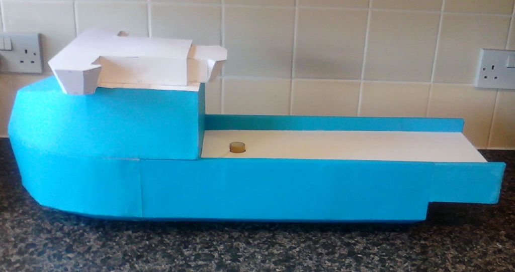

                                      This image shows the side elevation, the sleeve for the main towing post can be seen just rear of the superstructure.
                                      This shot shows a close up of the bow and gives a good impression of the shapes that the finished model might use but I am still unsure about the length of the bridge wing oversail and it is very likely that this detail will change when I move onto building the timber prototype.
                                      Another view showing the towing sleeve, theoretically positioning the tow hitch at the central point of the models mass should give the best results

                                        I do believe the correct name for the towing sleeve, is a ……."Samson Post"

                                          I have misplaced my metre rule but the model is 800mm long (31inch) a good help might be the 6×6 wall tiles behind the model.
                                          It doesn't look very professional at the moment as I am just playing around with the design and the card soon gets messed up.

                                                Paul. Just a few observations and questions, please feel free to dismiss at first glance.
                                                Should the bridge wings only be sticky out as far as the sides? or do they overhang on this sort of ship.?
                                                The front is blunter than I thought a parrot nosed ship would be.
                                                The bow underwater section appears to be fairly conventional. Bulbous bow? Ram (style) bow<for the parrot nose look?>
                                                re towing post. Obviously you will be designing the rear end so as to not snag the tow-rope? And is the height above water of the Simpson post (paint it yellow) a factor?
