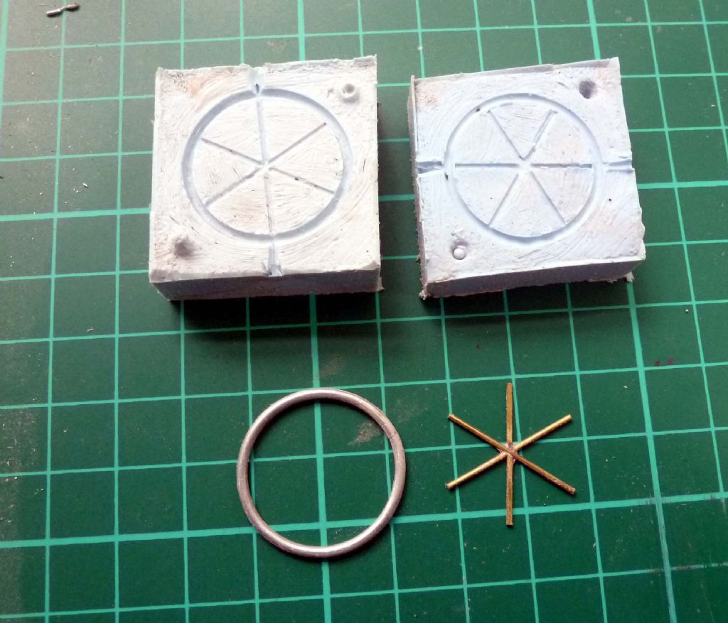

            wheel 02a.jpgDave
            This probably won't be much use to you because of the very small size wheel you need, but it might help someone else and maybe give you an idea for another different method.
            The one on Huntress is 25mm OD. I first bent some ali tubing around a former and joined the two ends with a wire insert and epoxy. I cut and soldered together six pieces of brass wire as the spokes. I then made a 2-part silicon-rubber mould, using the wheel rim and spokes as patterns. I cut some new spokes, lay them into one half of the mould and closed it up with the other half. Casting resin was introduced with a syringe via the small channels I'd made and the completed rim and spokes removed when set. The hub was made from styrene circles epoxied each side of the spokes. Like I said, a perfect swine and I wish I'd made it a little larger now. Maybe the next one?

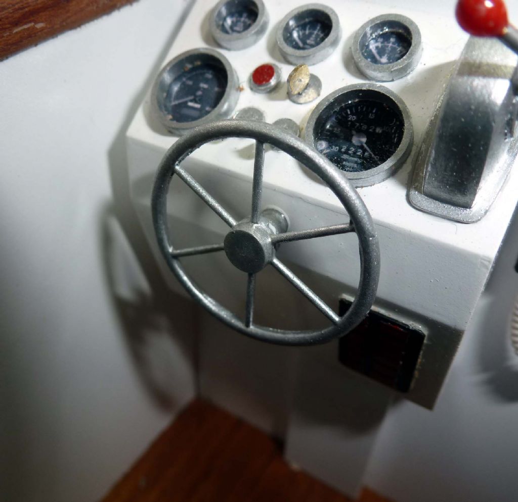

              Thanks Dave , Thats a great help , You have confirmed there no easy way around this so i will use your method , I could not help clocking your dials , they look great i could not find smaller than 7mm , what size are yours and were can i get them .

                The dials were copied, pasted and scaled from a manufacturer's catalogue using Photoshop and CorelDraw, then printed onto inkjet decal paper and fixed to the dashboard. The bezels are slices of plastic tubing – walls are too thick, but it'll do until I find something better. I can't remember the sizes but the wheel is 25mm across, so you can get a pretty good idea from that.

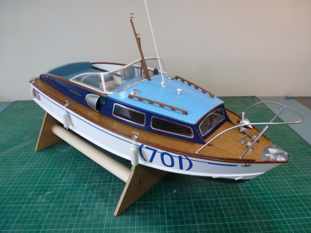

                  Ladies and gentlemen
                  Meet "Maid of Balamory". More photos in my Huntress album.
                  #65056
                    Excellent Job Dave, really nice, it could almost be full size and will look it on the pond. I love the tip up seats to access the cabin etc. Very ingenious.
                    I was looking at the Huntress in Portsmouth Dockyard a week ago and was struck by how wide the boat is compared to its length, the cockpit is huge. It's so much more attractive that the modern white plastic bathtubs that are all you see today.
