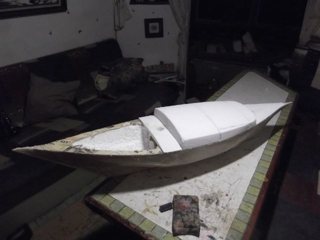

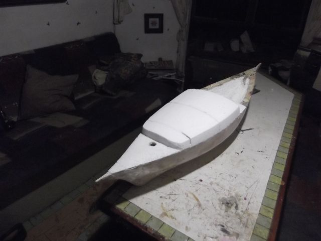

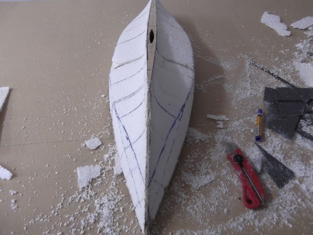

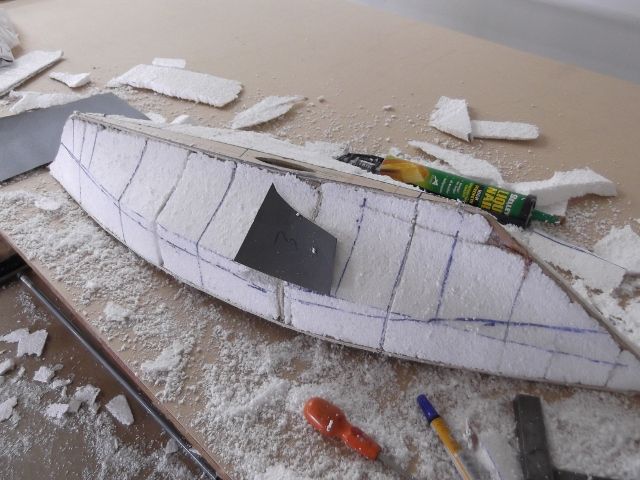

                A little more progress. The frame work is filled in with blocks of polystyrene, and carved to shape. Useing the midship to set the hull shape, I carved the hull as hard chine form. By useing the chine shape, all the other sections are faired in automatically. The "correct" chine profile for a displacement hull is for the chine to cross the stem at, or just below the waterline, then slope down and aft in a straight line for 1/3 its length before curving gently back up and crossing the waterline well forward of the transom and ending on the transom (or stern post) well a bove the waterline. The water line is then used to check the hull's fairness. These hulls have no hollow in the forward waterlines, and a fair amount of hollow in the aft waterlines. The buttocks are long and easy, Combined with a hollow garboard and high bildge, this should produce a fast sailer.
                Once happy I shaped the other side, useing card templates placed in vertical cuts on the station lines.
                The chines will then be faceted to a multi chine , then rounded off to end up with a round bildge hull.

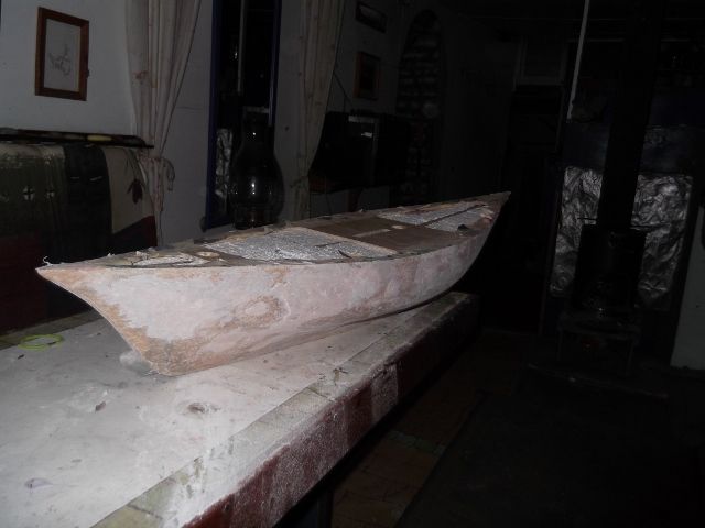

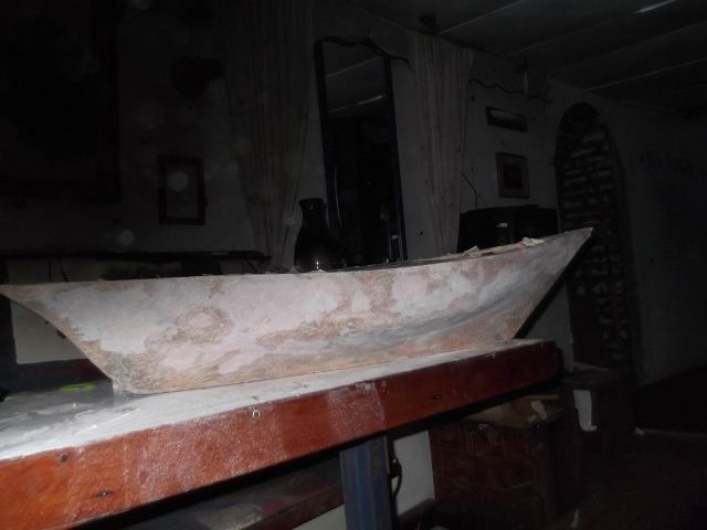

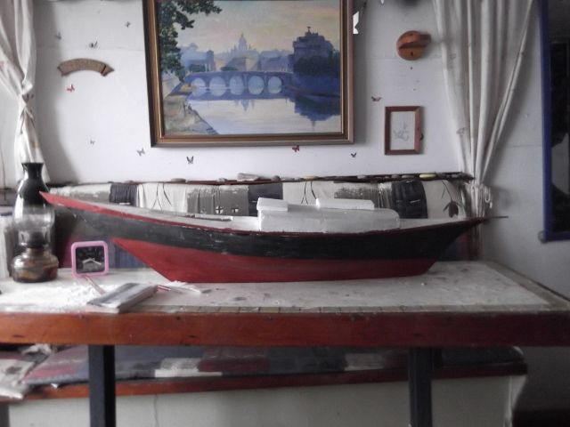

                        Well I'm actually a little embrassed to give this next installment, two steps forward and one backwards I'm afraid. The shaping was finnished on the hull, photos taken, then accidentally deleted!crook On my other two models the hull was skined by sliding it inside the leg of one of my old pantyhose, then coating with expoxy. This wasn't going to work this time, as 1) to many hollows in the sections, 2) my legs aren't that big! Instead I cut a bit of old bed sheet, on the bias, to make it drape properly. This would have been just fine if I had used epoxy.
                        I need to digress just a little here. I have a good freind, Lynn, who is a bit of a tinkerer, (and general nut case ). She is for ever coming up with experiments, many of which don't work, and the odd one that does. These polystyrene models produce a lot of waste, so I gave Lynn a bag full back when I was building Annalisa, to see what she could do with it. She came back with a jar of syrup which she assured me was strong, water proof glue, (it was) and a jar of paste (filler). I tried the glue and found that it set up as hard as epoxy, and as I had run out of epoxy, it got me thinking. I figured if I could protect the polystyrene from being dissolved by the glue, I could use it to glue the cloth on. So I covered the hull with two layers of newspaper glued on with acrylic paint. The glue she provided was a little too thick, so I asked her what solvent the polystrene was disolved in. It turned out to be a combination of acetone and petrol! (It needs both to disolve properly, the more the acetone the better the glue, 5:1 works best, though 1:1 is ok) So I thinned the glue down and glued on my cloth. Well… obviously I thinned it down too much, and it got through to the polystyrene and my once fair hull was fair no more!angry Not a complete disaster, though a fair bit of filling required. I mixed a fresh, thicker batch for the other side, and that worked out much better! Here are some photos of the hull prior to finnal filling and sanding

                            Bob, I didn't think to plank the polystyrene in timber, would have been a good way to go, and saved me alot of filling and sanding too! Next time.

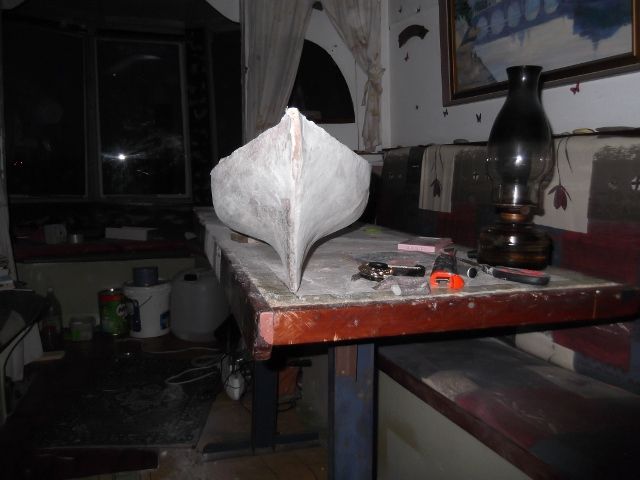

                            The hull is very nearly there now, just a final sand and paint, progress! Between filling sesions I made a start on the sails. I've opted to use polyester thermal curtain linening. Sounds strange I confess, but the polyster weave is strong and low stretch, and the (latex?) backing fills the weave and makes it air tight. I once made a set of sails for a full sized (20' cabin yacht from a much heavier grade of the same stuff, they worked out very well indeed.

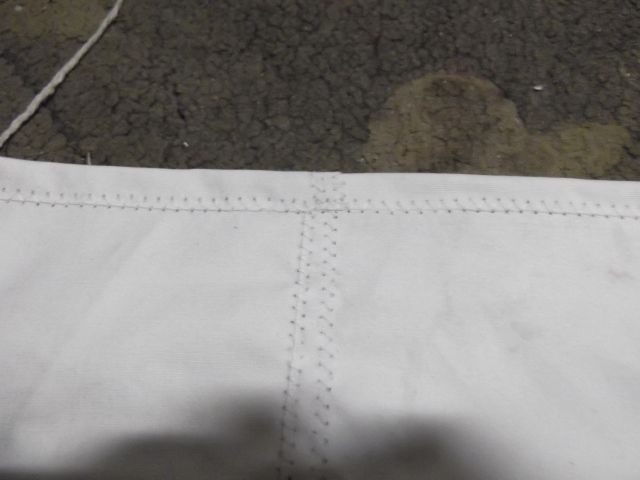

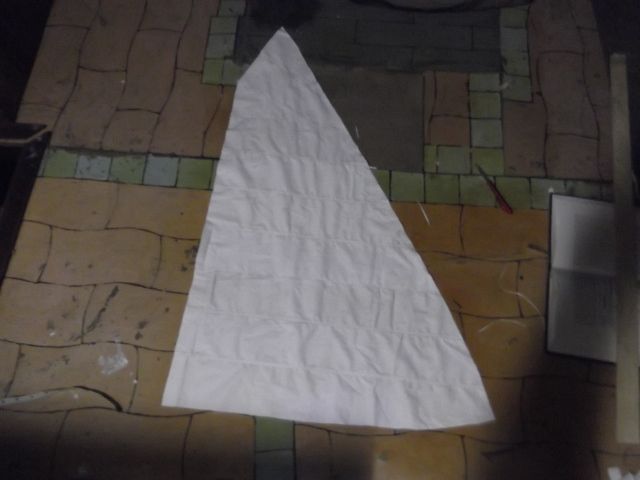

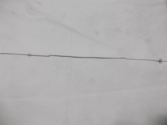

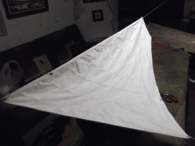

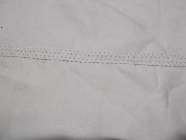

                            Here's my sail making process, fairly traditional. Because one side of the cloth I'm using is noticably different to the other, I decided to make the sail up from 4" strips, alternating sides. I laid the strips up and drew on the 'strike up' marks, every 11/2" or so.
                            By sewing up the strips, linning the marks up exactly the pannels are joinned up with out shape or tight spots. The seems were made over width and sewn down one edge, 'one on one off'. The seam is then trimmed down and the other side stitched

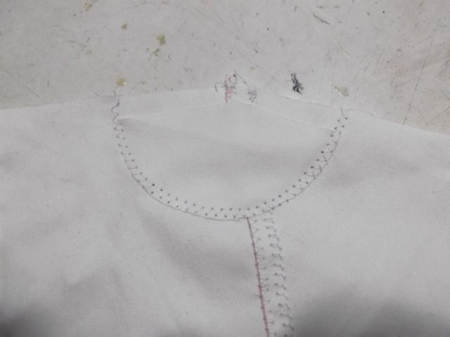

                              The hull has had the cut water and rudder post added, and is now ready for a coat of paint, and the mains'l is finnished. Here is the rest of the procedure.
                              Half circles are cut for the patches, and sewn on

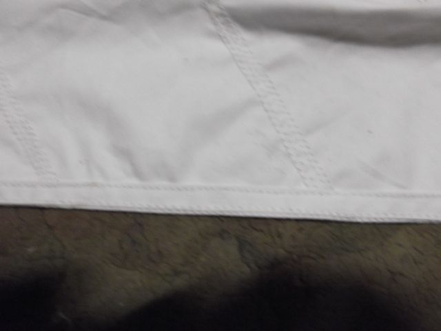

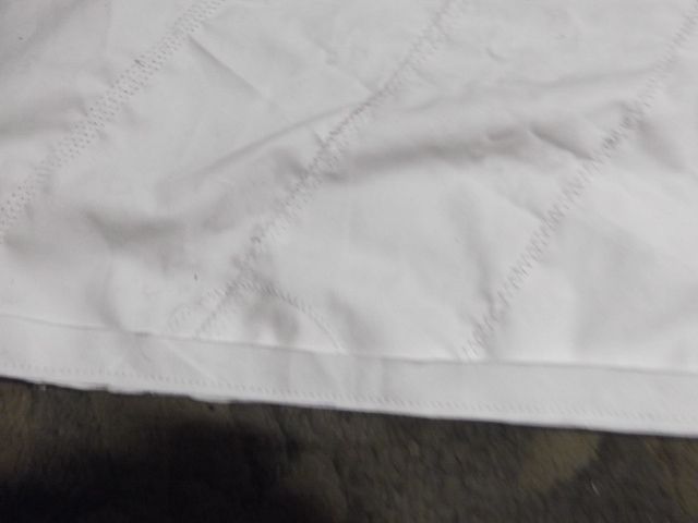

                              and the tablings added. These are a 1/2" wide strip, cut paralell with the weave, so they have very little stretch. The sail is turned over and the liff tabling stitched on, right on the very edge, pulling the tabling tight, and feeding the sail in loose. Done this way, when the luff is pulled tight and straight, the curve cut in the sail luff is pushed back into the sail, giving it it's shape. This removes the need to hand stitch on a bolt rope, tucking in a little sail with each stitch, to achieve the same result.
                              The tabling is then folded over onto the other side of the sail and stitched down

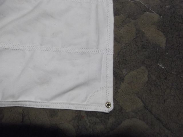

                              The foot is done the same way. The leach is just a single fold, zig zaged down
                              eyelets put in
                              And the sail string up to check all is well..

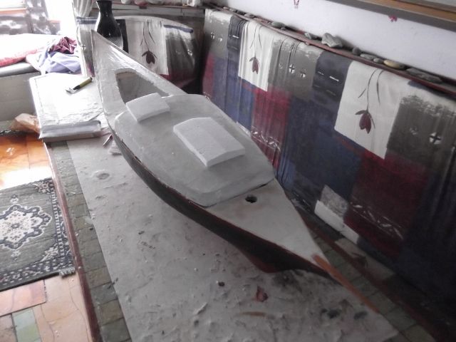

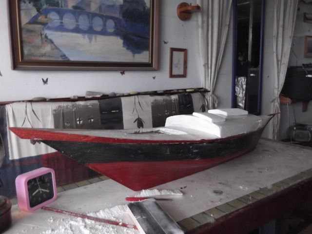

                                    Well, slow progress, I'm afraid, lucky to get a couple of hours a week on the boat. The joys of a young family, and all that.
                                    The mains'l and fores'l are done, and the cabin and deck carved out, ready for skinning.

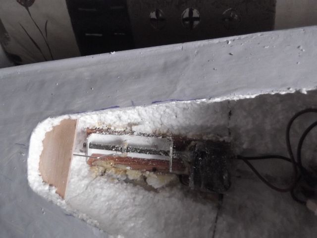

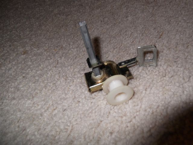

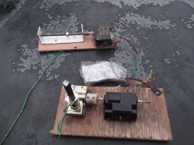

                                    I was chatting to Lynn about a sail winch, I had planned to use the toy car drive motor , turning a length of threaded rod, with a carriage running along it, but she delved into her junk box and came up with this.
                                    It's a worm drive gear box from a discarded vanetian blind. The sheet drum will go on the steel shaft (with some sort of end suport) and the toy car drive motor and gear box will conect to the white plastic drum. Hmmm, should work.. You think? (whould certainly be a lot more compact)

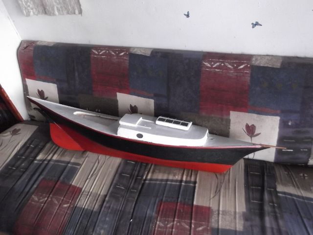

                                          The sail and rudder servos are done. The sail winch as worked out ok, is fairly quick and happily lifts 2 1/2 lbs, which should be plenty. Due to the extreme rake of the rudder post, and the fact the rudder servo is not self centering, I thought that a slow rate of travel whould be usefull, so I used the motor and gear box from a defunct servo, to drive the threaded rod. Very powerful, but I suspect it may be too slow. I shall try it and see first though.
                                          A rough coat of paint on the hull, just to check the colour scheme, will probably make the red a bit brighter. I decided to give her a pinky style stern, just for fun. (Some tancooks did, some didn't) Was tempted to go whole hog on the clipper bow (knight heads and trail boards) but think I might follow tradition and keep the bow bald.
                                          Once done the cabin will be fixed on, and acess will be through the removeable skylight, big enough to get my hand in. (The advantage of small hands!)

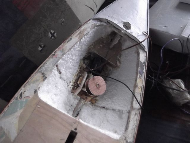

                                            Well, it's wet and windy, and I'm stuck in bed with a cold, so now seems a good time for an update!

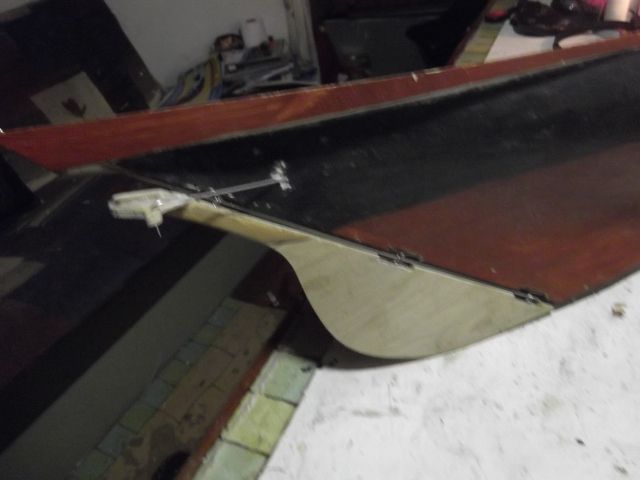

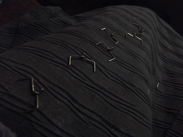

                                            Rudder gudgeons bent up from 1mm s/s rod. these will be glued into cut outs in the rudder and rudder post, and a length of rod slipped in as a long pin.
                                            The sail winch and steering servo is in
                                            (plenty of room in there)
                                            #43032
                                            Amy jane September
                                              @amyjaneseptember49770
                                              rudder set up.
                                              The extreme rake of the rudder post made for a tricky push rod set up, all sorts of difficult angles. (Definatly a case where a proper servo, right aft at deck level would have been a lot better!) Seems to work ok though, on dry land at least!
