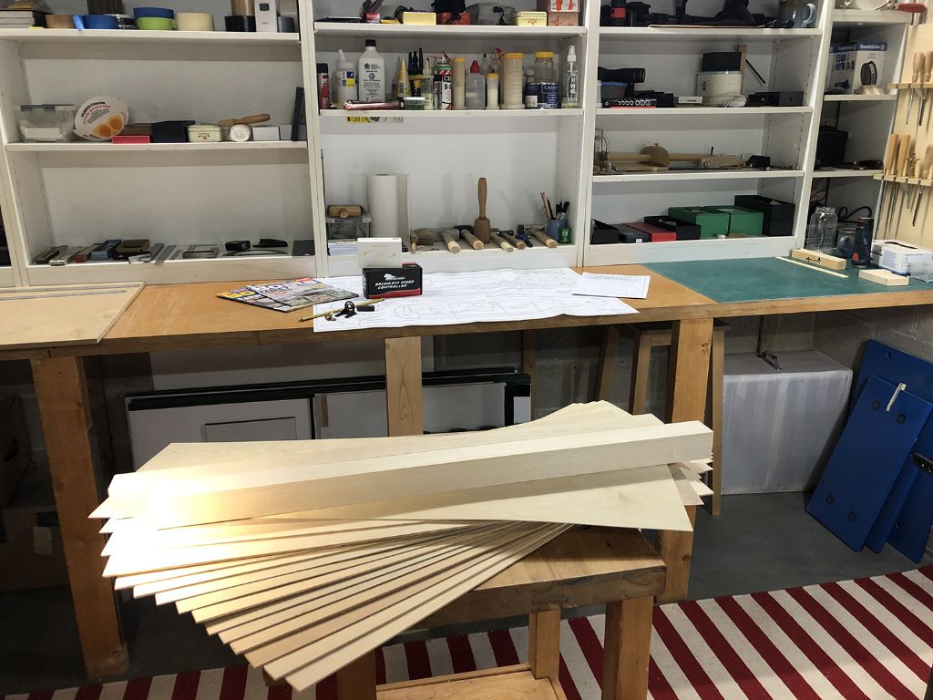

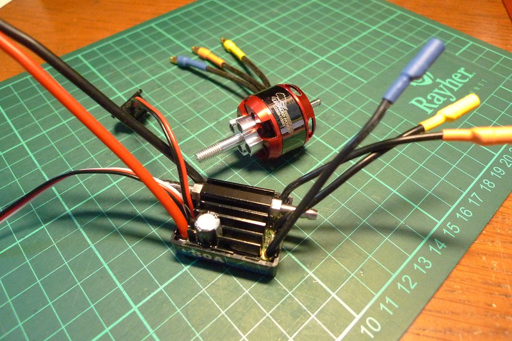

                              Anyway, delightful asides aside, today I took delivery of a nice, hefty parcel from Slec, with a goodish bundle of ply, liteply and some block balsa wood …
                              I hope it goes without saying that it is not all intended for this build – it's just that I though I might as well replenish my stock of of these materials while I was at it.

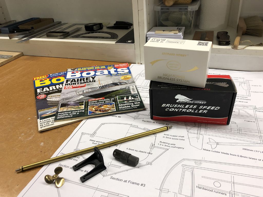

                              I already have most of the drive train, in the form of a brushless motor with corresponding ESC, a motor mount, a bronze propeller from Protean Designs, a propshaft and an SHG flexible coupling, all of which I bought at the IMBS back in November 2017 …
                              Before I actually start doing all that much in the way of building, I shall want to complete this with some LiPo:s, a r/x for my radio and a steering servo and rudder linkage. I will also need to check my stock of silicon wire, Dean type connectors, and other such stuff, although I think I'm good to go for most of those.
                              And if I'm going to use LiPo:s, I should probably get one of those low voltage alarms as well?!
                              Oh, and some glass fibre cloth and Z-Poxy resin, too!

                                At this stage of my pre-build collection of bits and bobs, I would very much like to ask for a spot of advice on a couple of LiPo-related matters, before I send an order off to Component-Shop.
                                As already mentioned, I picked up a motor (Leopard LC2826 1150 Kv) and corresponding ESC (Leopard Marine V3 30A) back in the autumn of 2017, specifically with this build in mind.
                                Based on Dave Milbourns article in MB (January and february 2016), I am now planning to add the following:
                                • Giant Power 11.1V (3S) 2600mAh 35C/70C LiPo (**LINK**);
                                • In-line low voltage alarm w. Deans connectors (**LINK**);
                                • LiPo Battery Fireproof Bag (Large) (**LINK**);
                                • ACTion P106 In-Line Power Switch (**LINK**) and a small toggle switch;
                                • Leopard Program Card for RC Boats Brushless Speeed Controller (**LINK**)
                                • Some lengths of black and red silicon wire in various AWG (for use on this project but also to stock up).
                                My first question is thus if anyone has any comments on or suggestions for improving on this list?
                                As this is my very first brush (ha!) with brushless and even more the first time I even consider using a LiPo battery, I will admit to being slightly apprehensive, given all the dire warnings surrounding said LiPo:s. It is not so much that I fear being unable to understand how to handle them, but more that it seems that they are more likely to suffer from neglect, and should be charged/discharged/balanced about once a month?!
                                Now, I know from my experience with Pb and NiMh batteries that I'm not all that great when it comes to remembering to give them their TLC sessions, but with those chemistries at least the worst that'll happen is that they become tired enough of life that I lose my investment, and have to buy a new one.
                                The thing is that what with all my other hobbies and interests and work and life in general, I don't tend to get to the pond all that often, even during the season, so am unlikely to be reminded about cycling batteries through frequency of actual use.
                                My second question is thus how sensitive you have found LiPo:s to be to neglect? Will they just cease working properly if I forget to cycle them every month or so? Or will they become dangerous, either to continue to store or (even more so) to use again?

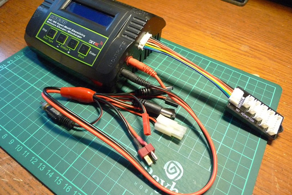

                                Finally, as far as I can figure out, my current charger (a SkyRC e6650) should be fully capable of handling all the necessary charging/discharging/balancing of the kind of LiPo pack mentioned above.
                                My third question is thus whether I'm right in thinking that I don't need to get another charger?
                                Warmest thanks in advance
                                Mattias
                                #86788
                                  @timrowe83142
                                  Hi Banjoman
                                  In reverse order.
                                  Your battery charger is fine. I have the same one myself and find it great for all the battery chemistries and easy to use.
                                  I have some electric model aircraft and the batteries get little use or treat due to lack of time and opportunity. Recently I tested some and found they worked OK. I would anticipate some loss of capacity and I would be cautious about using them in a high value model or a precious one. I wouldn't have the same concern in a boat. And no, so far none of them have exploded!
                                  Your list looks fine but I have ditched my LiPo charging bags and used the material for other purposes having seen some Youtube footage of their effectiveness.
                                  I am not an expert – just my experiences.

                                  #86790
                                    Hi Mattias,
                                    I would back up Tim's comments about lipos they need respect, but I've been flying with them for about 10 years, my observation is leave them charged, and keep an eye on the cells venting the plastic casing starts to inflate slightly, they are still usable. I use the 11.1 volts 3 cell 2200mh, they don't have a long life compared to a nicad packs in my experience.
                                    My cheap and cheerful balanced charger has a separate light for each cell and you can see if one of them has failed which is useful 😀

                                        #86793
                                          Mattias
                                          That LiPo pack looks to be just the ticket. I think it’s the same type and size that I used in the prototype Huntsman.
                                          The V3 Marine ESC you’ve bought has an automatic voltage cut-off which you can program if required. I left mine at the default value which is 3.2v/cell. That being the case I don’t use an inline voltage alarm with this type of ESC although I do have a separate voltage tester. Battery Status Checker
                                          The programming card isn’t vital but I bought one and find it much easier to use than relying on bleeps and flashes as you fiddle about with the throttle stick.
                                          The ESC has a small switch which turns the receiver on and off. I leave the LiPo disconnected until it comes to the point of sailing, at which time I plug it in and use the switch to activate the radio – after turning on the Tx, of course! I don’t think the P106 has been produced for a long time, although I have several and use them with my other choice of brushless ESC [Fusion Hawk]. If you decide that you really want one then let me know and I'll see what's in the magic toy-box.
                                          I’m also a bit of a lazy beggar and I don’t have a routine for maintaining my LiPo packs. To be honest none of them has been recharged since its last use, which was last year! I do store them in the fireproof bag and they all seem to maintain their nominal voltage. Maybe I'll check them again later today….
                                          The charger is specifically designed for several different Lithium battery chemistries SkyRC Charger and so you don't need a different type
                                          Hope that answers your questions.

                                              #86797
                                                @timcooper90034
                                                Matthias
                                                I recently tried to program a similar Esc by the same manufacturer without the programming card. I thought that the card I had would be ok .
                                                After several hours counting bleepsI gave up and bought the appropriate card, it seemed I needed a car or ground card for this Esc.
                                                After 2 minutes it was programmed and working just as it should.
                                                So unless with your musical background your better at counting bleeps I would get a card.
                                                Tim

                                                  #86799
                                                    Mattias
                                                    I've never got any of my LiPo packs down to the state of discharge where a cut-out might become active so I can't comment on what exactly happens with that one. That said, I wouldn't trust my own senses to detect either a warning beep or an LED so I have to trust to automatic gizmos.
                                                    Anyroad up, m'duck – it's not slim young folk like you who need either belts or braces; it's fat old b*****s like me!
