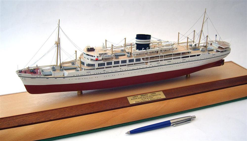

            I often build models around the fourteen inch long size. Never having been much good at painting, or using an airbrush, I find that aerosol car sprays from Halford's UK are very good quality and easy to use. It does require careful masking off with paper masking tape. Here is spray job of red oxide primer for the underwater part of my passenger liner Kenya. It gives a real good finish. Usually when I describe my methods, the answer is "I could never do that!" surprise but that is what I do, and it really is not all that difficult (unless you convince yourself otherwise).
            Edited By Bob Wilson on 23/01/2018 07:48:07

              Thanks Bob and Mattias,
              I considered using aerosol paints for the hull but could not source them from two of the largest hobby shops near to me.
              I do like the model you Bob have built.
