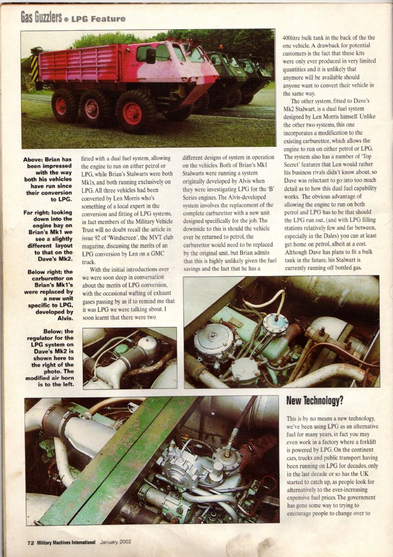

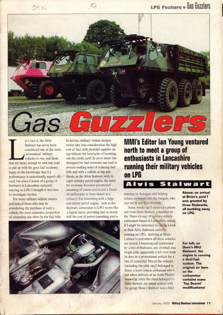

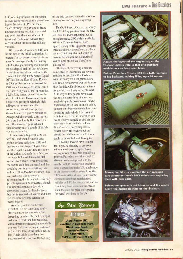

                        stolly006.jpgstolly007.jpgHi Ashley,
                        Very nice model and very unexpected in model boats.
                        They are pigs to drive on the road and not much better in water! All the wheel hubs should have a white line across them. When they are not in line or at least all pointing in the same direction it's telling you that the transmission is binding up (there are no diffs) and you need to bump the thing on a kerb to get rid of the twist.
                        When the MOD sold them off they disabled the swimming gear. They were well dangerous in the water. However my mate has a full blown swimmer and each year it takes invalid children on a sailing trip around a local reservoir.
                        I know all this because in a past life I used to convert vehicles to run on LPG and did quite a few stollys. They do 4mpg on petrol so you can see the attraction. The pics that follow are from an article in 2002 Military machines.
