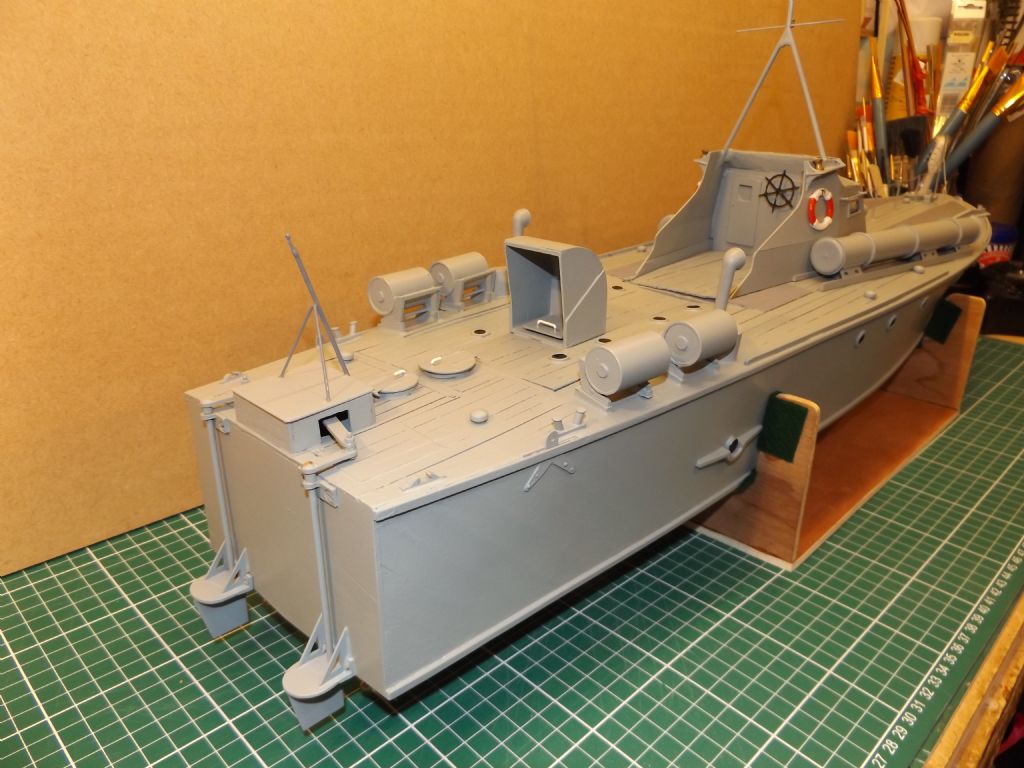

            mtb 71 mar 17 002.jpgHi Charles
            Vosper Thorneycroft MTB's with transom hung rudders had plates the same diameter as the rudder arc, which may have been anti cavitation plates aswell ? Must have saved a few red faces when they reversed into the jetty

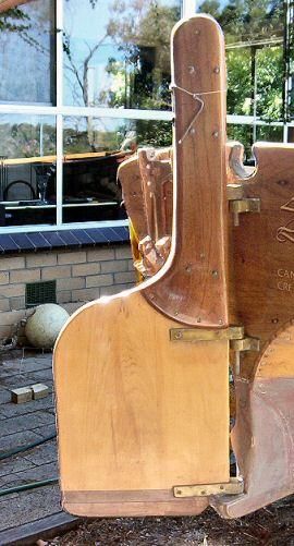

                  Just to add clarity to what I'm on about, I found this picture on the web of something similar. The boat I'm making is much beamier though.
