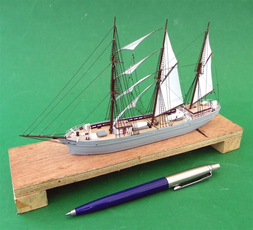

                                  The main and mizzen masts are now complete, and also the standing rigging on all three masts. At the moment, it is looking a bit unbalanced. The next task is to fit the four jibs to the bowsprit, and finally, the five square sails on the foremast.

                                    Another fine build, Bob!
                                    Every item is so precise!
                                    The ropes and sails are a sheer delight
                                    What are the little triangular sails called and were they effective?
                                    A nice assortment of sails…….I wonder how they decided on the final sail layout?
                                    Lovely model……Is the grey hull the final colour?
                                    #55795
                                      @bobwilson59101
                                      Thanks Bob,
                                      The triangular sails are called staysails when they are between the masts. They could minimize rolling and also helped to balance the whole rig. You very rarely see photographs of sailing ships without some of them set. Similar sails on the bowsprit are called jibs. Yes, the final colour is grey, which I find a bit drab, much preferring black or green hulls in sailing ships, or the once popular painted port colour scheme that was very smart.
                                      There were all sorts of rigs, depending on the trade. Mary Isabel was built on the Firth of Forth, but sailed all the way to Australia, where she was registered in Sydney.
                                      #55796
                                        Thanks Bob
                                        I suppose the stay sails would act similar to bilge keels?
                                        Did this type of ship get blown over?
                                        Can you imagine sailing all the way to Australia in those far off days and all the paperwork that had to be sorted out, before the ship was even built?
                                        Did they have Telegraph Cables at the time?
                                        How did the ship finish up?…..Wrecked somewhere, no doubt?

                                          Why would it be blown over Bob? If pressed to that extent the sails would blow out or the spars would break before the ship capsized.

                                            Sometimes they were overwhelmed, but as Colin says, sails tended to blow out before that happened. But if they got hit by a sudden squall, the order would be given to "cast off halliards." When they were cast off, the gaffs on the big fore-and-aft sails would come down at a run. The upper topsail, t'gallant and royal were all hoisting yards, so casting off their halliards would make those three yards come down very quickly, although the sails would probably flog themselves to pieces.
                                            Anyway, the Mary Isabel disappeared in 1911, and it was generally assumed that she capsized for whatever reason. Couldn't sink very easily on that voyage as they had a full cargo of sawn timber. Not a very large crew either: Captain, chief mate, 2nd mate and steward, plus 4 crew and 2 boys. The ship was only 140 feet long and 28 feet wide.
                                            I feel sure they had a telegraph cable in 1892, but there would not be much paperwork, and she may even have gone out in ballast.
