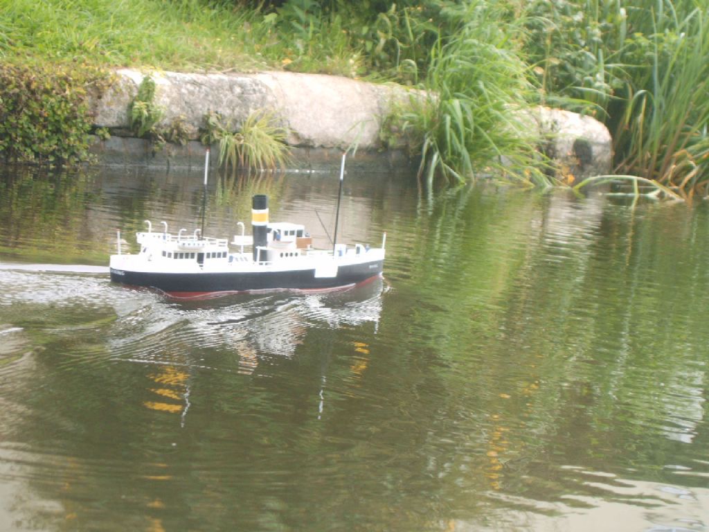

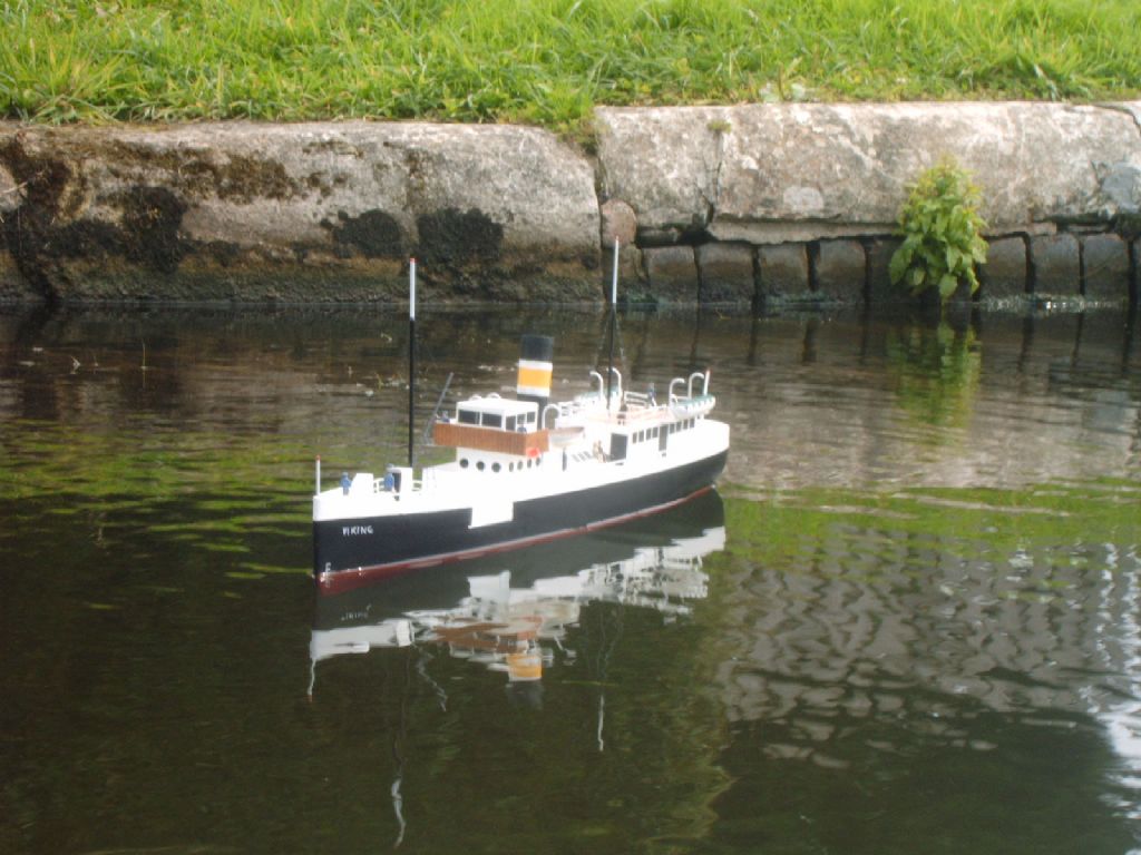

      Here we Go folks she was launched to day with no drama’s and has proved to be, stable, smooth running, and reasonable nimble on the turns, with a good lick of speed at full throttle.
      going astern is drama free also with full right rudder initially to counter the prop side thrust then she simply glides backwards in a straight line. Steering is pretty near non exsistant but that was expected.

          Thanks Bob yes it  was pretty good today apart from a few strong gusts but she handled them without any serious drama rolling slightly and slowly before the wind.
           the 10mm sub keel works like bilge keels slowing any roll right down so as the wind drops she comes upright and stays there.
          the thinned out lower bow section does its job going astern too
           just like the deep forefoot on a cobble she runs astern in a dead straight line

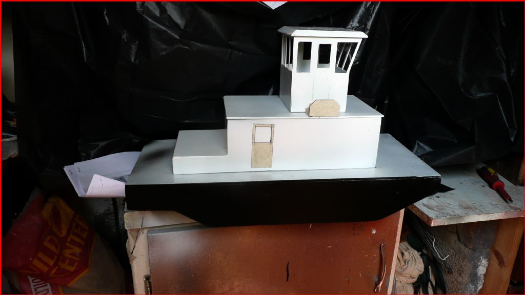

            hi Phil glad launch went well,….looks good on the water , still working on cad program,…….whats next ?, just knocked up a american tug based on a Glynn guest plan,………now looking boat detailing ,but struggling ,………..cheers larry.

              whoops forgot the picture  …Larry

                Thanks Larry that tug looks sweet mate.
