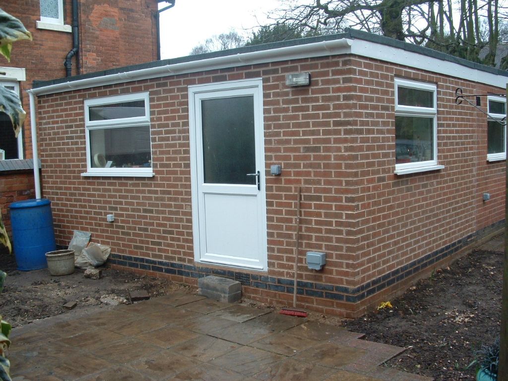

                          #64056
                            I suspect that the most hazardous impact of balsa dust is not covered in any MSDS, but relates to the impact your wife will have on you if she finds the dust in the soft furnishings and all over the dressing table….
                            No soft furnishings or dressing table in my workshop, dude… …. and there's a 12" extractor fan in the wall at the opposite end.

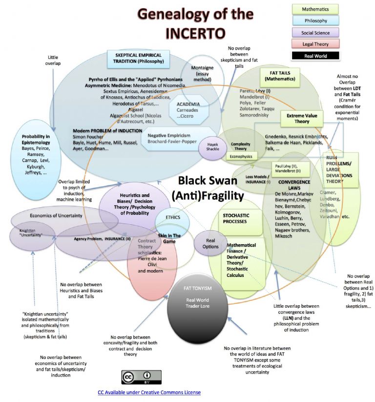

                                  Posted by Steve Walker 1 on 26/03/2016 11:05:08:
                                  I do love this forum though, in every conversation I learn something new that has almost nothing to do with boats!
                                  People come here to discuss model boats? I thought we were talking about Fat Tails:
                                  Edited By Dodgy Geezer on 26/03/2016 13:14:13
                                  #64060
                                  Steve Walker 1
                                    @stevewalker1
                                    Well I'm certainly not gaining from disorder. It might be the end of me in fact. Might call my next boat the black swan in honour of you.
                                    #64061
                                    Dodgy Geezer 1
                                      @dodgygeezer1
                                      Posted by Steve Walker 1 on 26/03/2016 13:36:44:
                                      Surely in honour of Nassim Taleb…?
