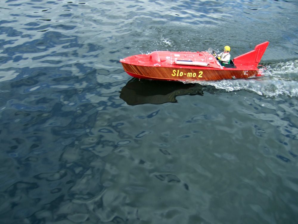

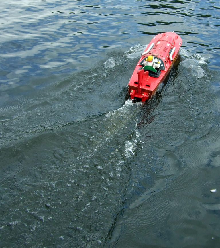

                  Sailed SloMo2 this morning and it sailed beautifully!…..As we all expected?
                  No sponsons and twin brushless motors on song!
                  Frightfully fast and fantastmigorical!
                  Almost too fast at times, for us two old wrinklies, as we had difficulity in seeing far enough ahead as we charged about the lake……into the path of the buoys and wildlife!
                  The battery lasted for about 20 minutes….Not bad?
                  Here are a few pix…………….. Duckie`s video will follow shortly…
                  I like the way, SloMo leans into the turns
                  Rear view…
                  Almost airbourne?……
                  Getting serious now
                  Just admiring the view
                  Waiting for the off
                  Edited By Bob Abell on 21/06/2014 14:14:21
