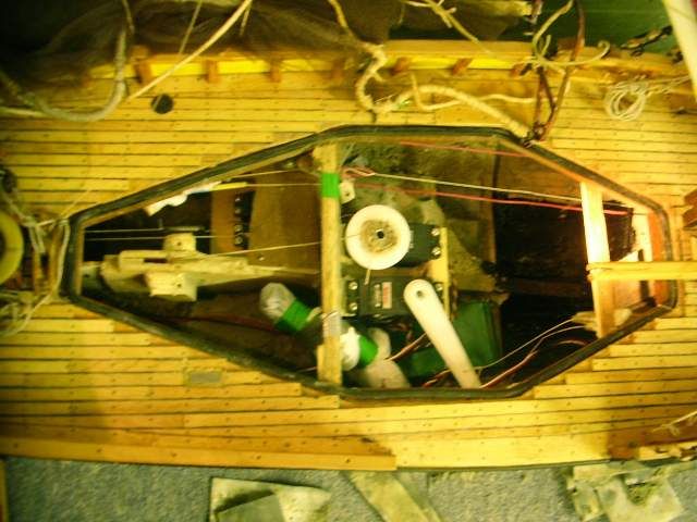

                  Looking in to the main hatch. Sail winch pulls up keel, sail arm opperats fore sails, main sail & mizzen winch under hatch for’ard return pully under deck beam. Two rudder servos under protective ply, note spring on retract string. Geoff Yarham

                      #23804
                        Ingenious!………………but when do you power the keel down?……..If on the water, it could capsize?

                        hammer
                          @hammer
                          Bob, No land line this week, So no reply untill now. I stole the idea from a Southerly 28 I once owned (full size). It is triangular and pivoted at the front, made of 3/16th mild steel with a piece of sheet lead 4″ square inlayed so not that heavy. Centre plate would be a better discription.  On my schooner I do have a proper drop keel 2 lb, on the stand it is held up. Attached by rods in tubes to the carry handel it remains up untill I let go, at the launch. Geoff.
