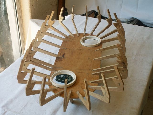

      Bottom and frames of the SDM in place. Voith unit rings epoxied in – unfortunately tops of motors will extend above deckline, so will have to box them in. Schottel units would have been better, but then I would have to have bought them!
      Side planking next.
      Cheers – Pierre

        Early Stage of building my SDM

          Pierre, its a good job I know you are building a boat, or I might have thought it was a coffee table!!   Ashley
          #18333
            I thought it was one of those wooden insect kits.
            #18334
              I thought it was a radio controlled……………………… VENUS FLY TRAP!

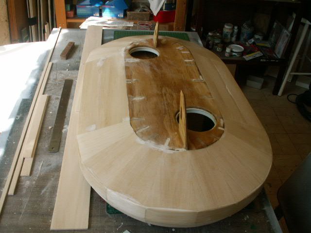

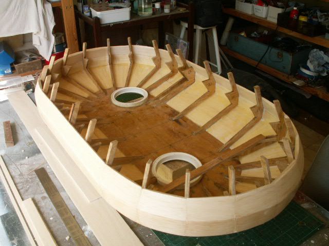

                        The build  is progressing slowly:
                        Side planking almost completed.
                        Bottom plating completed, showing the two skegs – centre panel is 4mm plywood, side panels 4mm balsa.
                        A question for the collected wisdom of the listers – I’ve completed the planking (balsa) and sealed it with 5 coats of sanding  sealer. Then I coated it with one coat of  fibreglass resin, inside and out. I hate working with glass cloth and am inclined just to give it a second coat of resin without cloth. Question: how much strength does the cloth impart to the structure?
