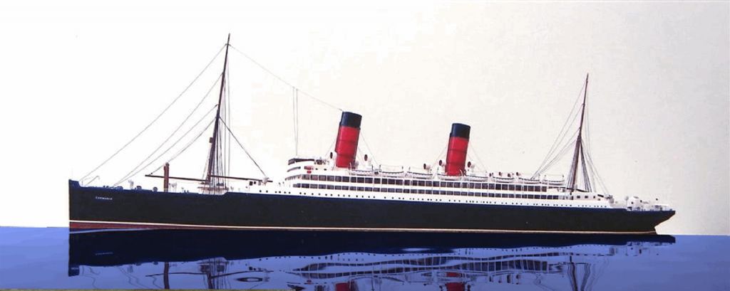

                          I built this one of the Carmania from a John Bowen miniature plan! I photographed it from a low angle and added the reflection via the PC.

                            Your photo of Carmania is astonishing, As for the model, of course I immediately notice the rigging and must ask if you increased the scale from Bowen's 1200 drawings. . Pretty damn good at any scale though !!.

                              Thanks, The rigging on the Carmania was something and nothing, it only took a couple of hours using wire. Even sailing ships are no big deal with the rigging, just a bit tedious. If you look at my photographs, on the left under my name, you will see loads of my models, sail and steam. Yes, I enlarged the Bowen plan of Carmania to 32 feet to 1 inch (1/384).
