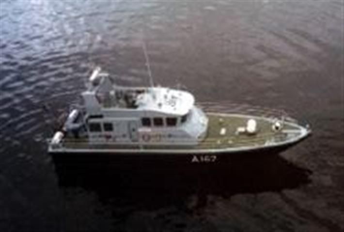

          What have we forgotten?
          Never heard of an RNXS Exploit…….Picture please?
          #36295
            Its one of these
            #36297
              Groan!…………….Another blinking' lifeboat!……………..lol
              #36303
                that's not a lifeboat, Bob……..they're all orange and blue……..it's a small RN patrol boat that is used for training young officers and crew on, if not mistaken.

                  Firstly you might want to look at **LINK** for various views of your fast patrol vessel (now used as training vessel for Birmingham University RN Training Unit).

                    Thanks for the link, the photos are great, I could not figure out from the plan the curvature of the deck from the stern but this is clear in the photos.
