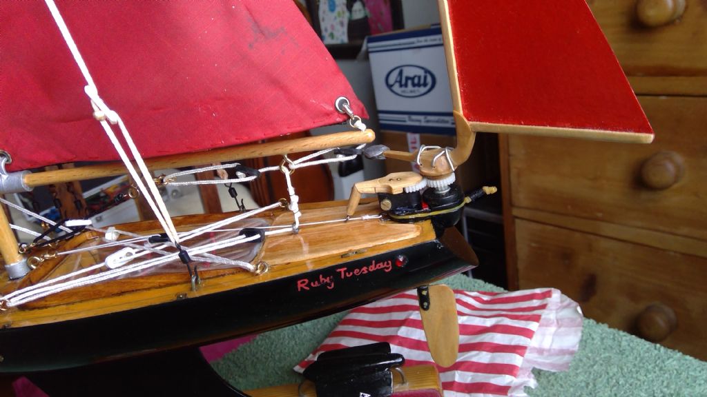

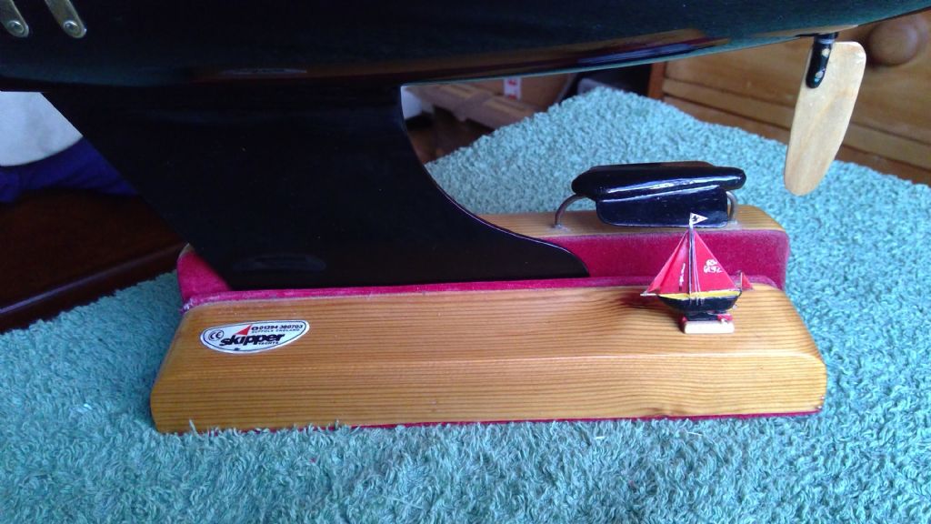

Not too bad, but may benefit from being a bit larger. Generally yacht rudders are bigger than for powered boats which was the question posed by this thread and rudders for models usually have to be bigger relative to full-size craft, to be effective.

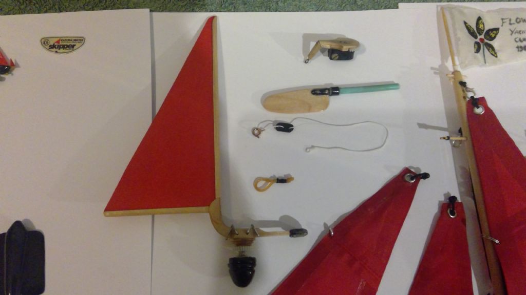

It's not really a rudder as on Chris's RC Dragon Force yacht for changing course or tacking, It's only a trim tab to correct the boats course with the vain relative to the wind direction, so it will be fine
