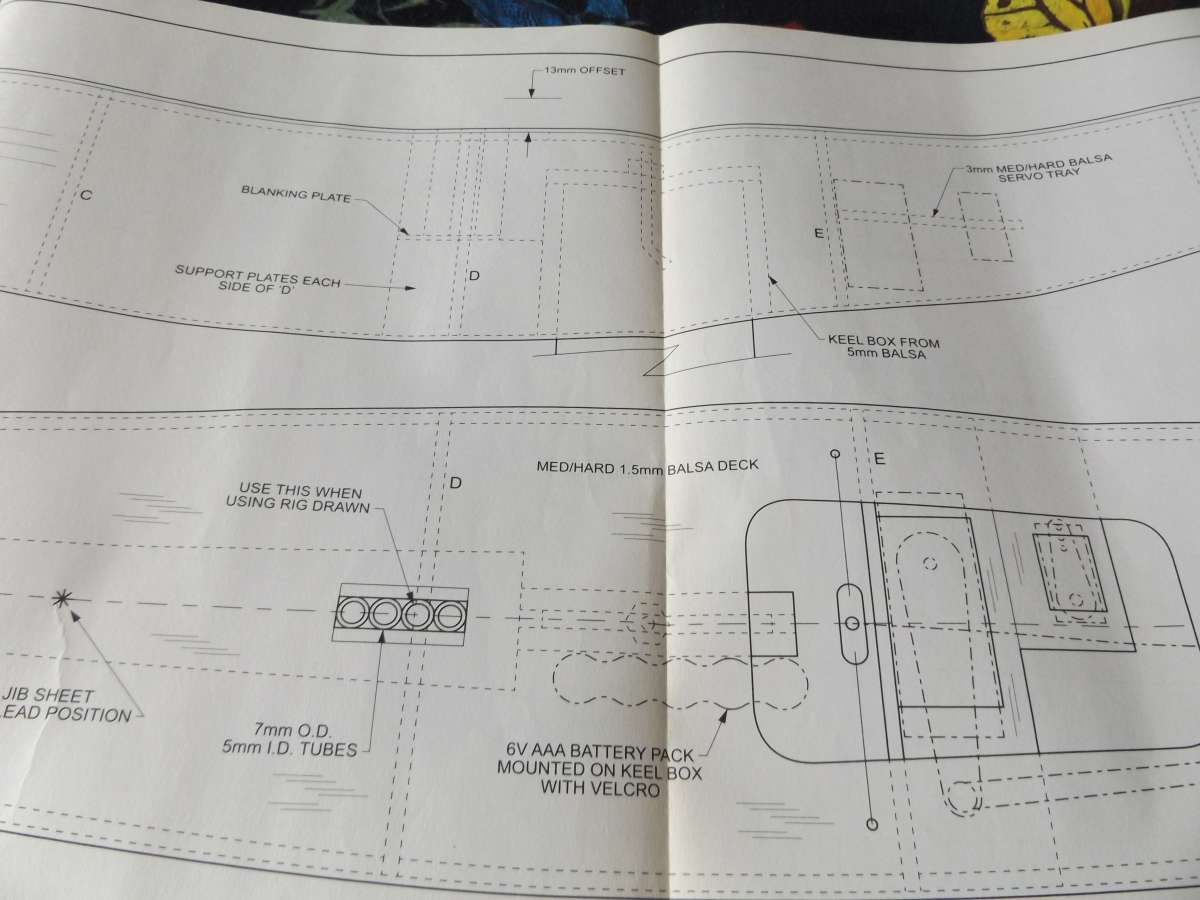

      Started build the John Goodyear RG65 Alpha from May 2018 Model Boats. I’ve read the three part article and plans, Can’t find anything that tells you thickness of deck. I was going to use 1.5mm thick ply. Also I assume the mast foot goes down into boat. How is it fixed at the foot ? Does it need some kind of wood block to keep it upright ?

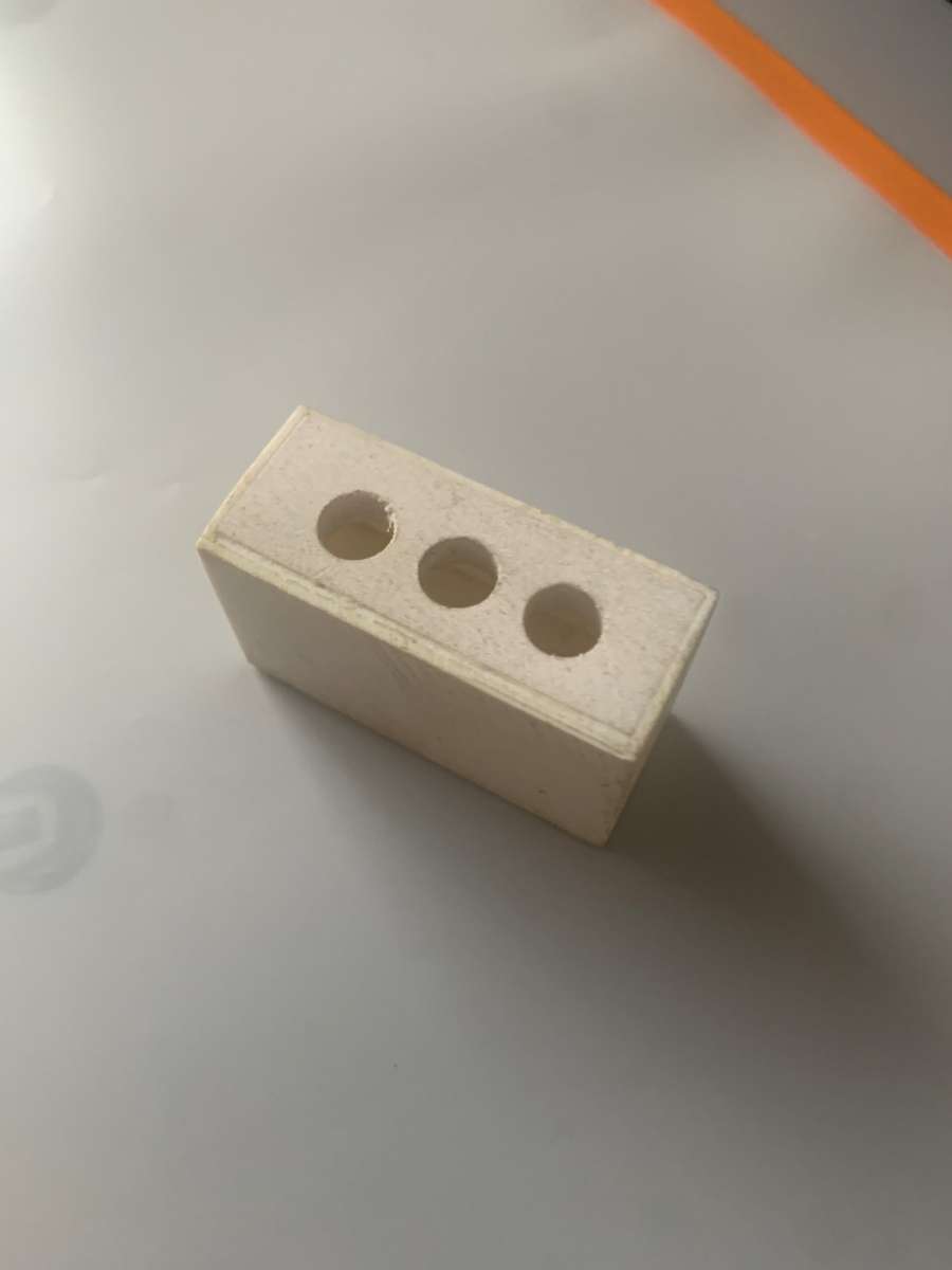

            For the mast step, this is up to individual choice but on most of my models I use a three-position little unit as shown embedded in the guts of the model with some support below it and to the sides. It has proven very effective on the 13 JIF models constructed for club members to date.

                            Checking on the plans, the hull formers are not at 90 degrees to deck. They are set at 89 degrees which makes a difference to keel box angle. I’m going to do the same sort of setup for mast foot as on the Omega boat.

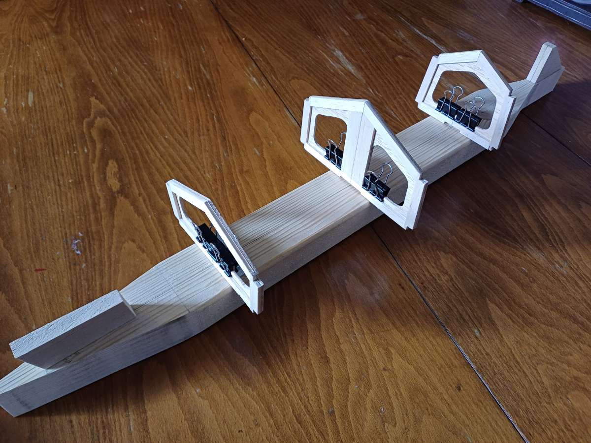

                                  Jig built and middle three frames added. Just need to sort out transom and bow frames.

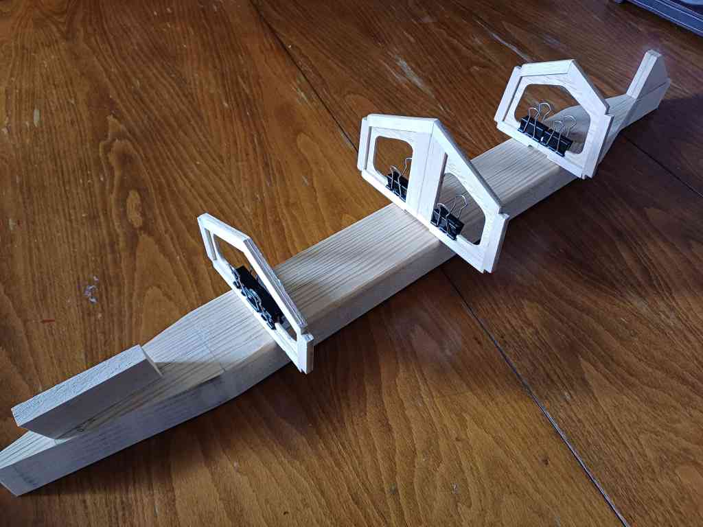

                                      Third time lucky.
