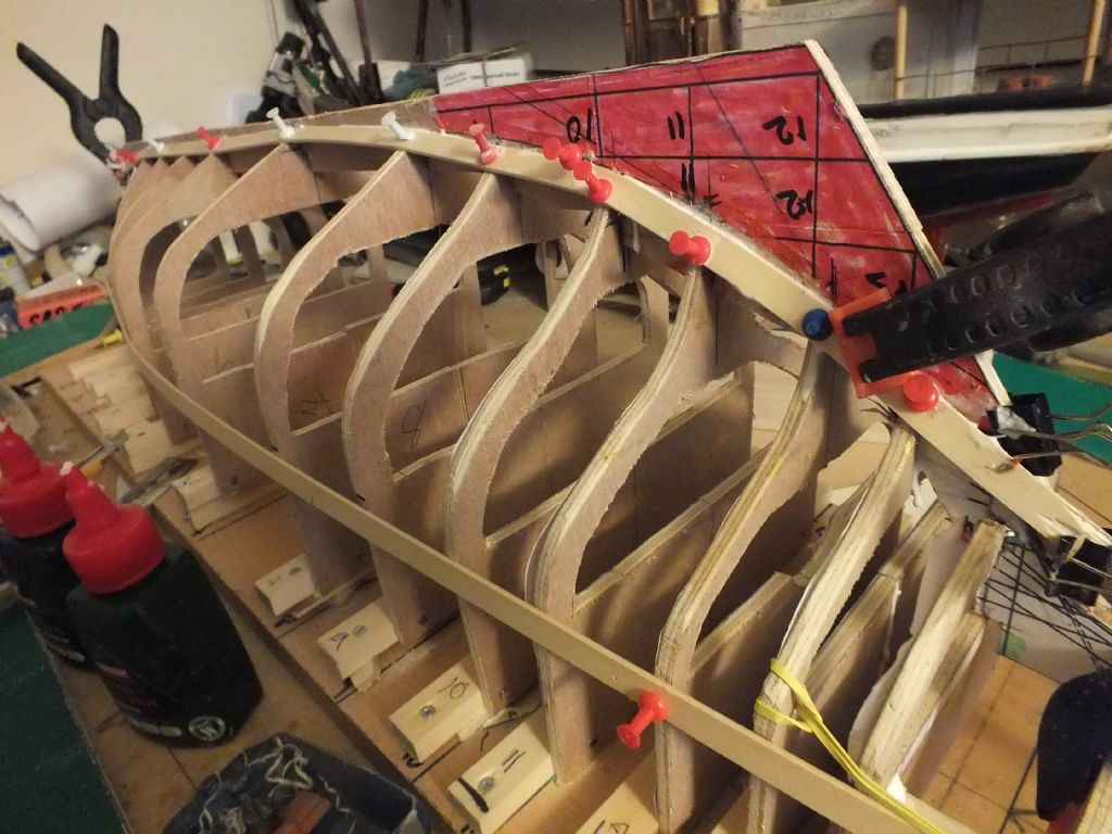

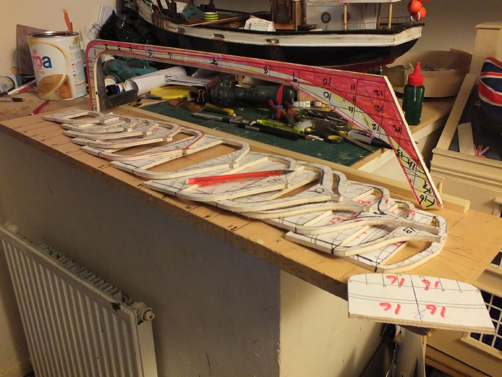

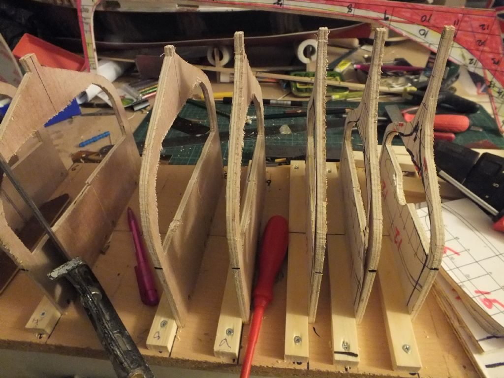

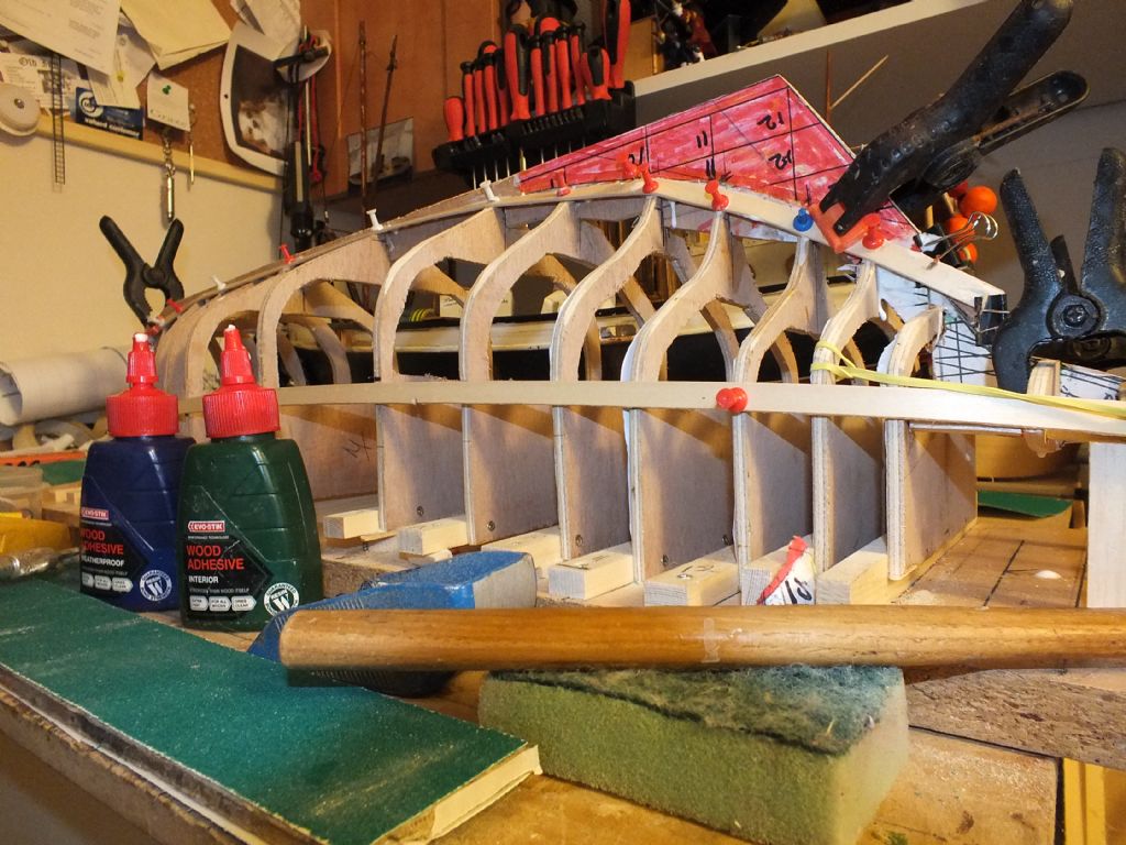

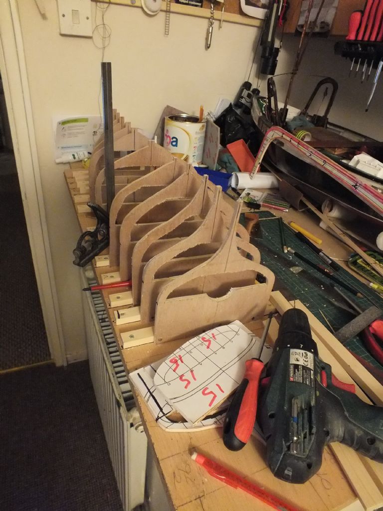

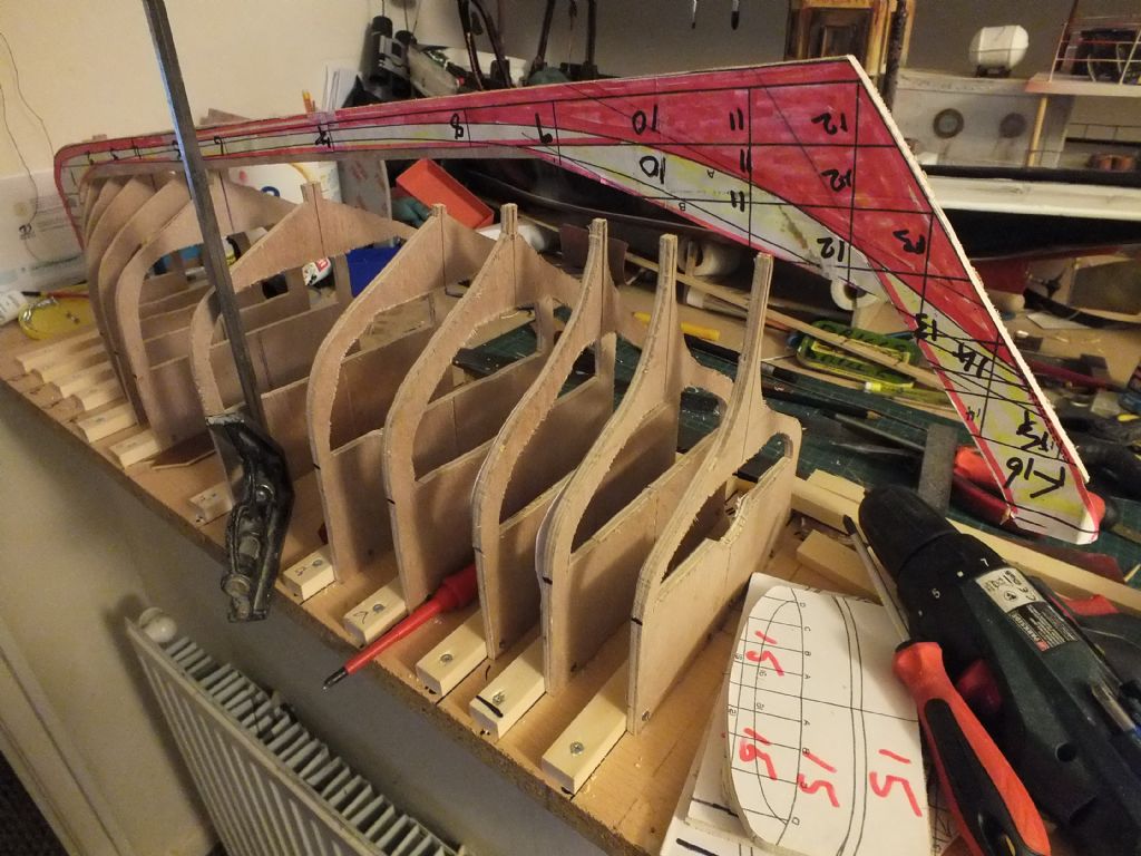

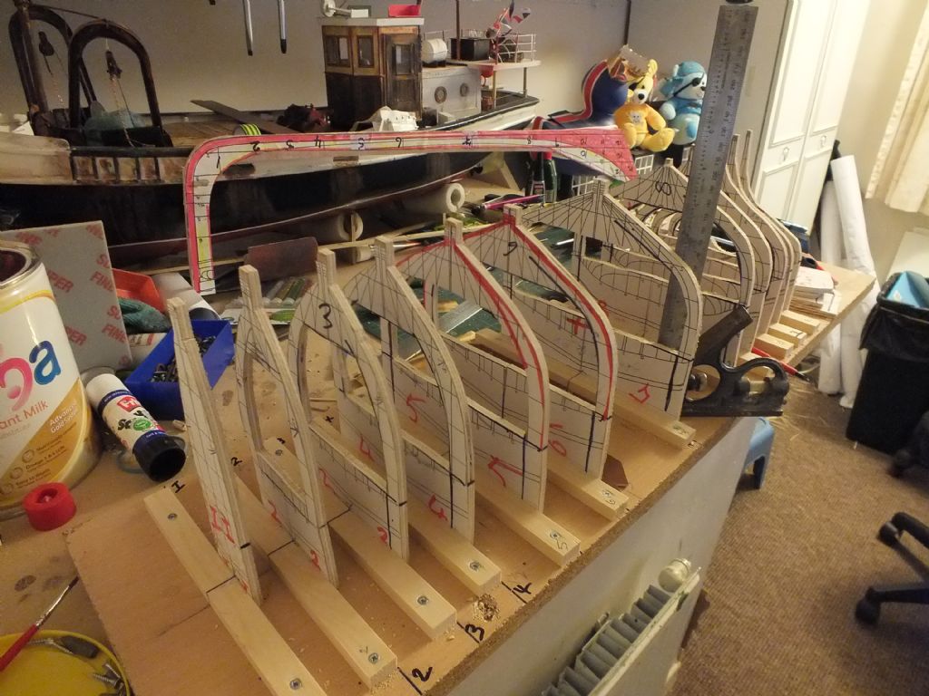

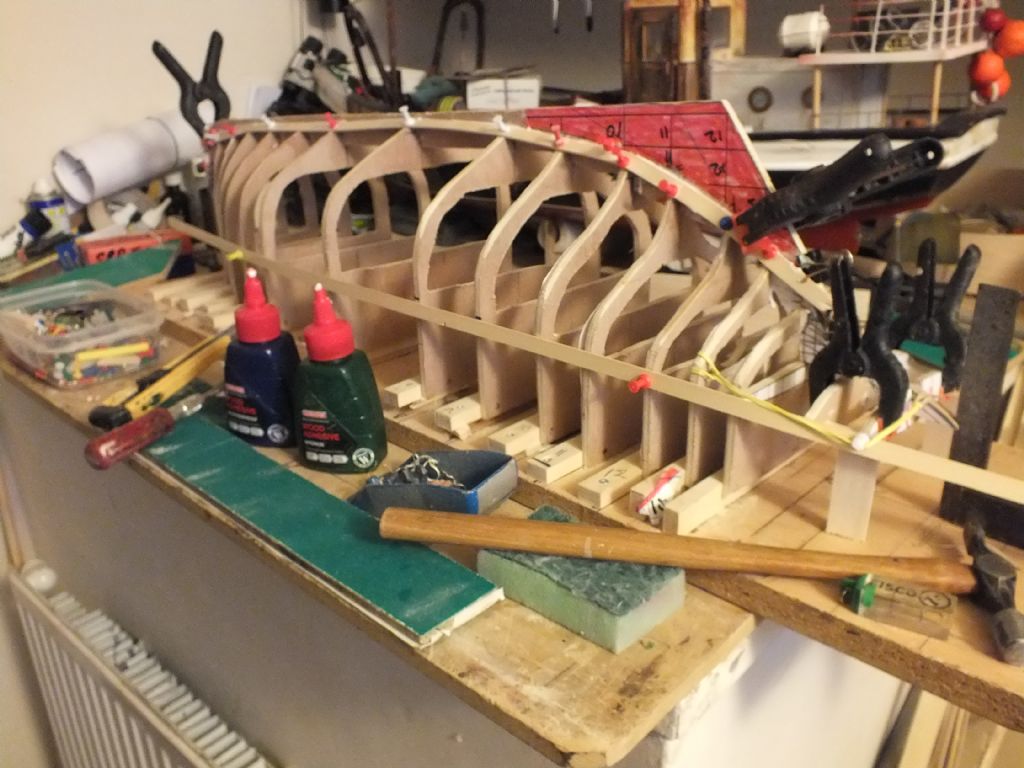

      brixham build (11).jpgGood morning,
      a bit more progress , frames cut out , build board set out, frames set to keel lay out,
      first set back cropped up not much timber at frames 10 to 13 at keel bottom so will notch frames into keel timber dead wood, and make shortfall when planking starts , dont be shy to throw ideas at me ,
      all ways open for feed back …Georg recieved letter ok , thank you …….cheers Larry…

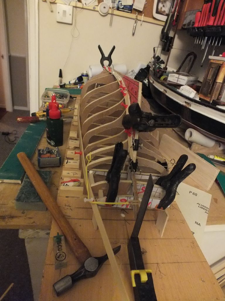

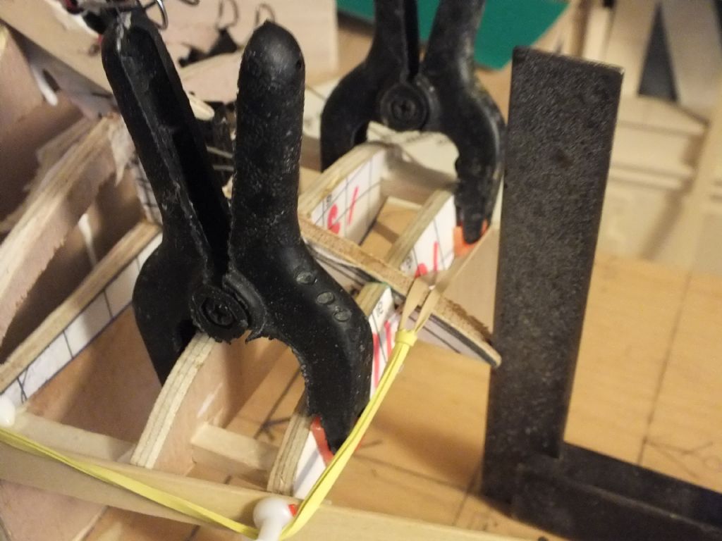

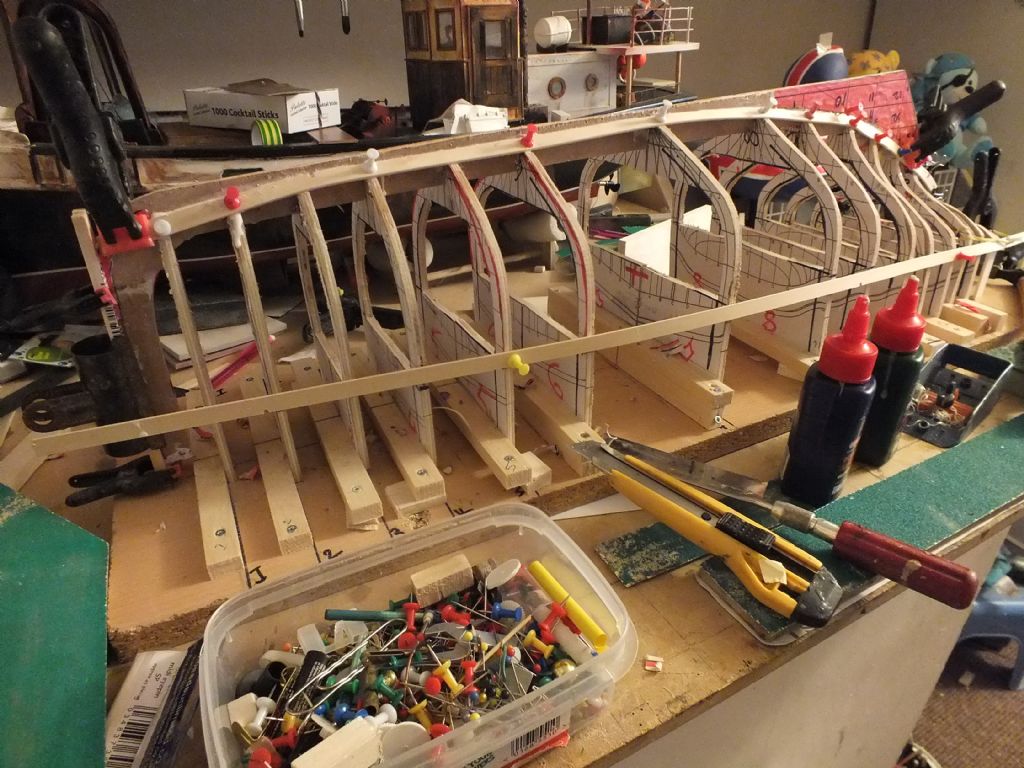

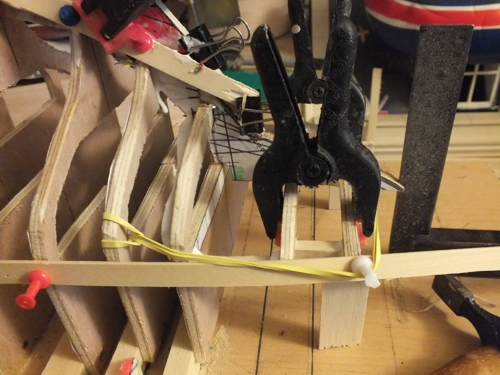

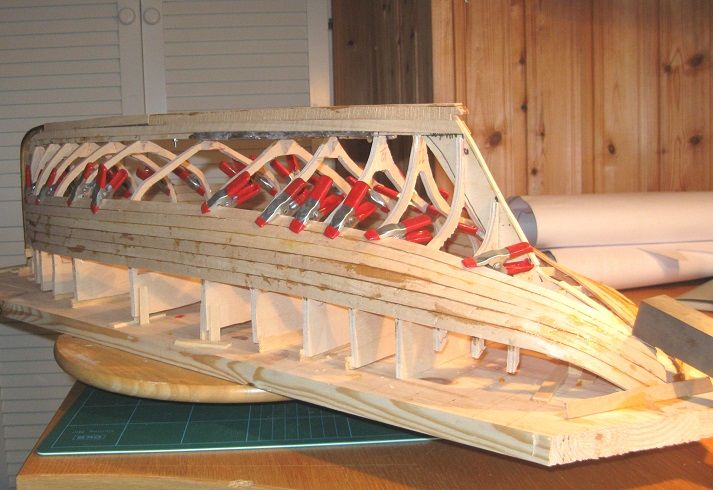

        brixham  trawler build 3 002.jpgHello all ,
        Back end sorted ..sorry stern…a bit of tuning to frames, deck line sorted , first plank fitted,…
        closed work shop till after Christmas ,… of to Combe Martin for 3 days SANDY COVE HOTEL…
        was going to cut across to Brixham to view trawler and take few snaps but weather as changed that roads flooded so some other time,,…will visit Ilfracombe in stead trawlers there i hope…
        a few more pictures …..cheers Larry,,,

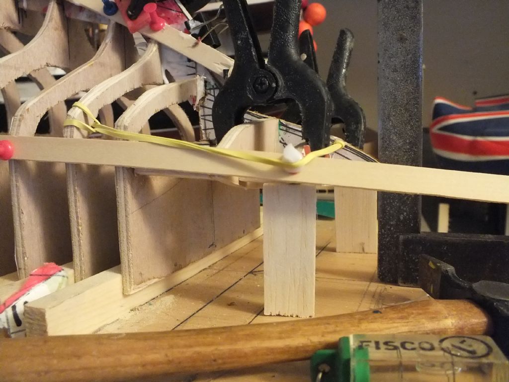

        #45936
        Georg Fleetwood
          @georgfleetwood21053
          Hi Larry!
          I have not watched the forum lately, sorry!
          Yes, building the stern was difficult, but I used a bit too long planks and let them end outside the finished hull length. In that way I could fix the shape and then cut them at the right length. (I have some problem to explain it in english!!) See picture.
          Georg
          #45942
          LARRY WHETTON
            @larrywhetton68737
            Good morning,
            I hope you had a nice Christmas..?..
            Thank you for info . planking coming on very well will post pictures soon ,
            i have added a balsa block to stiffen up stern,
            will come back soon cheers…Larry..
