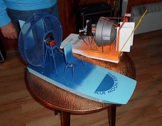

        i’ve made an RC boat from scratch. When i put it into water, it is not stable, it tilts towards sides. Plz tell me what should i do

              this is the photo of the boat.
              #30532
                Hello Muhammad
                Your picture has appeared OK
                Your model looks rather tall and top heavy!…….Is this your own design?
                You need to position the battery as low as possible.
                I would suggest adding extra width at each side like outriggers etc

                  yes this is the design and i have figured it out that even after putting the battery in the bottom didn’t work…. The center of gravity is way to high than expected :-@
                  i need another weight i think.. thoughts??
                  #30534
                    You can try more ballast, but the hull looks a bit too narrow
                    I suggest you add extra width in the form of sponsons, similar to this model…

                        Hmm…is this an airboat?? judging by the propeller.
                        If it is an airboat you will need to widen the hull until it is stable, as adding lead, although this WILL stop it wobbling, will also kill the speed..which is what airboats are all about.
                        secondly, do we assume its not finished yet? and , what is the superstructure made from please.
                        Ashley oh, and some measurements would be interesting and your propulsion details.

                          Yeah its an air boat and its not finished yet bcoz of the unbalancing problem occurred unexpectedly. The material used is cheap Ply Wood available in local market and design iz my own.
                          Motor is Tower Pro 18T with 6×5 propeller [ propeller size limited due to hull :'( ]

                              Its not so much the contact area, but the weight that is the problem. For an airboat, you want as little weight as possible in order to get the performance. This is why extending the sides out would be a bit better idea, for more stability rather than adding weight. Adding weight is not a problem on a Tug for instance, but is so on anything fast…speedboat etc.
                              The superstructure needs to be kept to a minimum, so unless you have a design i would suggest removing or lowering that which is fitted..OR making it out of something lighter, balsa wood or polystyrene (tiles, can be used)..or even ordinary card..this would be ok provided it is painted all over.
                              Traditionally an airboat has a badly modelled driver sitting on a chair as the only superstructure..cant go wrong with that. Colour…anything you have handy, or how abouit a green/brown or green/black camouflage finish. or a similar scheme but using whatever paint you have.

                                  Looking at the photos, the boat simply seems to be too tall and narrow to be stable. Airboats are usualy around twice that wdth proportionately. As you have found, adding weight significantly reduces performance. Lightweight outriggers as previously suggested would be better although they would slightly add to the resistance of the boat through the water. Worth trying anyway.

                                      These are the airboat proportions
