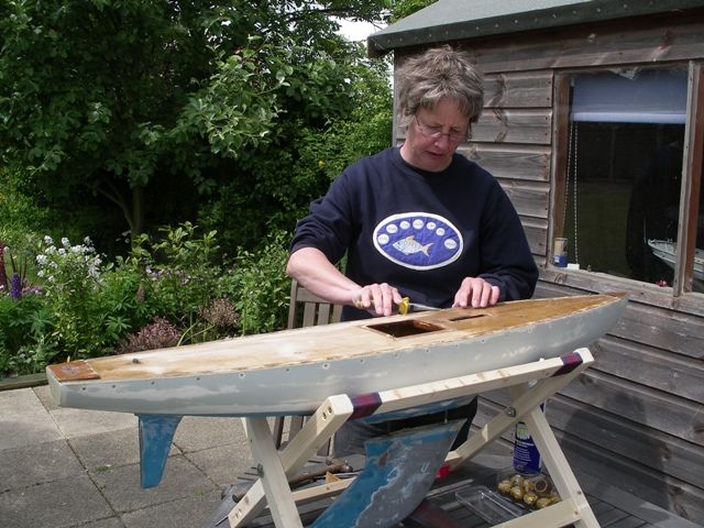

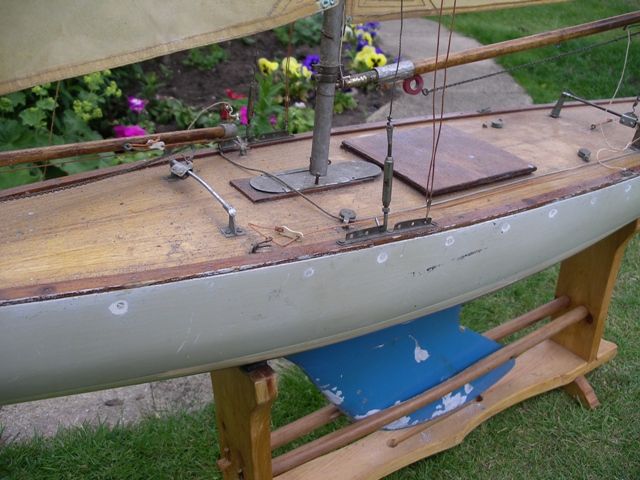

        My wife Elizabeth spotted a vintage yacht in our neighbours garage. They had planned to restore it but it had languished there for a few years. We were told it had originally been built by a Welsh politician but we never found out whether this was true. After a few measurements were taken and research done we decided it was a Marblehead, probably about 50-60 years old. Elizabeth had built a Victoria kit as a starter, this was to be her first major restoration project.
        It came complete with original varnished terylene sails and a vane steering gear. The hull was fibreglass with a distinctive flipper shaped keel. However it was in poor condition and very dirty.

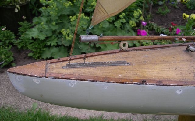

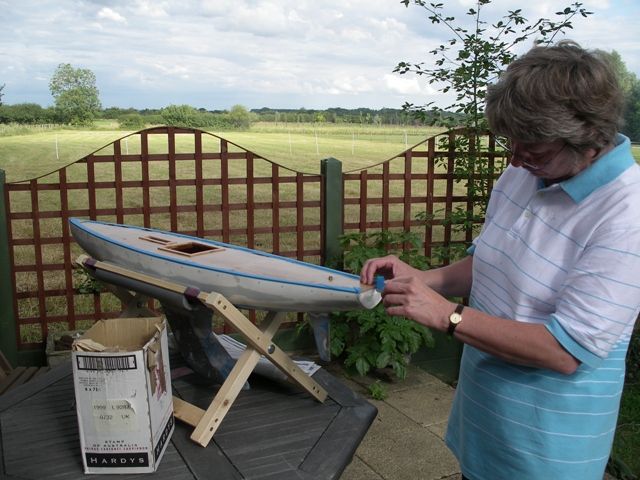

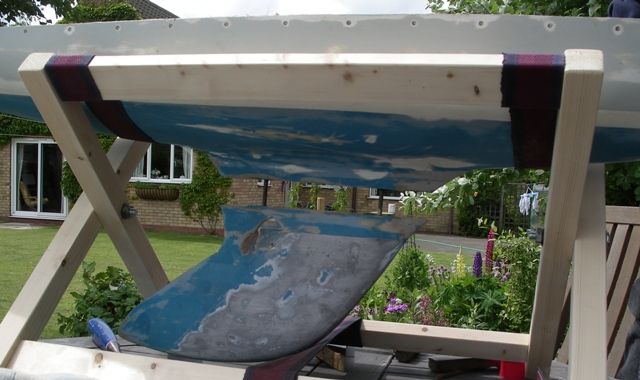

        The first job was to strip off and save all the fittings

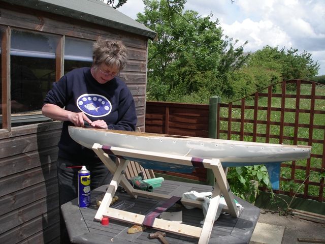

        Remove the deck edge strip nails

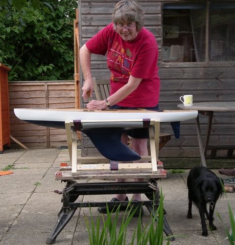

        Next job was to remove the keel which was loose and twisted.
        There was a lot of rubbing down required plus a bit of chiselling to get the deck edge strip off

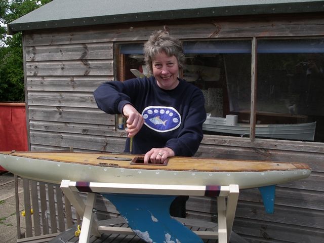

        The internal keel supports were a poor shape and did not fit properly. They needed replacing with new items – a chance to play with the boss’s power tools.

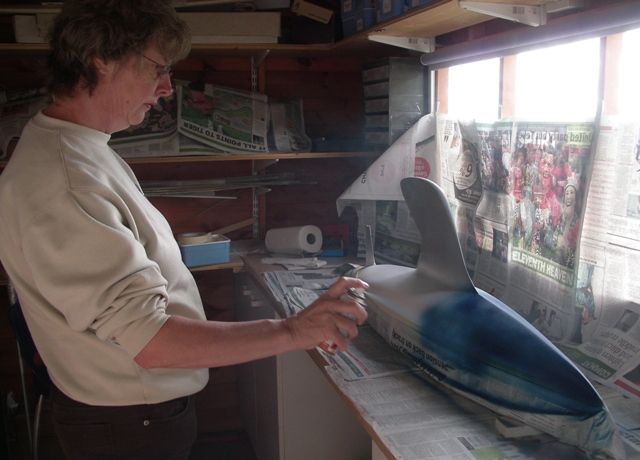

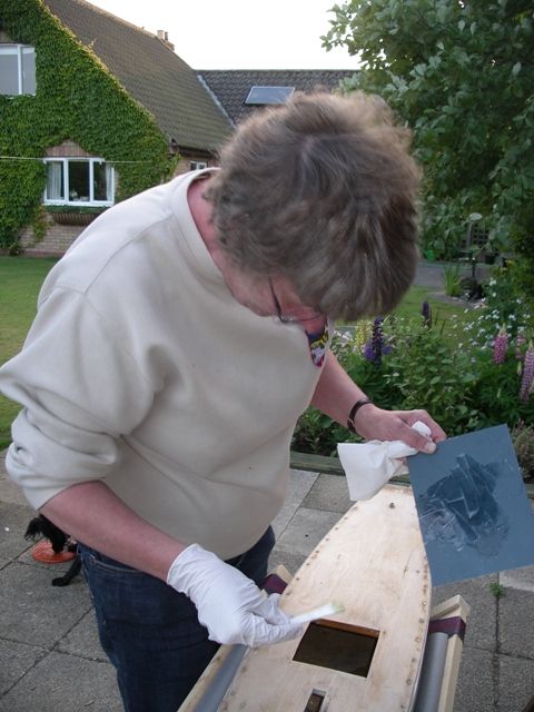

        Now the dreaded poxy resin to fit the new keel supports

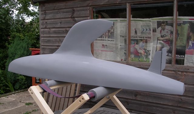

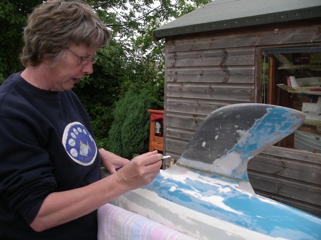

        Next after rubbing down and filling and rubbing down and filling and ….., masking prior to spraying
        Now into the shed for spraying the primer. Health and safety specialists shut your eyes here.
        Finished with the primer
        After more masking, on with the gloss top coats.
        Back outside now, in a healthier environment, starting to add the deck fitings which all needed to be cleaned and polished.

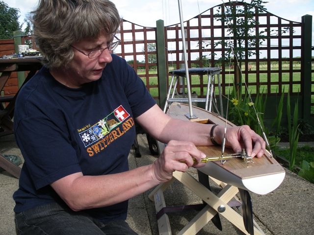

          Next job was fitting the mast. The mast, booms, sails etc were purchased from Nylet. The old sails were too perished to be used.

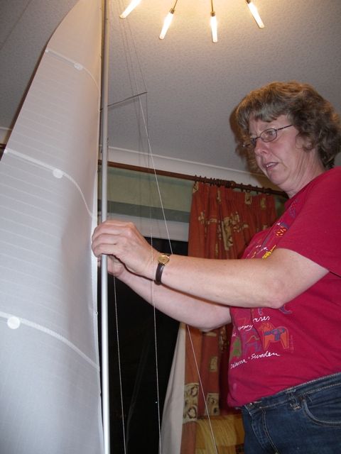

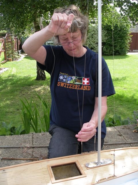

          Rigging the shrouds

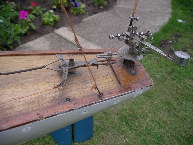

          Connecting the vane gear to the rudder. Elizabeth made a conscious decision to retain the vane gear. However since we dont have anywhere to sail it locally with just vane control, radio control of the rudder and sails would also be fitted.

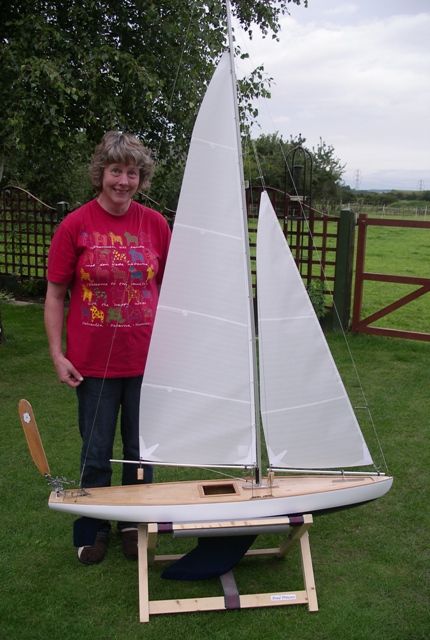

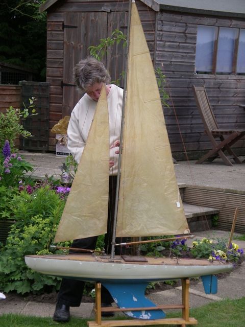

          At last the sails, although only as a trial fit but its starting to look like a yacht again.

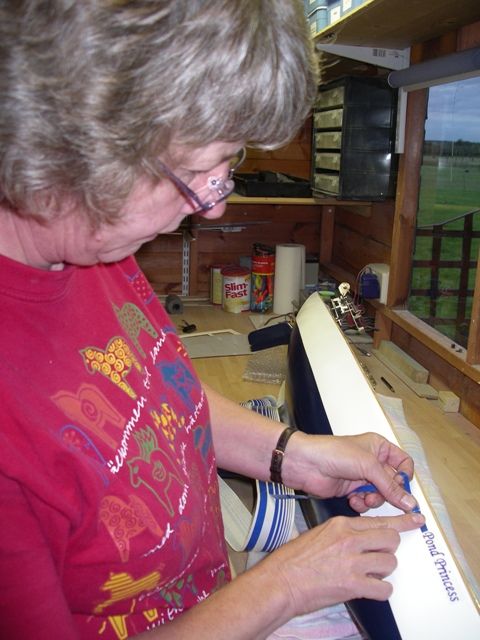

          Fitting the trimline and name printed on vinyl sheet

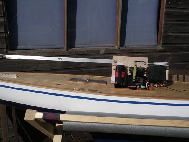

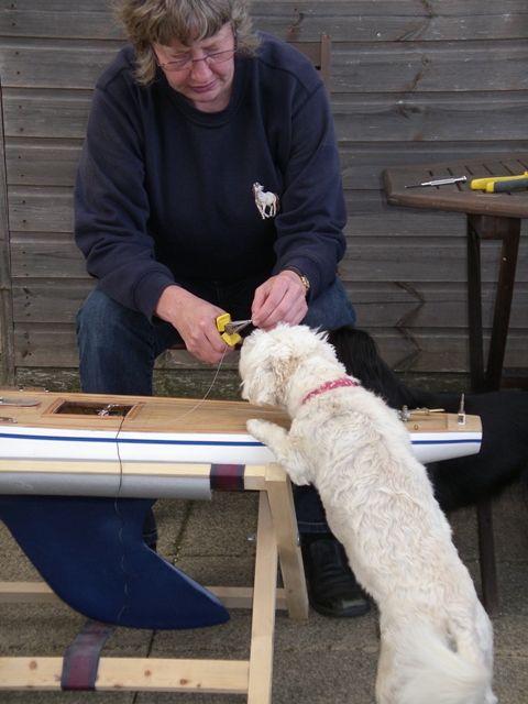

          Next the radio gear. A bit tricky this as the whole thing had to fit through a 4 inch square hole in the deck. Needed the help of a systems engineer husband for the design and construction of this bit and the hands of a small daughter to feed the sail control lines through the deck pulleys.
          Even Kelpie lent a hand/paw at this stage.

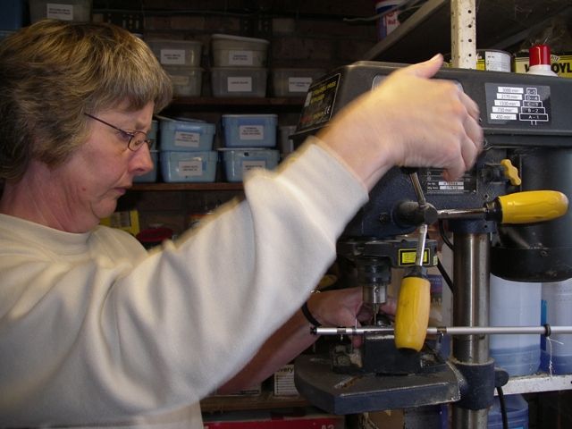

          Big boss’s power tool again to drill the main boom

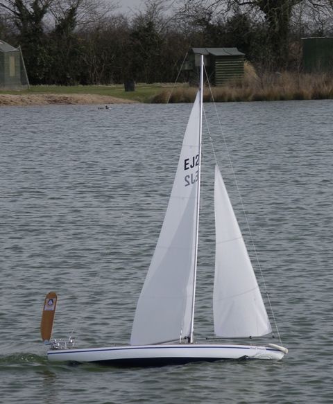

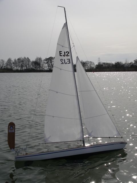

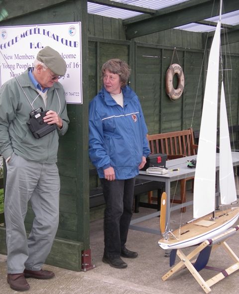

          Now ready for its first voyage in many years. Fellow club member suggests Elizabeth has got the rudder on upside down.
          Finally a couple of pictures of Pond Princess on the water. She has since sailed at Fleetwood and South Shields. Elizabeth has joined the Vintage Model Yacht Group and tried to research the origins of her yacht but without success. The expert opinion is that it probably originated in the USA, based on the keel shape, but beyond that we have no idea.
          All Elizabeth needs to do now is work out how to set up the vane gear and use it in its original free sailing mode.

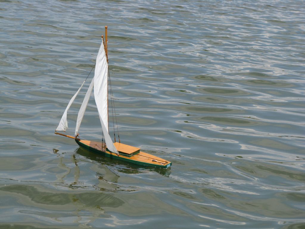

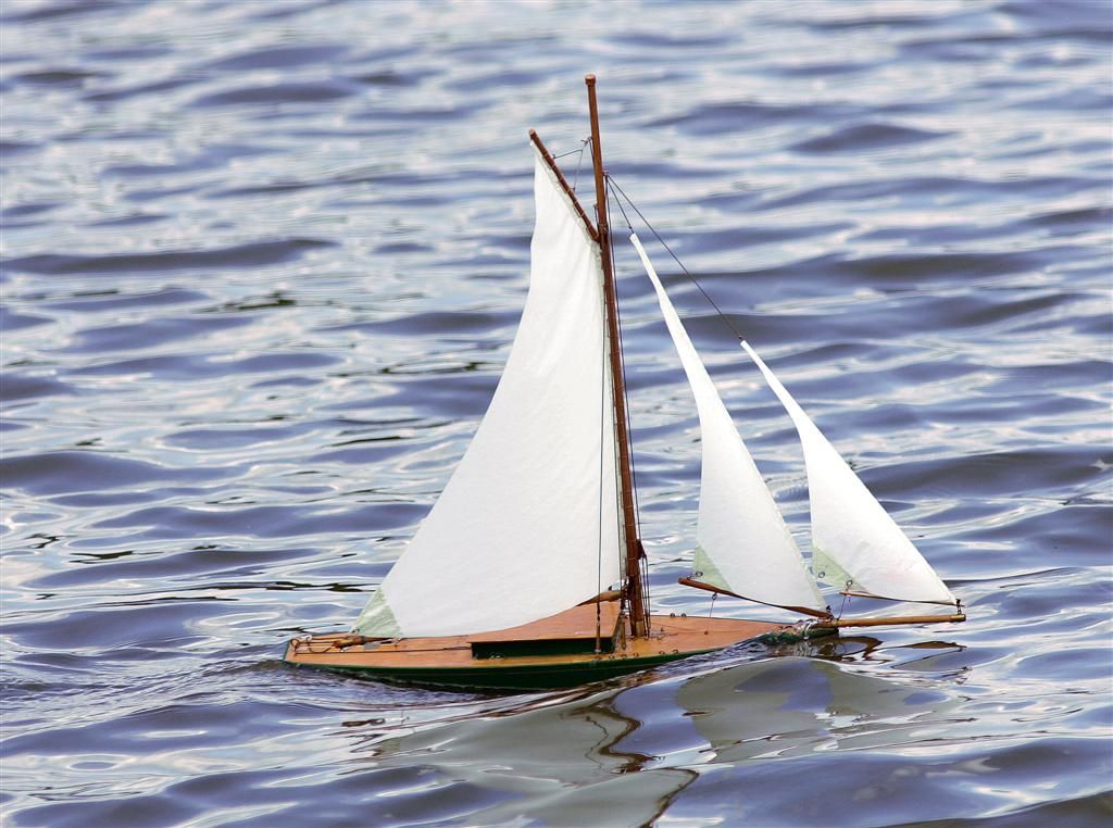

                  I am posting some photos of the restoration of my first Yacht, it was made for me by my Dad (the woody bits) and my Mum (the cloth bits) when I was 10 years old.
                  Over the next 4/5 years it went through a number of changes, A Braine gear with the Gaff rig then a Vane gear with a Bermudian sail untill it was replaced by other things that interested a 15 year old and it went into the attic.
                  The restoration started when my Wife suggested that I rebuilt it when I was looking for a new project, this was easier said than done as I only had the hull and an old photo to work from, but an appeal for help on Mayhem supplied the missing sail plan and mast position information.
                  It sails so well that the position of my R36 as my best Yacht is under threat.

                        geoff jones
                          @geoffjones74507
                          Hi Elizabeth,
                          Thanks for your comments.
                          No, I am sorry to say that it is not a free sailer but is controlled by the dark forces of R/C.
                          This is partly to justify my investment in some fancy gear, but it is more to do with an age thing, knees and fingers nolonger appreciate getting wet and cold when adjusting one of the old type of control systems.

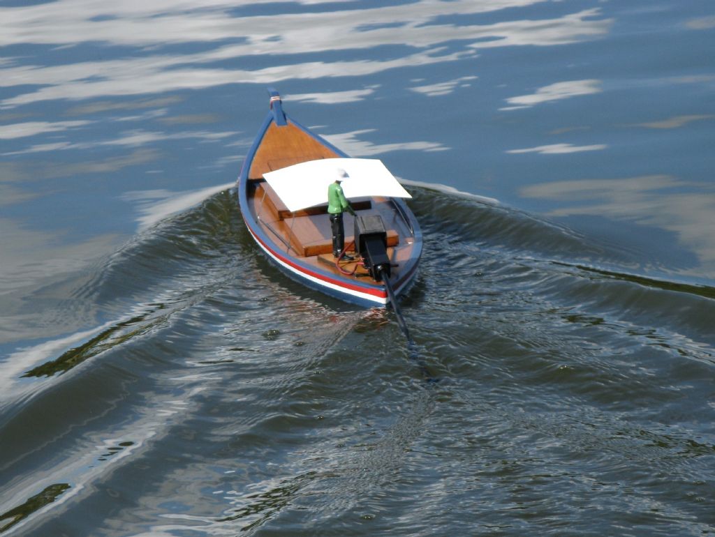

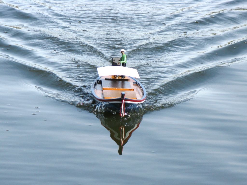

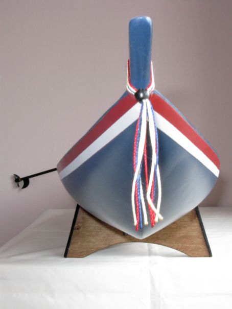

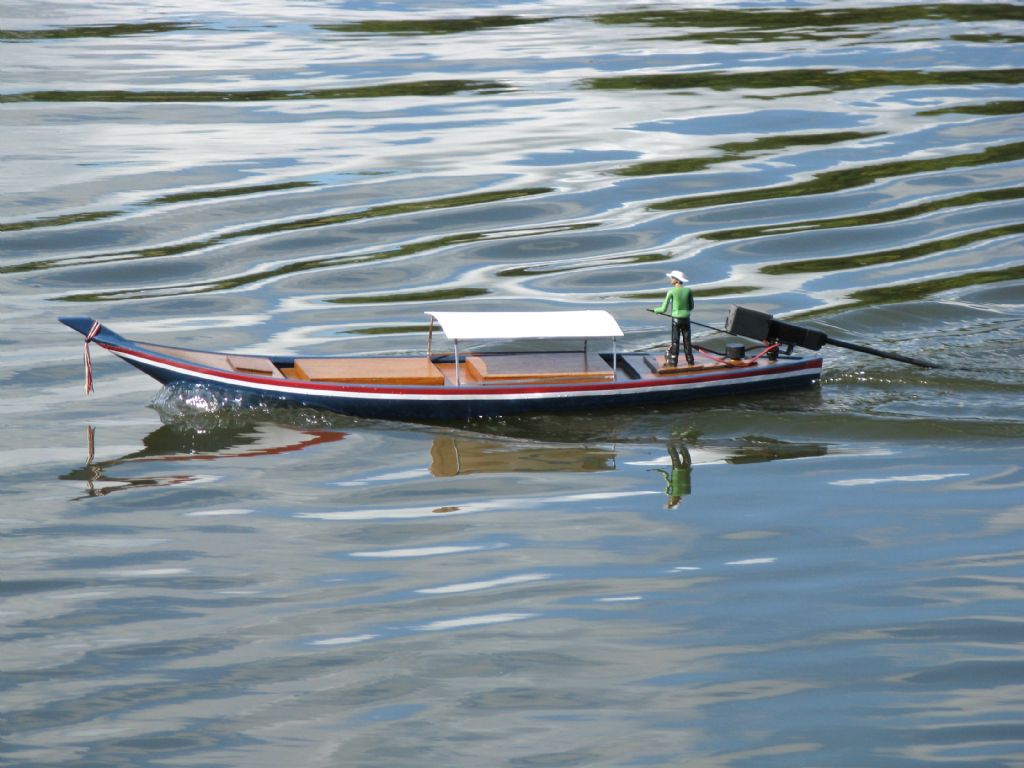

                              What more could a yacht want ?. Well after talking to my last new build ( see photos) about where it’s full size brothers live, it has hinted at warmer water.
                              Keep in touch,
                              Geoff.
                              #31253
                                Geoff, I like that. I like that a lot. How effective, and a good turn of speed by the looks of things.
                                There is always something different out there to build.
                                Vive la difference!
                                #31277
                                geoff jones
                                  @geoffjones74507
                                  Hi Ashley,
                                  Pleased to hear that you like my Thai Long Tail. Not bad for a scratch built hull made from corn flake boxes and a nylon stocking.
                                  Requests for plans and build information are only accepted if on the back of a £20 note.
                                  I have looked at your builds, and they are cases of Vive la difference in spades.
                                  Geoff.
