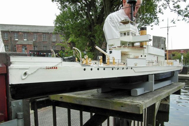

      However, the Etherow Club had a mini regatta and BBQ last night and lo and behold…..A plank hulled model appeared, built by Paul Blyth of Ellesmere Port fame……He won Gold and Silver in the scale comp with two magnificent battleships

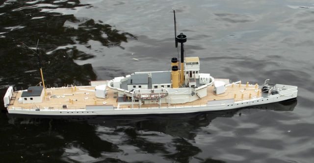

      The model was not meant to be a plank hull, that`s how the original ship was built, but the hull was only 40mm deep with hardly any ballast…..Only about 4lbs!
      The model performed perfectly well, having to battle through the wash of SloMo and the Club 500 hooligans charging about
      So it proves a shallow hull for a large impressive model need not have 100 lbs of lead

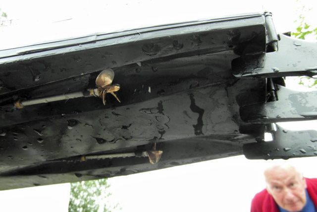

      Note the props sunk into the shallow hull
      Who would suspect that the hull is only immersed in about 25mm of water?
      The Scarab was a gun boat operating on shallow rivers in the Middle East somewhere
