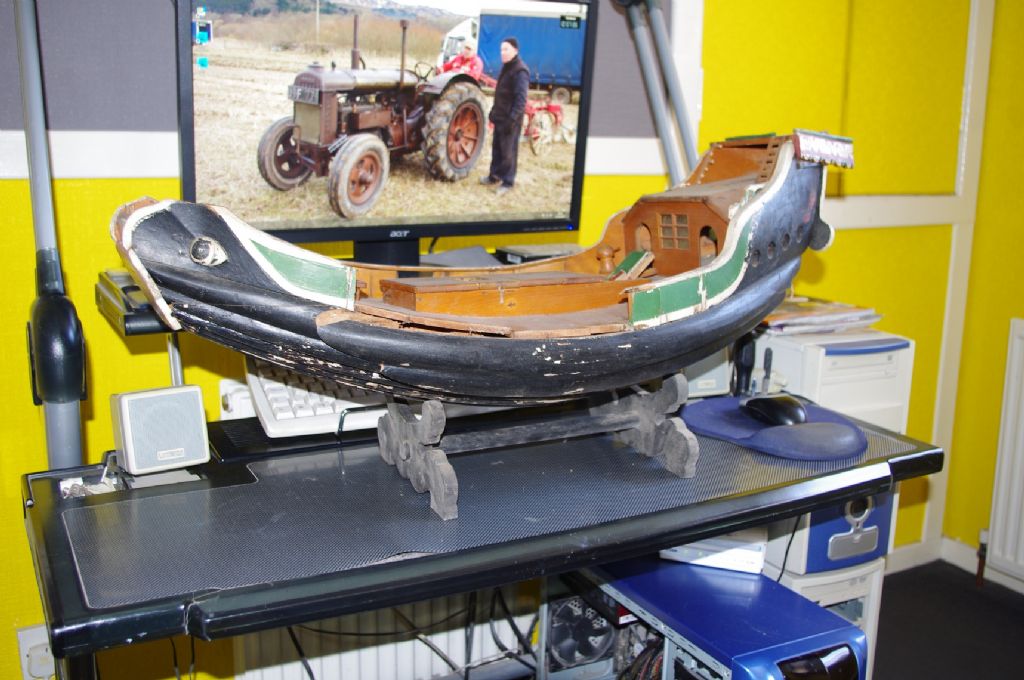

      Hi, I'm completely new to forums and model boats. I have acquired an old model of a Chinese Junk and would appreciate any information that anyone can tell me about it and also any advice on how to put it back together.002.jpg
      #2267
      Ronnie Fowlis
        @ronniefowlis79370
        #41415
          Ronnie. Interesting project.
          Where to start?? depends how much work you want to do on it really. The obvious big jobs can be glued up with PVA or superglue, and the small stuff..repaired or replaced. May be difficult in matching up the varnished bits, or you can sand back so all the repairs match.
          Hull finishing.. either a simple rub down and repaint ,or strip..assume it is a static model?
          Masts and so on, up to you but the whole thing looks very stylised and I would go for the sort of look you see in books on old Chinese prints (if you see what I mean) and copy that. I would fancy slatted bamboo sails (Chinese place mats!!!) and the minimum of rigging. Did it have masts? are there deck positions for masts??
          Need to do something about the stand initially as this does not look to be contemporary with the boat…or is it?? in any event it is only touching on 4 points and usefully you could do with something more supportive while restoring.
          A trip to Soho in London would be good later on to "accessorise" it with Chinese knick-knacks!!

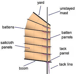

            #41417
            LARRY WHETTON
              @larrywhetton68737

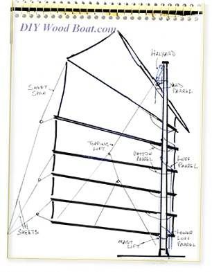

                    #41444
                    LARRY WHETTON
                      @larrywhetton68737
                      Hi Ron ,
                      answer is no , see sail drawing i posted…….
                      you get a simler item in pound land………Larry…

                                #41458
                                LARRY WHETTON
                                  @larrywhetton68737
                                  junk-sail.jpgHello Ron,
                                  Ihad short spell in HONG KONG while in the mob ,
                                  and the junks i saw there where aptley named they are working boats so dont put yuor self down
                                  about finish, i like a bit of weathering , as for sails , they are a bit of patch work item .
                                  some of them used old tarpurlins, thats why i surgested crumpled paper for sail cloth ,
                                  if you intend to sail you will have to have a rethink , most junks have motors fitted to get across Hong Kong harbour and to dodge revenue boats , 300px-junk_sail_components.jpg kkKeep up the good work Larry

                                      The 4th and 6th photos show the masts and sails that I got with the Junk but I've just added some more.
