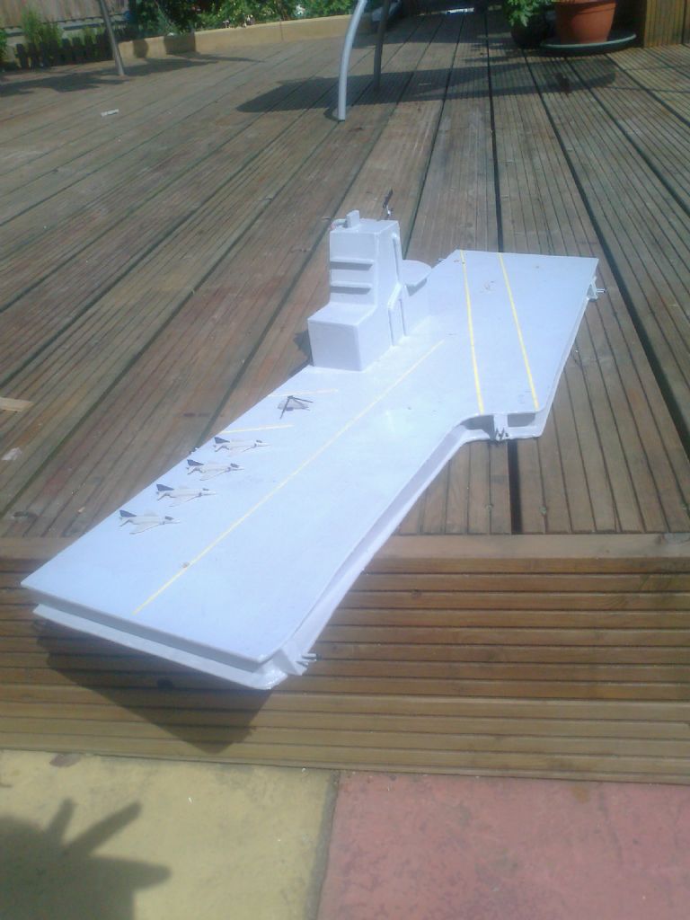

              I had started with the idea of a air craft carrier .with the hull as a stardard type and ballasting ect to canteract the over hang.I then change my plan to a central brige type ship with supper structor central but the more i play with it the worst it get.
              this is my second ship I built with the first running 3 years with out problems.I thing I have just been boged down by this on.
              I could shelf it for a bit butit has cost so much up till now.
              it is not a kit but scratch built

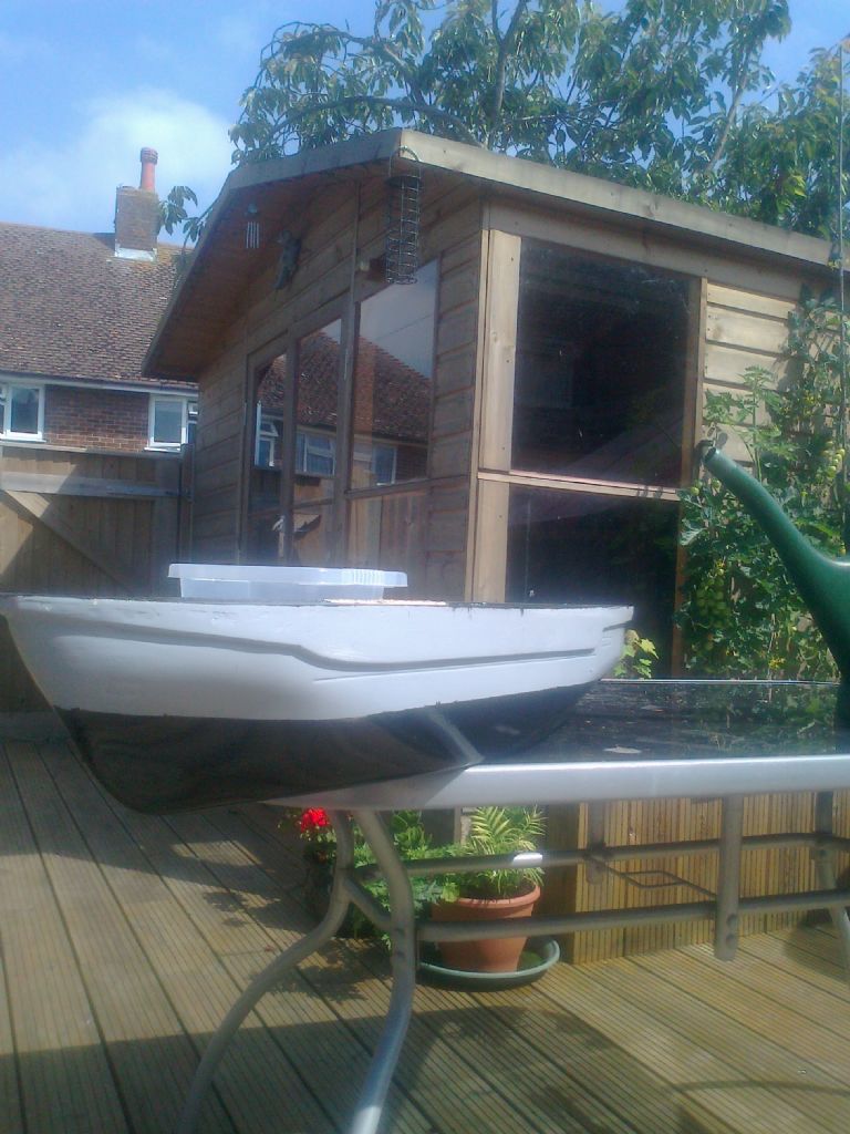

                          The picures are a bit confusing but what you have got to dont look to bad ,
                          are you building a glyne guest boat or some other ,?.
                          what are you stuck on ?.
                          have fitted motors and drive shafts is there access to the hull ,?.
                          loads of more info required , are youin touch with any other modelers who can help?..
                          but dont give up yet ………..it looks ok so far …..Larry….

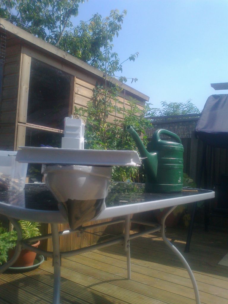

                            Wayne. looks ok so far. This is the sort of thing i am doing at the moment… building a hull to fit under the carrier deck previously made.
                            As last post.. info reqd, especially.. have you bath tested it yet??
                            I have bath tested mine to get it to float upright but have not yet tried it out on the pond. I feel that i may need some large bilge keels (fins underwater) to stop it rolling too much.

                              Wayne. No problems. Counterweighting the ballast to compensate for the deck superstructure works fine. Deck held on top purely by the lip around the edge of the deck ..as yours is more rectangular, the deck could be laid upside down and the hull upside down on top of this and then a few brackets or thin strips applied to locate the deck on the hull when its the right way up.
                              I did think that perhaps a hook underneath the deck and one on the inside of the hull, connected by a rubber band might be security in case the wind lifts the top off but I recon its too heavy for that.

                                Wayne. I have sailed, albeit very briefly, the carpet carrier on its hull, and can report this idea is a go-er. Works fine, Stability appears to be ok. If this an area you are having problems with, then a short heavy keel under the hull would I am sure provide an answer (and less ballast IN the hull)
                                Ashley . see my album.

                                  the boat is all of the cuff working from my head. motors were in after 2 atempt with 2 differant props tried i CV joint and also 2 in line and to my best true and strieght but the noise is out of this world.
                                  there is access to the hull but I feel now may be it needs more as accessing motors ect to work on is poor.

                                    On mine, as per picture, the entire top of the hull is open. No access problems there, The awful noise may be resonance of the hull/top. Might be cured by a bit of bracing, or tie-downs for the loose top.
                                    Another ruse is to turn the motor and drive over using just a single battery, at low speed, to see if anything is wobbling. Is there excessive play in the shaft bearings?
                                    I have had this horrible buzz on the two last small boats I have built, and the vibration was due to the prop… a change and they were all ok.
