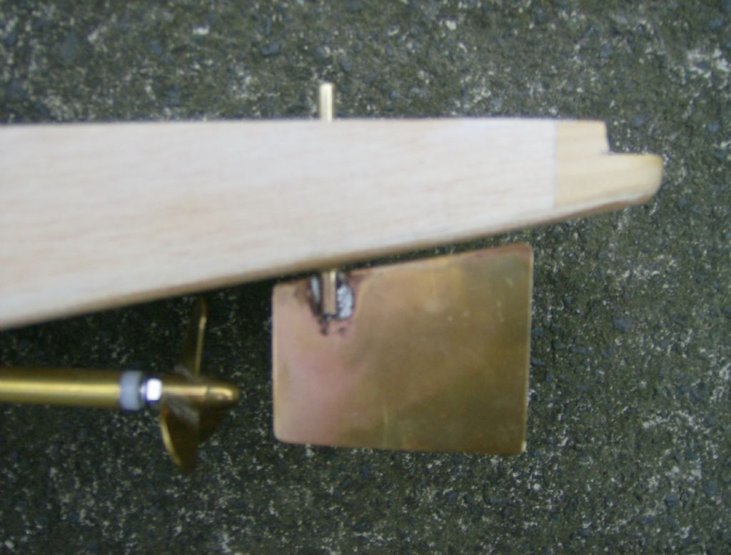

          So. In the flesh.The top is held down with a set screw either side of the sail. The rudder post is very short, so unlike Hal`s version whereby he used an external brace, I have put an additional bush in the removable top, thus supporting the rudder top and bottom. Hal couldnt use this method as his top was very thin. The motor mount currently has a 540/1 MFA in it, but has an insert available to hold a 385, no mods neccessary. This will give me loads of options for power I may just be able to fit a 45mm prop and then a 555 motor for that authentic slow running submarine prop set-up.?There are very few vent holes in the top, because the projected waterline will be just above the top/bottom split, and so there will be no air to vent. I have yet to decide on the diving plane layout and position, and they have to be able to be adjusted and then fixed into position,but I have an idea for that. Both front and rear planes will be adjustable. I have room for a gel 4.5Ahr 6v battery, so will use that to start with and I  will need the weight in any case.  Hal used remarkably little in the way of ballast, but mine has a lot more balsa in it and is of course that much bigger. It is also proportionally fatter than Hal`s, being modelled on something specific, rather than just being generic.    Paint today I think!   Its going to be Black, when finished,matt if I can get a decent finish, or satin . On the other hand I may like the look of it in its very dark Grey primer. never can tell.  Ashhley
          #22108
            A nice little model, Ashley
            I like the engineering solution for the rudder too

                      Bob. It is 36 inches long  and 4 inches wide, the sail is 2 1/2 inches high, the curved top is made out of 1/2 balsa, as is the rib. The rib is 1.2 inches wide. Sides 3mm lite-ply. I have a 40mm prop on it at the mo, and a 540/1 MFA motor. It will have a 6v 4.5Ahr  battery. Dive planes and rudder are thin brass sheet soldered to 4mm brass posts. Control to the rudder is via an aircraft style sheathed wire. weight.. I will get back to you on that once ballasted.Ashley
