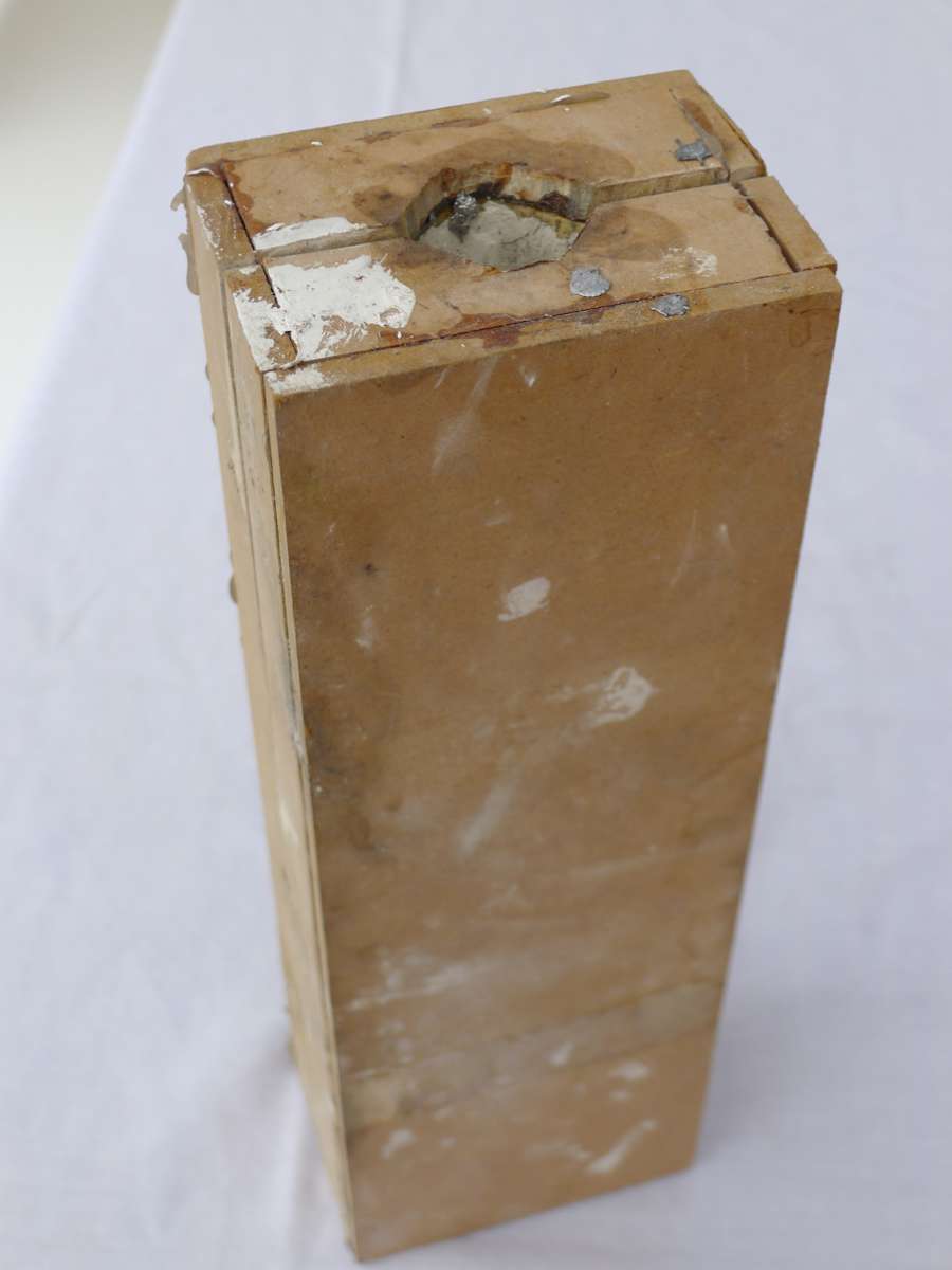

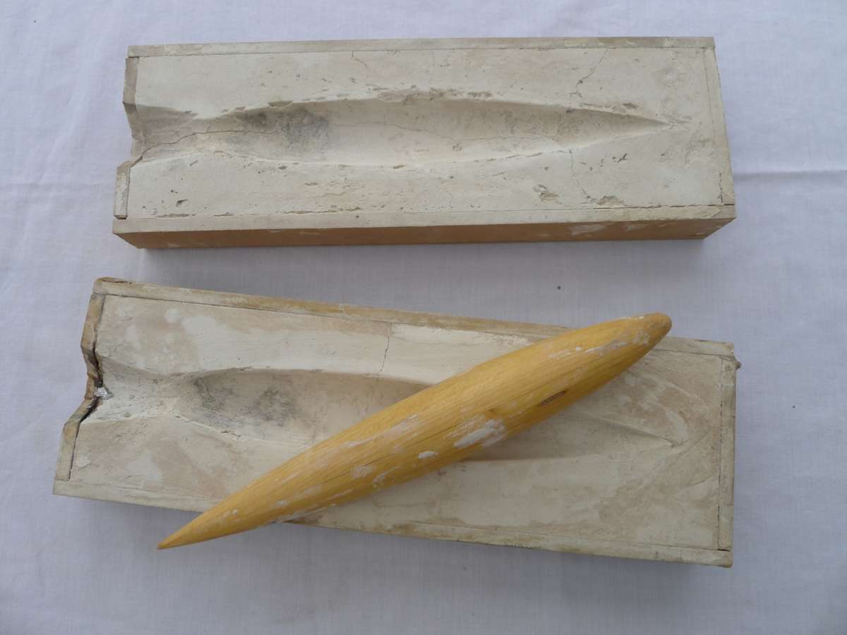

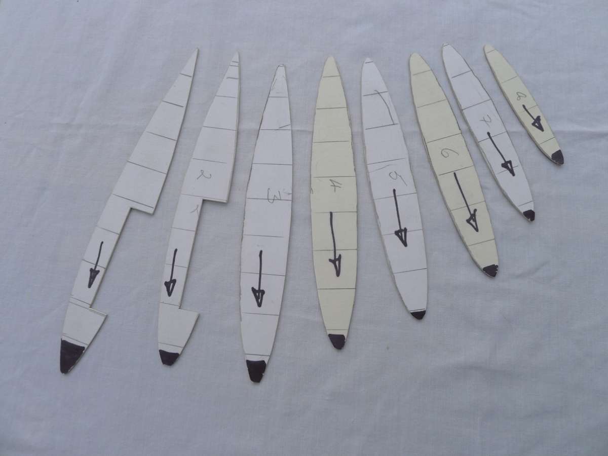

        Tim, Just a couple of shots you might find interesting.  This yacht was built by a chap who is very sadly no longer with us but he made some beautiful models.  This hull is mahogany planked with planks that were also home made from a solid chunk of mahogany.
        The fin and bulb were also home made, he cast the bulb himself from a plaster mould made from a wooden plug, which was generated from a set of cardboard slices.  The fin is tapered at the top and simply sits in a matching socket in the model, held in place by a single screw.  If you need further detail pictures of any part of the bulb and fin let me know.
        22-07-13-02LeadKeelSlices2
        22-07-13-07LeadKeelPatternPlan2
        22-07-13-04LeadKeelPatternMold2
        22-07-13-05LeadKeelMold1
        22-07-13-08FittedYachtKeel1
        29-11-06-13WiltonParkBermudaAnnette4

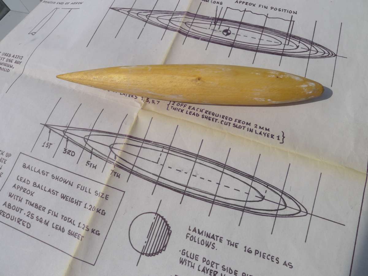

          Thanks for the photos Richard.  You posted them before and they were my inspiration for this build.
          I have made keels for Galileo,  Wild Duck and Eventide but the IOM needs one that is really long and skinny for best performance.  Unless they are hardened with Antimony they bend to easily so I am tempted to buy one from SailsEtc.
          Their bulb is £70 but their carbon fin is around £240!! so I will probably make the fin (in carbon) and I have an idea for that.  The rudder is not too critical.
          P1010140
          P1010200
          P1020303
          P1020315
          This was Galileo’s keel arrangement and pattern for the bulb but is it not heavy enough for the IOM.

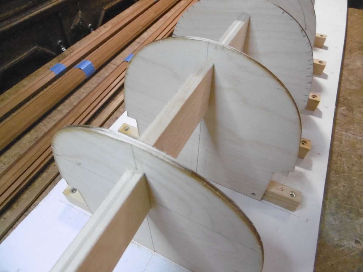

                    @timrowe83142
                    Thank you Chris
                    P1020587

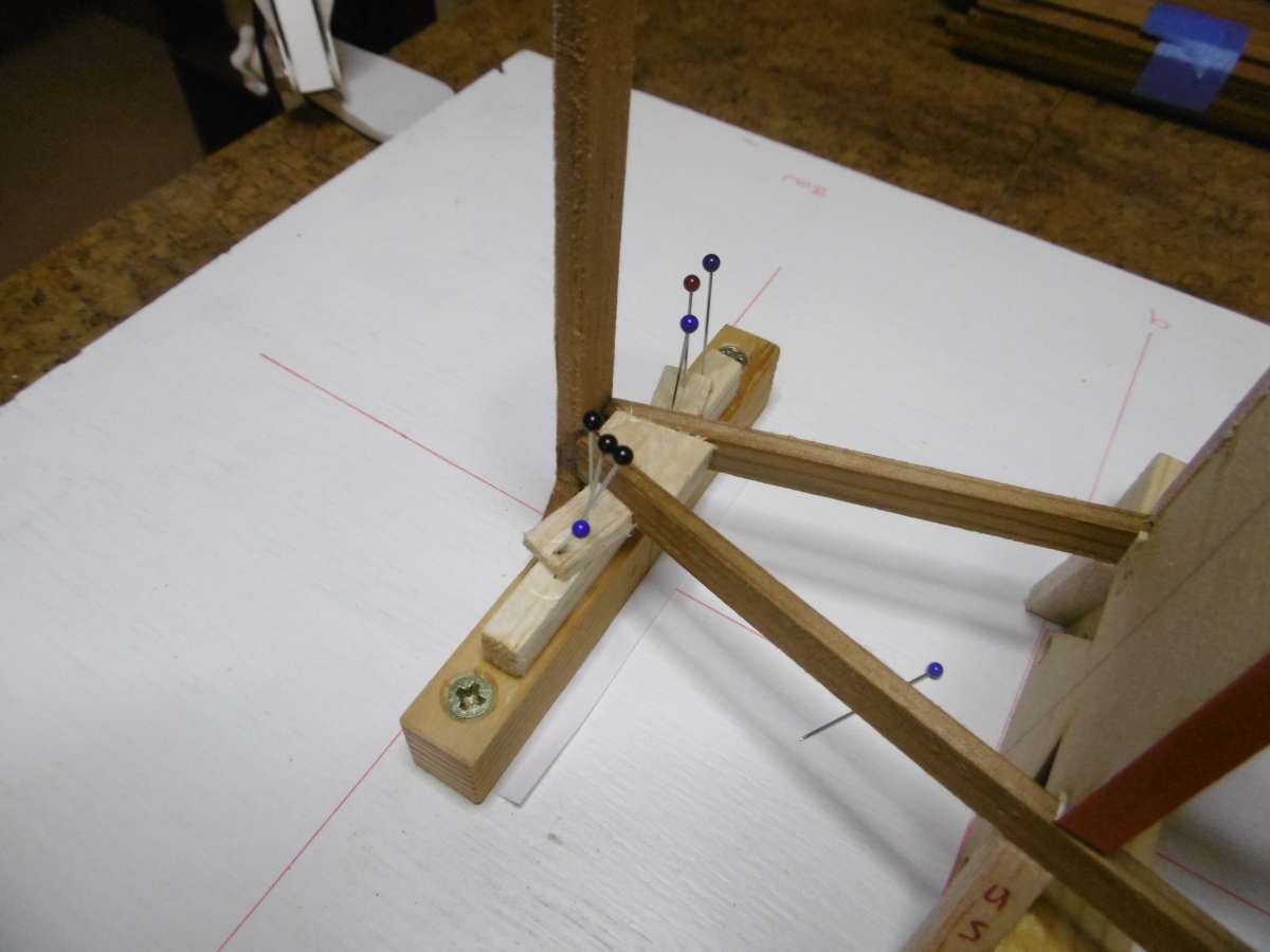

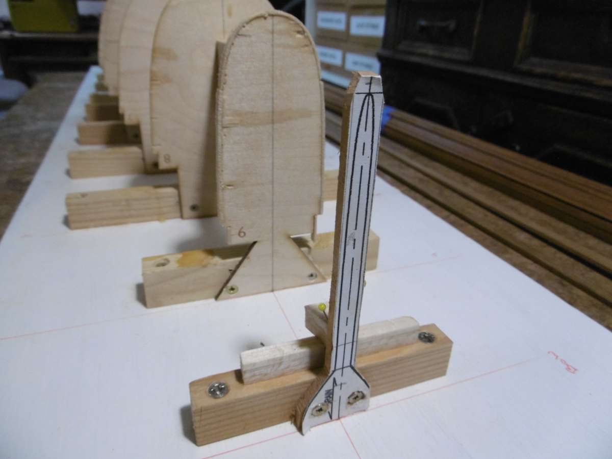

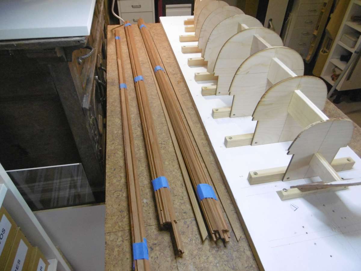

                    Here are the shadows set out on the building board.  In full size we would call them moulds.
                    They are only 4mm thick so actually quite flimsy.  If they were to move out of position at any moment, the true hull form would be lost and the boat would be out of fair.  If they twisted, the boat would be a different shape from one side to the other.  This is the reason I have fitted plywood spacers which are accurately cut to conform to the spacing.  The shadows are now very stiff and the spacers ensure that all of them are exactly 90 degrees to the base board.
                    P1020588

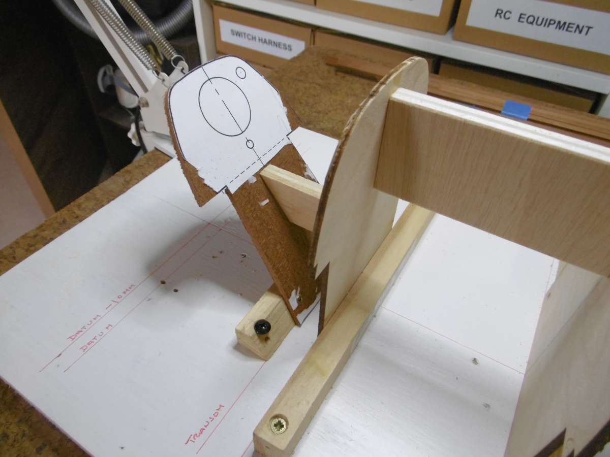

                    There is no shadow at the bow and the piece in the picture is the actual stem.  It is mahogany and comes from a drawer from an old dressing table mirror that used to belong to my grand parents.  Beautifully aged and seasoned!
                    This is the first modification I did by making the stem a fraction wider and a fraction deeper.  The stem has been made deeper and with a flat at the bottom instead of coming to a point.  It is impossible to plank on a point that acute!
                    The reason I want to make the stem deeper was to get it down on the waterline.  The plan shows the waterline a bit back from the stem and so some of the waterline length was lost.  Maximum theoretical speed is related to the waterline length and the more the better.
                    The other reason is that IOMs tend to submarine when going downwind in a blow so lowering the stem meant adding some material to shadow 9 and you can see that I have wrapped a thin piece of balsa to make up the difference.
                    The square balsa attached to the base of the stem locate the height of the inwhale where it meets to stem.  The location of the inwhale is therefore jigged and will ensure we arrive at the same height on each side and I don’t have to fiddle around when the inwhale is glued up.

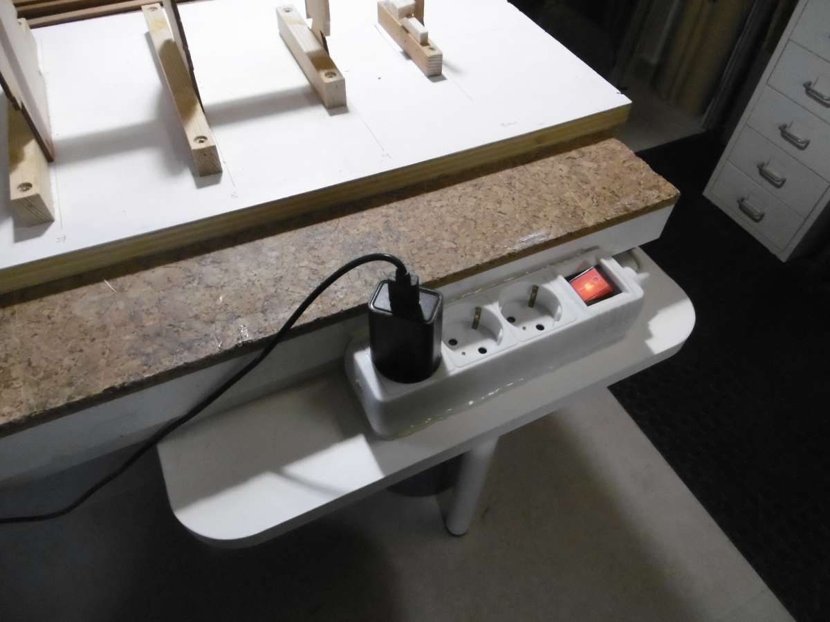

                      I got fed up with having power cables crossing over the work area so I made a shelf to hold a 3 gang socket on a trailing lead. This has made a huge difference.

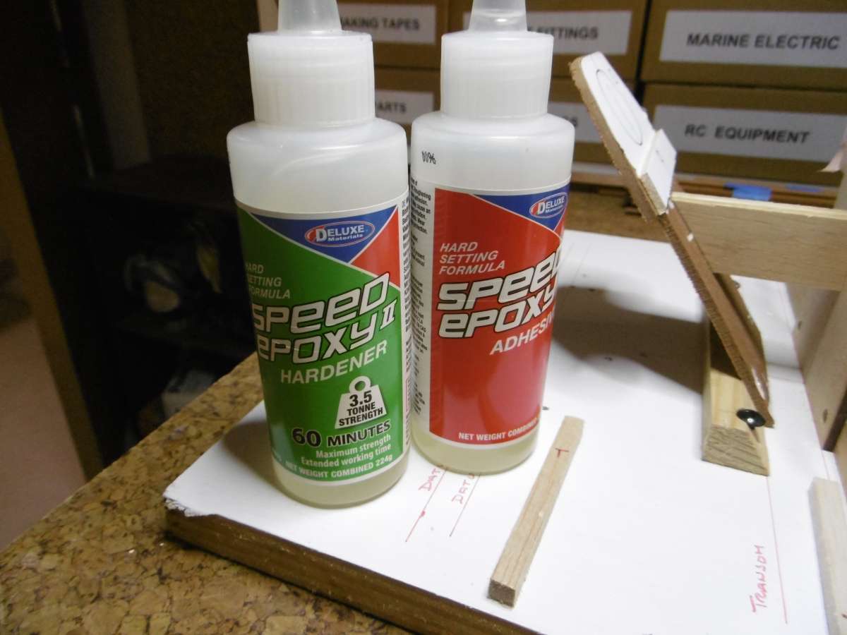

                      This is the glue I am using in the 60 minute and 20 minute varieties.

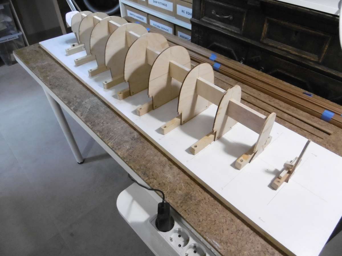

                          @timrowe83142
                          Richard.  That was a good plan!
                          P1020595
                          This was the check that the shadows were perfectly fair using a batten.
                          P1020601
                          The batten was also used to check the bevel on the transom.  This is important because the plank ends will correctly show around the edge of the transom and it would be a shame to have a gap.  A cheat would be to veneer the transom when the planking is finished but that would leave end grain on the topsides which would be a bit ugly.  Not important at all if the hull was going to be painted.
                          It is not quite so critical at the bow because eventually there will be a silicone bumper but it is still good to get a correct bevel to increase the gluing area.
                          P1020605

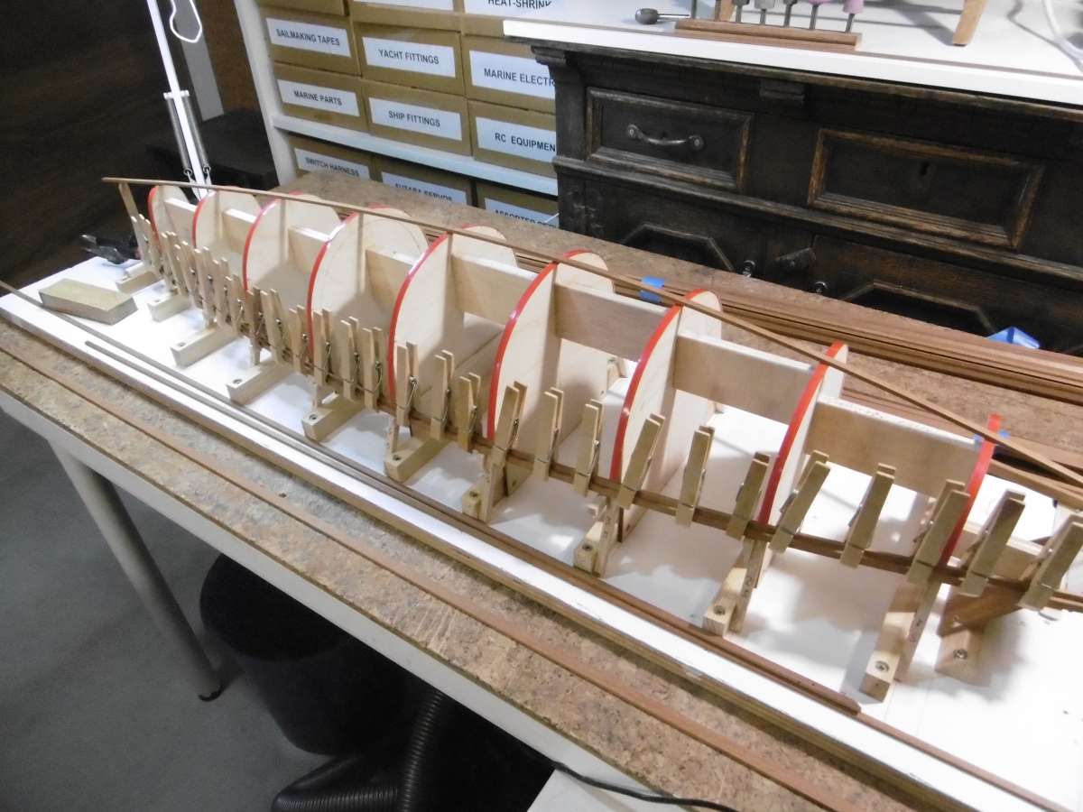

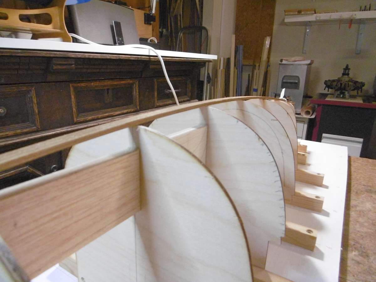

                          The inwhale is now glued in place but only attached to the stem and the transom.  The inwhale dos not overlap either so I made a balsa jig to locate the outside edge of the inwhale with the edge of the stem.  This means  that when I apply the glue I know the pieces will go into a predetermined position.
                          P1020606
                          Narrow PVC tape has been used to prevent the planks from sticking to the shadows, otherwise they would become bulkheads!
                          I used a series of shores to wedge the inwhale into the correct position in the notches of the shadows. The cross pieces made from scrap balsa are to act like jigs so that when I apply the first plank it will register at the same height as the top of the inwhale.  Again, takes the panic away when the epoxy is mixed.  It is quite warm in my workshop and the twenty minute of  the 20 Minute Epoxy goes like a flash.
                          This stage brings the boat ready to start planking.
                          To follow
                          Tim R

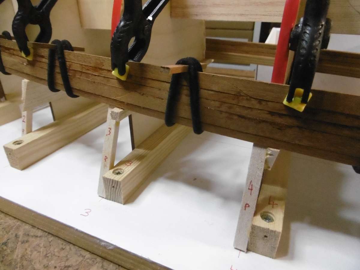

                                  @timrowe83142

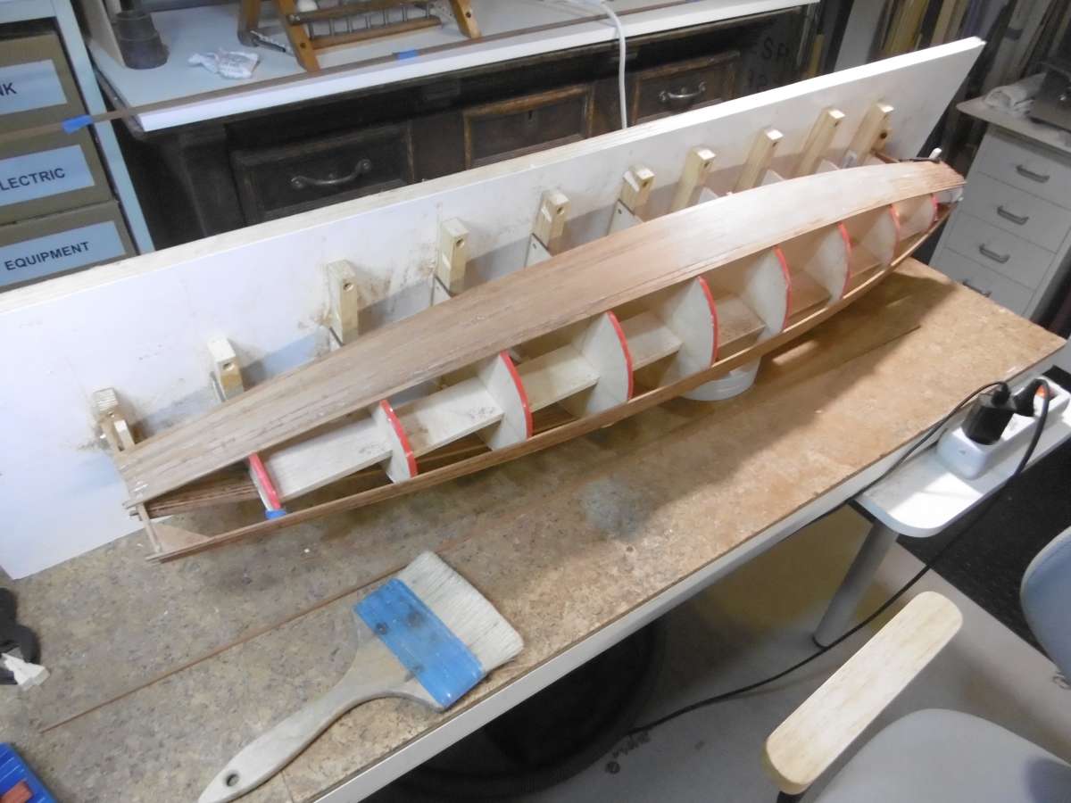

                                  The hull form is starting to take shape
                                  P1020612
                                  Various clamps and hair accessories in combination to hold the planks in place while the epoxy sets.
                                  P1020621
                                  The first few planks are parallel and follow the line of the sheer.  After this, every single plank will be shaped and I will explain why.

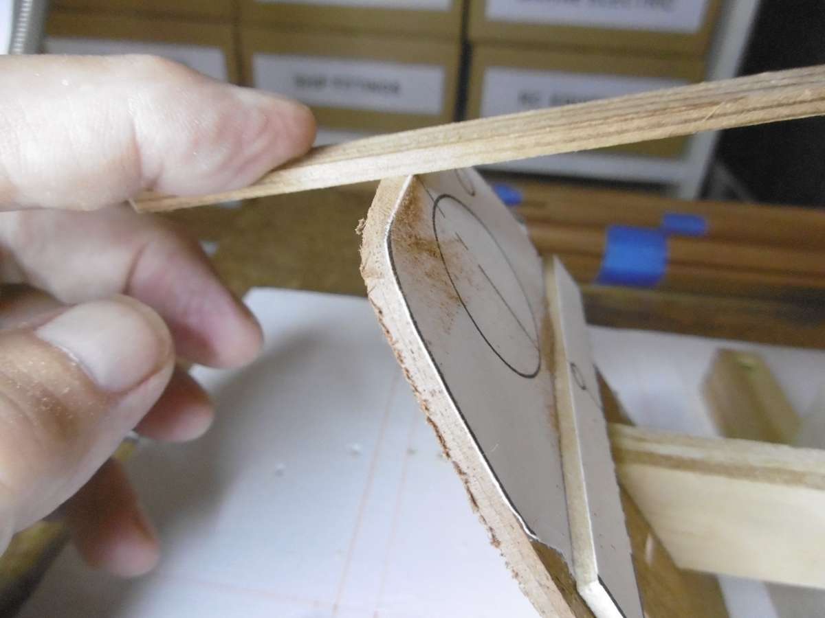

                                    Nimble’s hull will be varnished mahogany, for the topsides at least.  This means that filler of any kind is out of the question and every plank has to fit against its neighbour without gaps.  This is quite easy for the first few planks of the topsides but gets increasingly difficult when starting to plank curves and especially difficult when getting to tight curves and concave shapes.  Fortunately on all the IOM’s that I know of, there are no concave areas.
                                    The other consideration is that as the beam increases towards midships, the girth increases which means that you don’t need as much material to get from the keel to the deck edge at the bow and the stern.
                                    There are two features necessary when planking a curved surface of a hull;
                                    1.   The edges of the planks need to be bevelled
                                    2    The individual planks need to be tapered.
                                    In the first instance the tighter the curve the bevel angle needs to be larger.  In modelling situations when the curve is gentle you can get away with bevelling one edge of the plank only.  When the curve get tighter you will need to bevel both edges. If the curved is really tight you may have to hollow out the inside of the plank (or use narrower planks which has some disadvantages).
                                    If you imagine two planks with square edges, side by side on a convex surface there will be a gap on the outside.  This will either be an ugly, wide glue joint or it will require filling.  Even worse on a concave surface because the planks will touch on the outside and you will have a gap on the inside.  When you start sanding to fair everything up, the gap will get wider!  The other advantage of having the correct bevel is that you have continuous contact along the glue line that makes a much stronger joint.   In a perfect joint, the seam will be normal ie 90 degrees to the surface which in most cases will be a frame.
                                    In the second instance tapering every plank helps get around the difficulty of the differences in girth.  Often this is not 100% possible in which case plank inserts need to be fitted called stealers.  It is aways good to keep the number of stealer required to a minimum and to take a full sized fishing boat which are quite tubby, there may only be two stealers each side, normally at the stern.  In a model and where using fairly narrow planks you only need to put the taper on one edge.  If you use parallel planks, after a while you cannot bend the edge of the plank sufficiently to meet its neighbour and it will run off leaving a gap that has to be filled later.
                                    I  think Richard and Colin will appreciate this next description.  If you imagine the vessel as a globe, each plank should try to follow the Great Circle Route as closely as possible and you do this by tapering.
                                    Where there is a greater change of section, the steeper the taper needs to be.

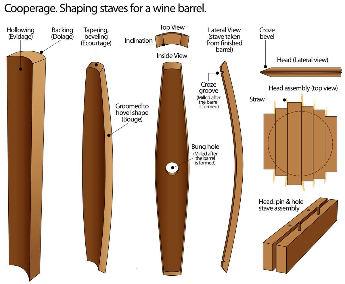

                                    The easiest way to visualise all this is to look at how a barrel is made.
                                    Process-of-shaping-staves-for-an-oak-wine-barrel-toneleria-nacional-chile
                                    The taper creates the barrel shape  because the top and bottom of a barrel are quite straight, the taper in these sections is also straight.  In the middle section where the barrel curves, so too does the taper.
                                    The bevelled edged mean that there are no gaps which is obviously critical or there would be a grave shortage of whisky and wine!  When you look directly from the top to the bottom the seams will appear straight.  This is because they are following the Great Circle Route.
                                    In reality Cooper have an easy job because each stave is the same.  On a boat there are no planks that are the same. not even between port and starboard because they are mirrored.
                                    This is the theory so I will try to show how I deal with these things in practice as I go along with the build.

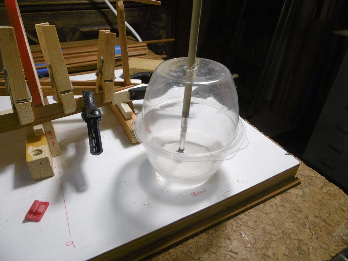

                                          I use a cheap brush to apply the epoxy along the edge of the plank.  Each mix is only around 0.80 grams so an accurate scale is required.
                                          P1020618
                                          Here is my tip for keeping the brush usable in between mixes.  Two Greek yoghurt pots with cross-cut slits in the top one.  This grips the brush suspended in alcohol and the top slides down to stop the alcohol from evaporating.  Works a treat.

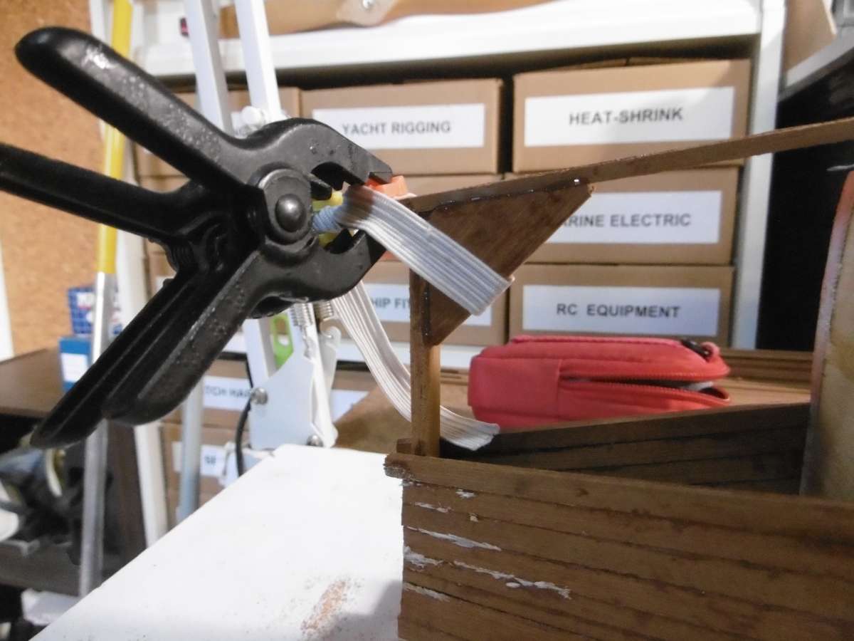

                                              @timrowe83142

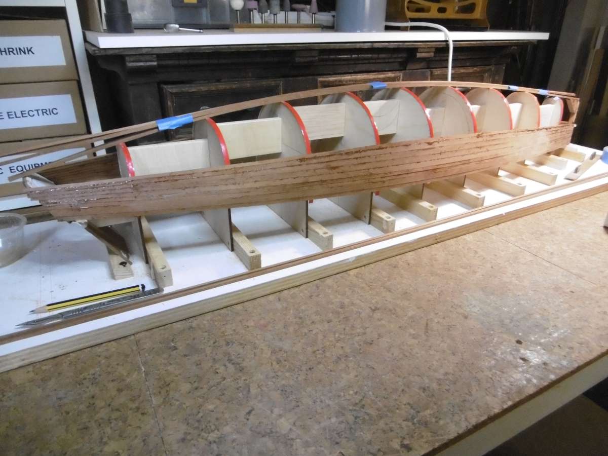

                                              About 50% of the planking done now and just reached the tricky bit where the curve is very tight at the transom.  In this area the rate of change is very large so another element of the plank geometry has to be introduced which is twist. I am hoping to get away without having to resort to steaming the planks and just use gentle persuasion.  The planks here have so much taper that they are thicker than they are wide.
                                              Another tricky bit at the bottom of the stem where the is almost a chine.

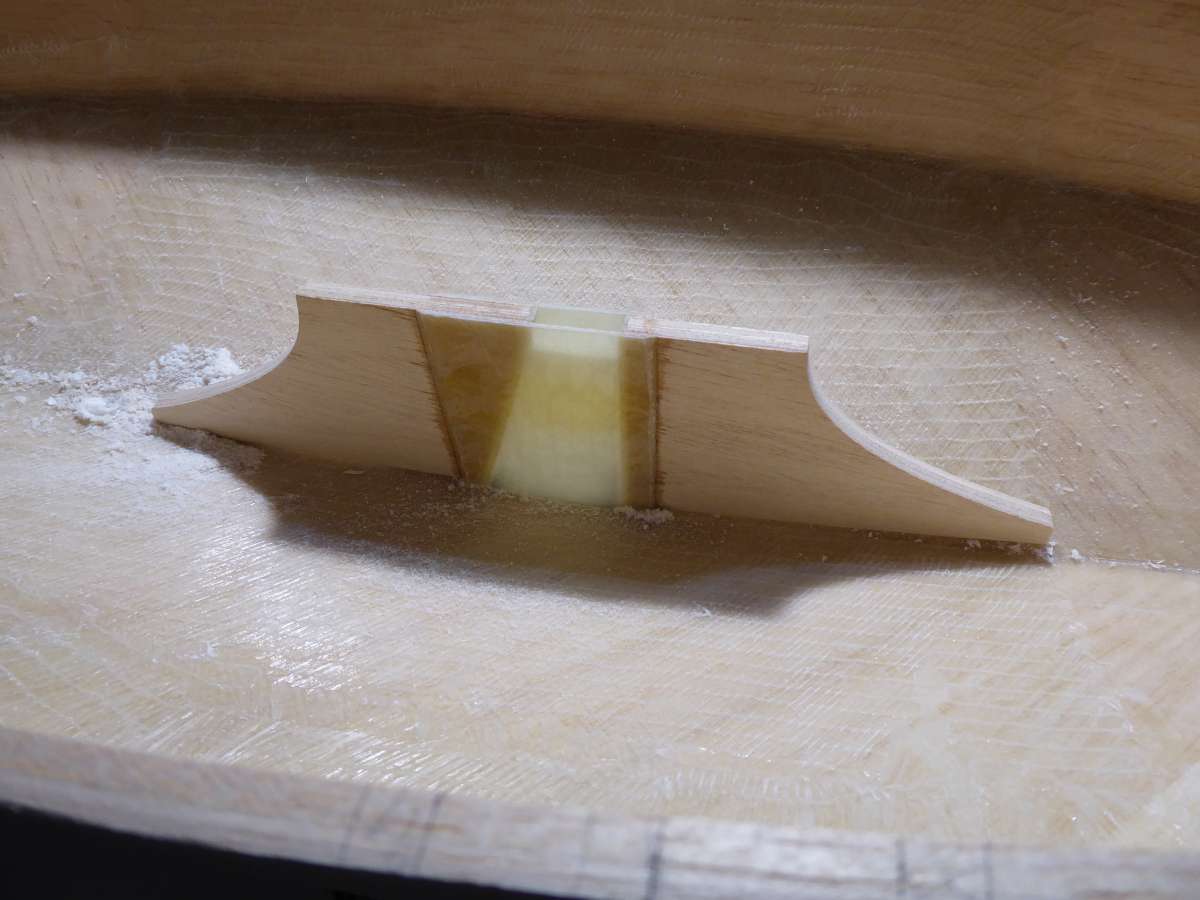

                                              P1020637
                                              Here I have introduced a knee which is not on the plan and not necessary for strength.  I will have to do some fairly aggressive sanding here so if I do go through (or nearly through the planking) I will have this as a mahogany backing piece.  It also give me a bit more gluing area at this high twist zone.
                                              Can’t wait to get the planking done but it cannot be rushed however tempting.

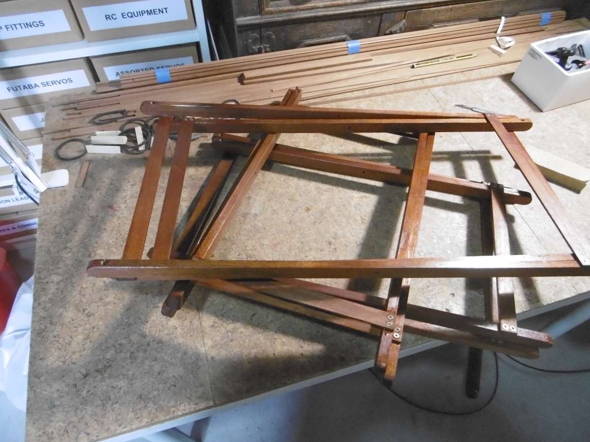

                                                @timrowe83142

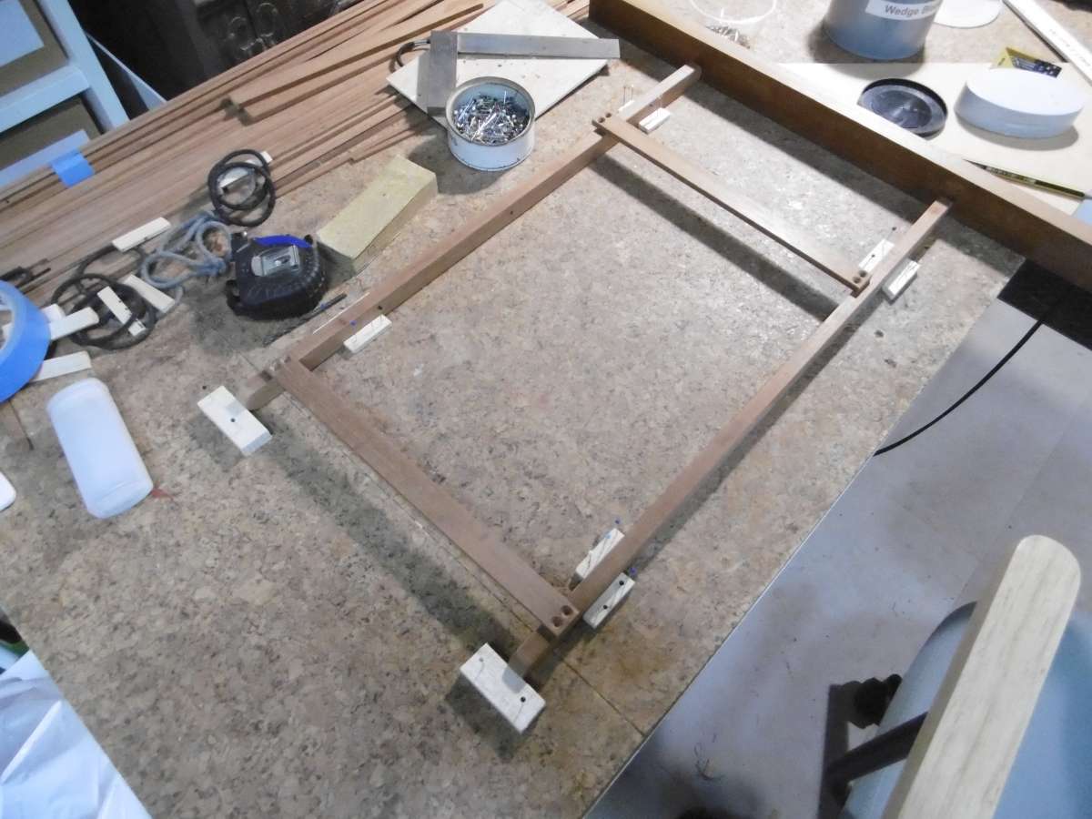

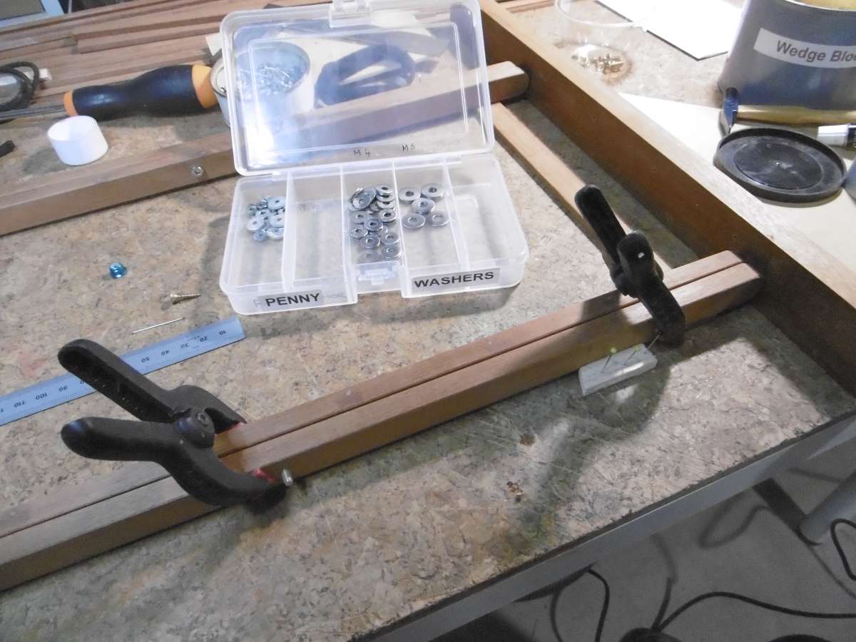

                                                Just to show that I haven’t been completely idle
                                                P1020627

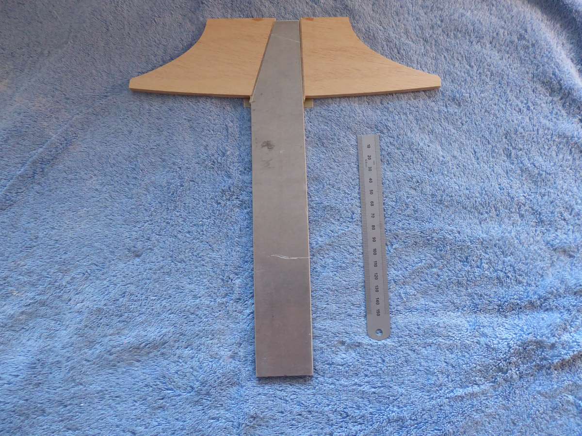

                                                I was short for folding stands for use down by the harbour so with the remaining mahogany I have made up three simple scissor stands.
                                                P1020629
                                                P1020630
                                                For the webbing I used dog leads.  We have six leads but only two small dogs.  They are not too wide which was perfect for the frames.

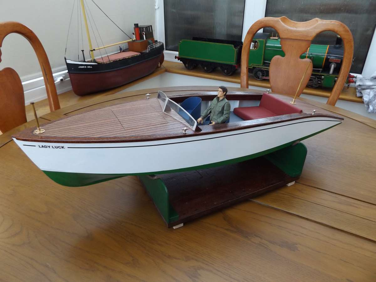

                                                  Hi Tim,
                                                  I didn’t know you had two dogs has Aubrey got company now ?
                                                  I have been asked by our editor to finish off the Lady Luck design and article for the first week in January so I’m at Action Stations 🙂 well I didn’t want to be bored over the Christmas break anyway !!
                                                  I made some flags this morning for the launch, just need a good day for the on the water photo’s
                                                  Nice stands btw
                                                  Best   RayDSCF3054

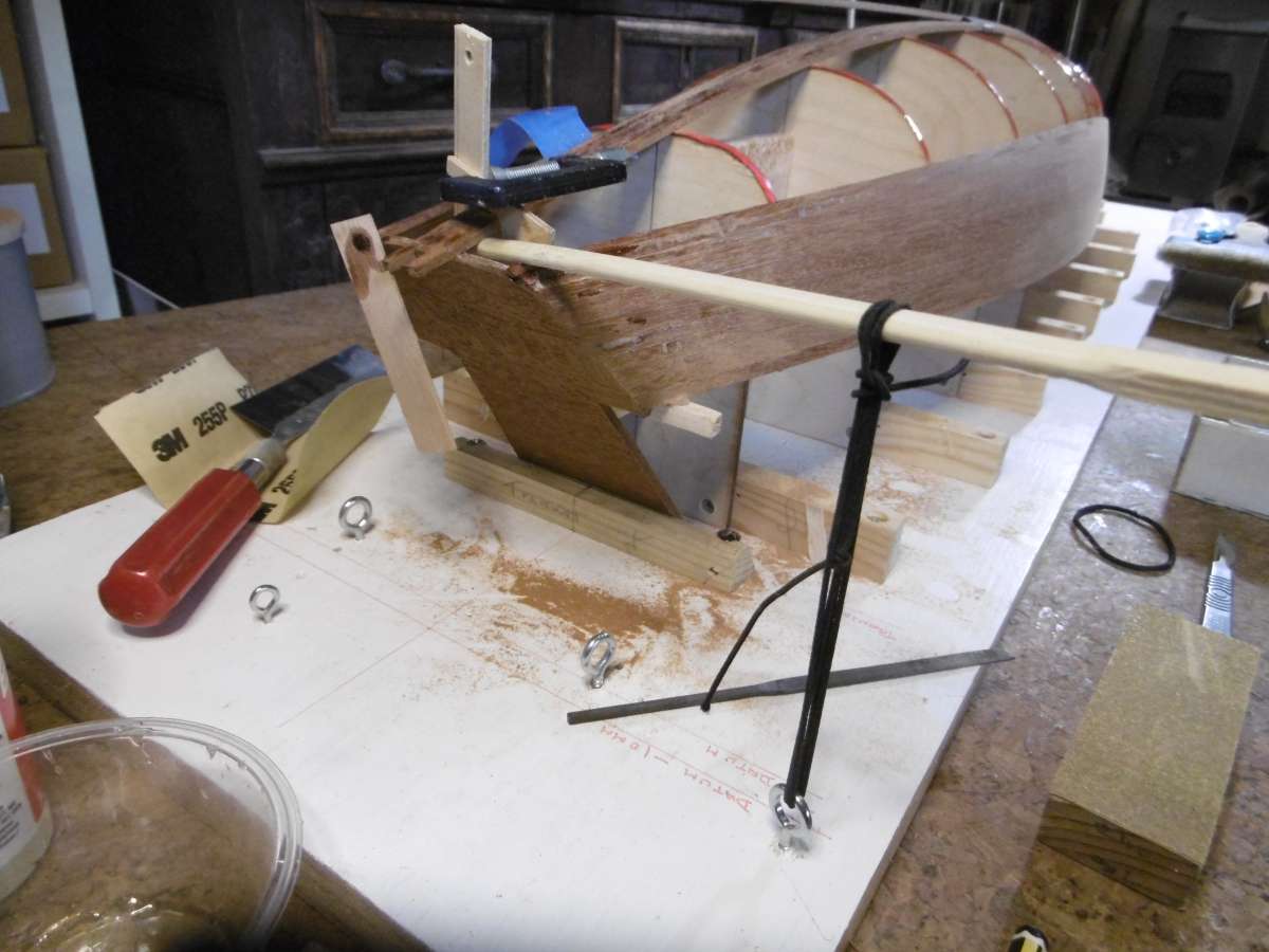

                                                    Planking coming on slowly with Nimble.

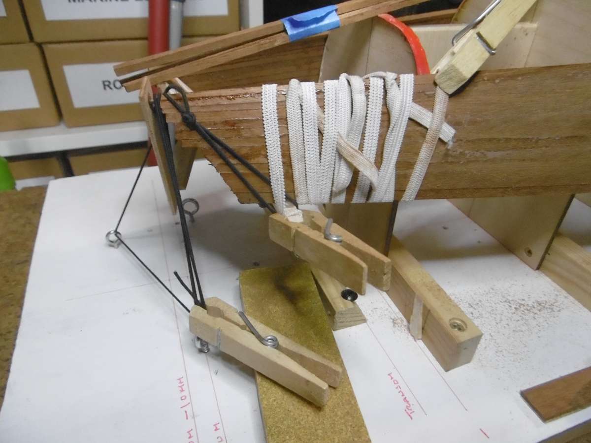

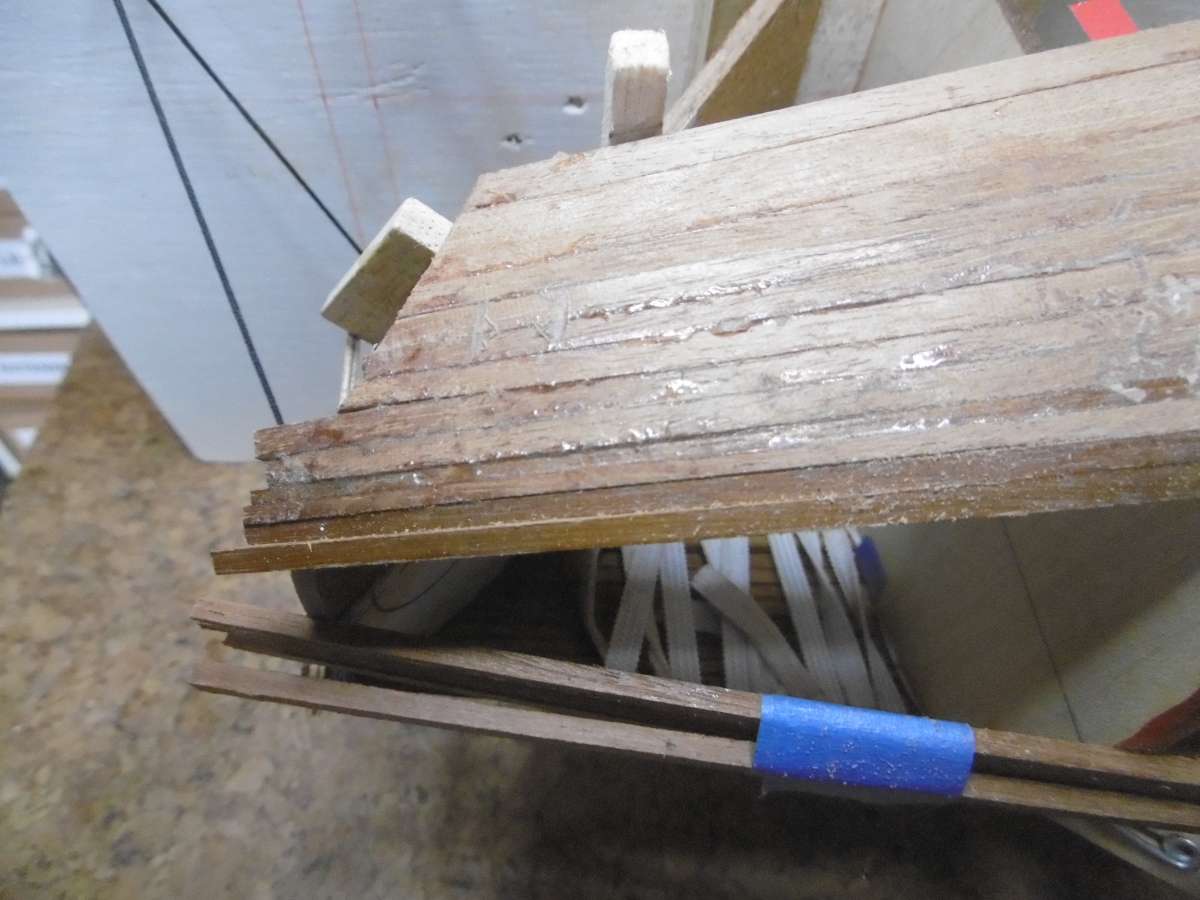

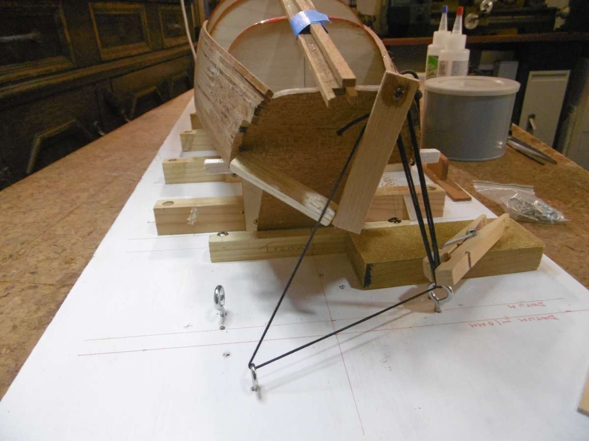

                                                    The transom has a very tight bend where it transitions from nearly vertical to horizontal.  It is one thing to tape the planks to get around the curve but there is also a very fierce twist.  In Balsa or Bass this would be a doddle but getting the twist into the mahogany is a real exercise in improvisation!
                                                    P1020645
                                                    The end of each plank is left a bit long and a piece of scrap plywood drilled and epoxied just clear of the transom.  This can then work like a spanner to keep the twist in place while the epoxy sets in the seam and the edge of the transom.  The “spanner” was wedged in place with a scrap piece of balsa and and all held in place with some elastic.
                                                    The plank on the left is waiting for the treatment and has been glued up to the last frame.  This gives me something to twist against because doing the plank all in one go would be next to impossible.  To get the glue right up close to the last frame, I applied epoxy to both sides of a strip of paper and slid this up as far as it would go.

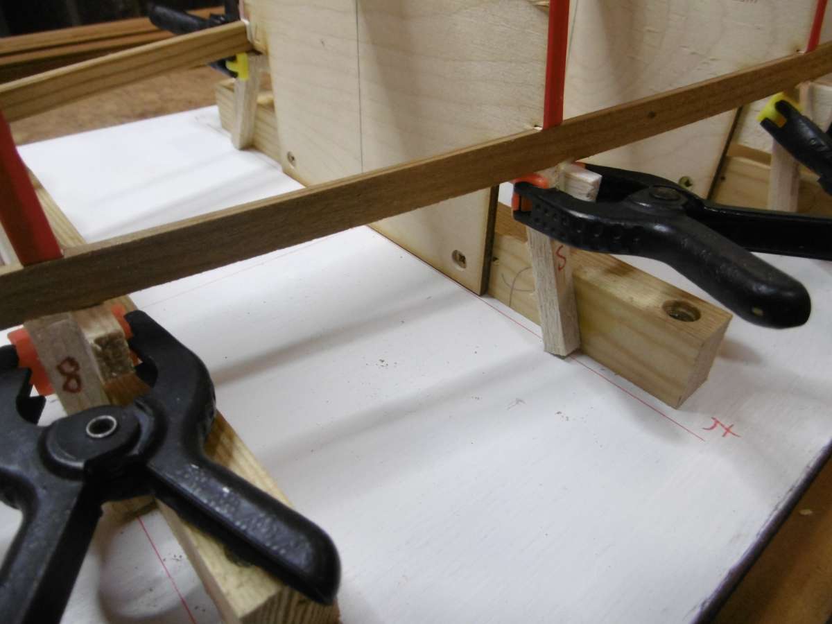

                                                    P1020649
                                                    Some more brute force to keep the joint nice and tight.
                                                    P1020646
                                                    Plenty of elastic gives a good clamping force and doesn’t bruise the edges of the planks.
                                                    P1020647
                                                    Here you can see the very narrow planks.  All will be revealed when the sanding is started and only then will I know if I have managed to keep the seams tight.  Fingers crossed.
